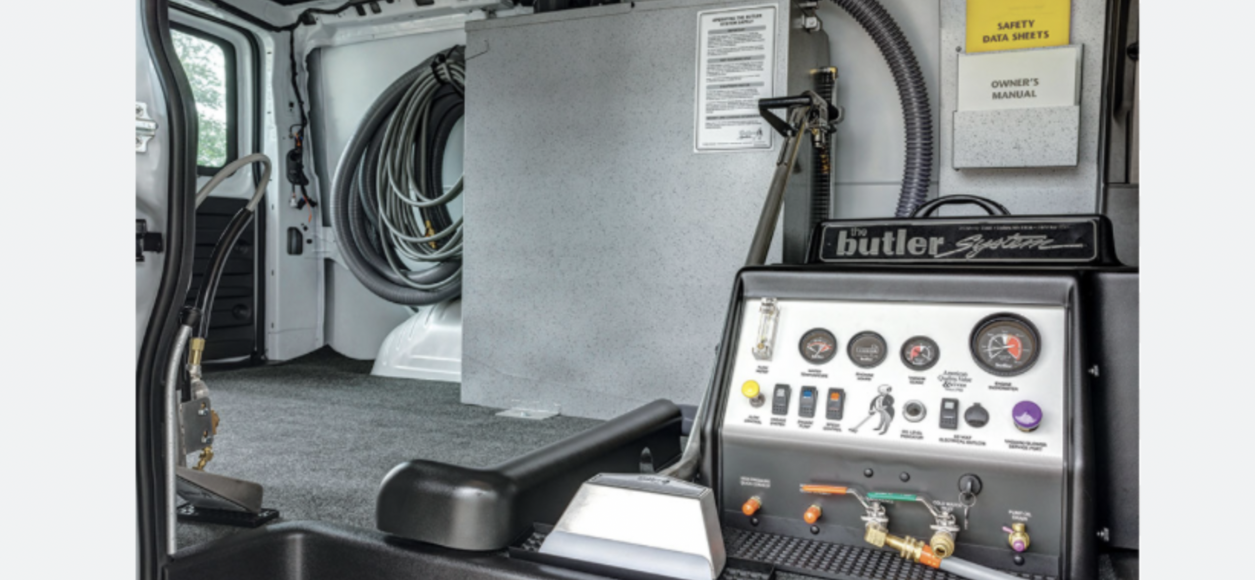

I'm saying, if he has the budget, rather than a slide in, a Butler would be the way to go. Simple, reliable, hot and powerful. Butler does some modifications to make the van run cooler. New system can run $80,000-$100,000 depending on options, including the van. At times, Butler has some reconditioned units available.Butler isn't a slide in doah...you know that already

I’m seriously considering the Butler system would love to hear from any of you guys about it I know it’s more of an East Coast thing, but looks really simple to work on. They seem extremely reliable. What’s your thoughts?

I like hearing that.i have a butler and 2 hydramaster cds out everyday
the butler seems way easier to work on and is a great setup
the cds is awesome and I prefer it but my vans have had a lot of issues the last couple years
one of them has 150k miles and 5k hours and was flawless till about a year ago and its hard to keep on the road now it just seems like something is always off or its running hot or leaking
my butler is great only have had a radiator issue and clutch fan but cleans strong everyday
if I were to buy myself a van today I would buy myself the CDS 4.8 SV its blower is bigger now and if its not employee ran I think it would last a lifetime
I dont like how the butler looks or is laid out I dont like how the pressure guage only works while using the wand or tool I also dont like how the injection system works
and I would rather have the center console on the cds
the cds is way more room and looks way better
you can have enough room for all the vlm crap we are pushing these days and whatever else you want
