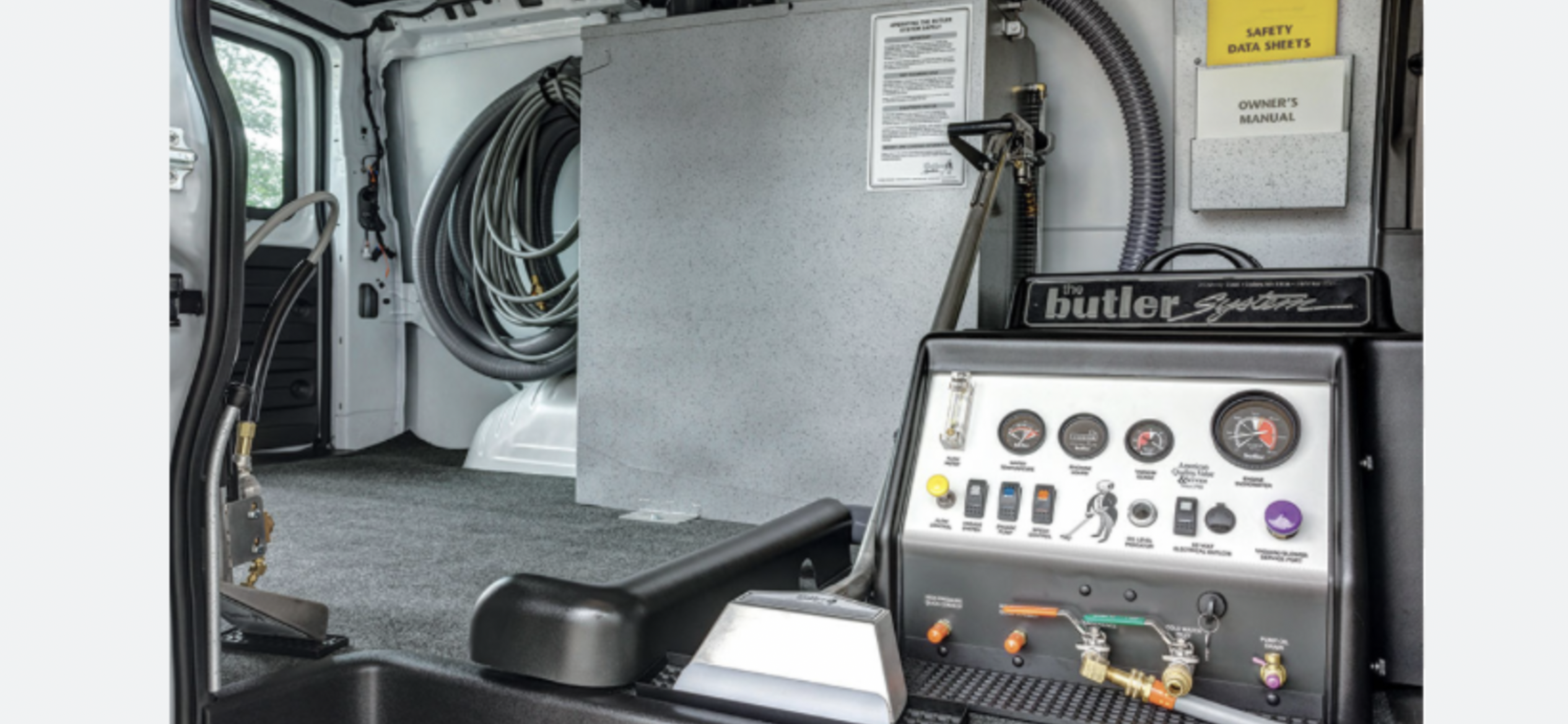

I’m seriously considering the Butler system would love to hear from any of you guys about it I know it’s more of an East Coast thing, but looks really simple to work on. They seem extremely reliable. What’s your thoughts?

It’s not the Butler you have to worry about. The Chevy van is the weak point. In my opinion, the only way I’d get a Butler is by agreeing with myself to always have a payment. I’d get rid of it and buy new every three years. Otherwise, you’ll find your van in a mechanic shop too often.
The most “reliable” units are the ones the other guys own. It’s never yours. It’s the easiest to work on that you actually want. I’d say a Judson or a TCS unit if it wasn’t for their reliance on propane. Propane is a pita.
Consider a El Diablo heat exchange model. See if Pemberton sells them.
Or go with Butler.
Or go with Butler.

What issues do you see with the Chevy? I’m assuming you’re saying due to the PTO setup and the endless idling?

Just had my Chevy in for service at the dealer and it went great. If your concerned about specialty TM service, that is a plus for PTO.
But the space in my Hydramaster CDS 4.8 is a huge advantage I did not see when I purchased in 2016. 10-20 years ago I was double wanding literally everyday during my busy times with my Thermalwave. All I needed was 2 wands and a stair tool and gas.

I think a butler setup wound do just fine in that area. I think it’s areas that are extremely hot where you’ll see problems that Marty was referring to. The vans aren’t made to sit and run 1500rpm with no air flow in 100F+ locations.

Depending on your budget, I would go with a Butler. You don't necessarily need a carpet cleaning service depot near by. Many pressure washing and small engine companies will service slide in truck mounts.

I had a Prochem Apex. Probably my favorite of all the TMs I had. Now I have a Titan 575 and like it almost as much. Not sure why you dont like it.
Anyway my Distributor is 3 hours away. I take the machine to them every year for annual maintenance. Cost me $700 this year. Is it worth $700 to know you wont have any issues with your machine for the next year? Heck, yah! Its called PREVENTATIVE maintenance. I pay up front because I know that if something happens on a job, its downtime and no income until parts come in and repairs are made which costs MORE money (and aggravation).
Do I like driving 3 hours one way, no. But I can count on my machine to run as it should each and every day.
