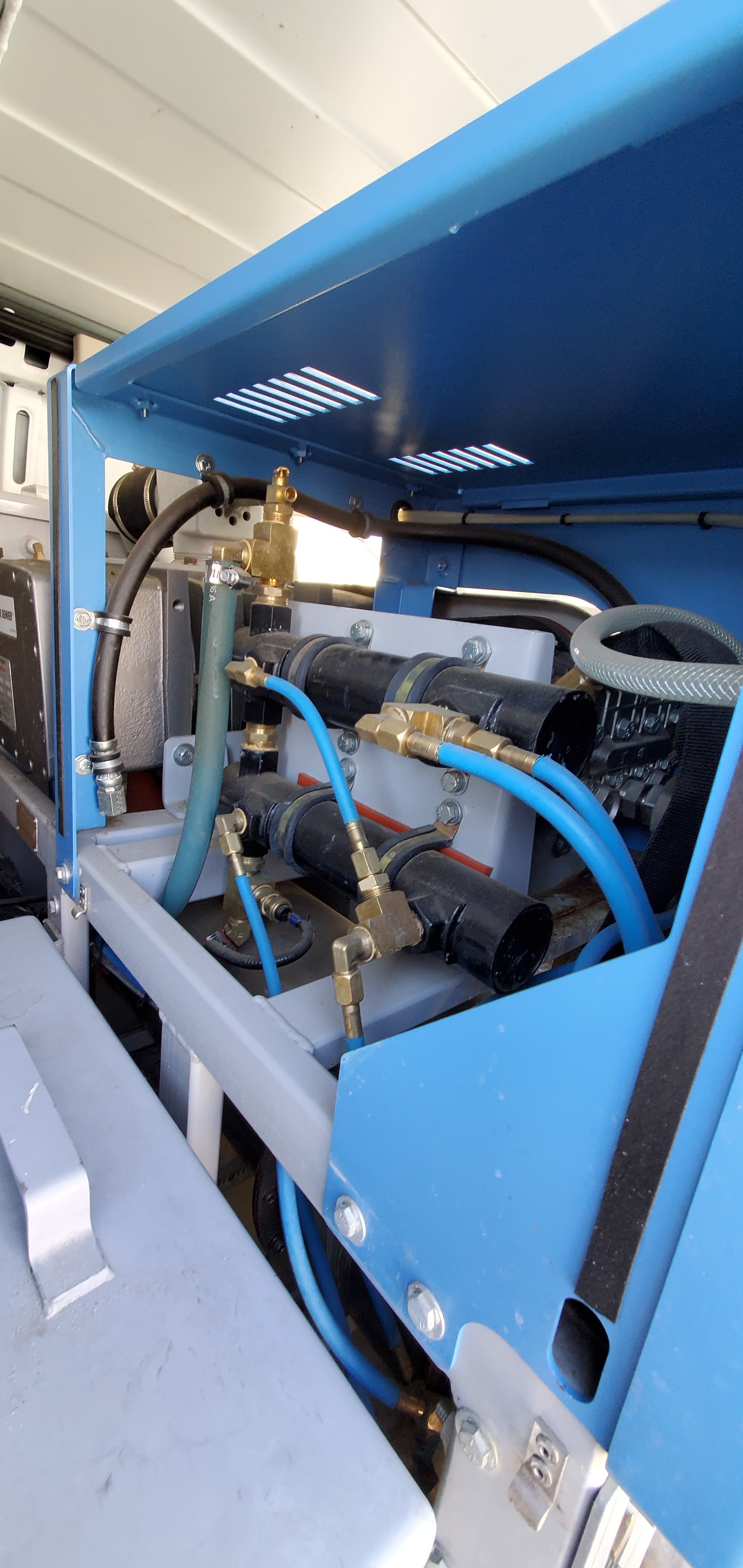

It's running fine, check engine light gone for now.
Have a radiator heat exchanger small leak where the over flow on the van is constantly dripping.
Good thing theres a 3 year warranty I didn't take delivery until march 1 2017 so I am still under warranty.
Got a heater in the van right now supposed to drop down to 23 tonight.
Also got the Doghouse and all the other pieces back into the van.
I'll clean it up when it gets warm.

I was telling Mitch at empire that the radiator reservoir keeps leaking and its constant, he's like it was probably overfilled and it still alleviating extra coolant.
I said so gallons????
He put me through to Tim, hes like yeah small leak in the radiator heat exchanger.
Mitch is a dumb hahahaha.
