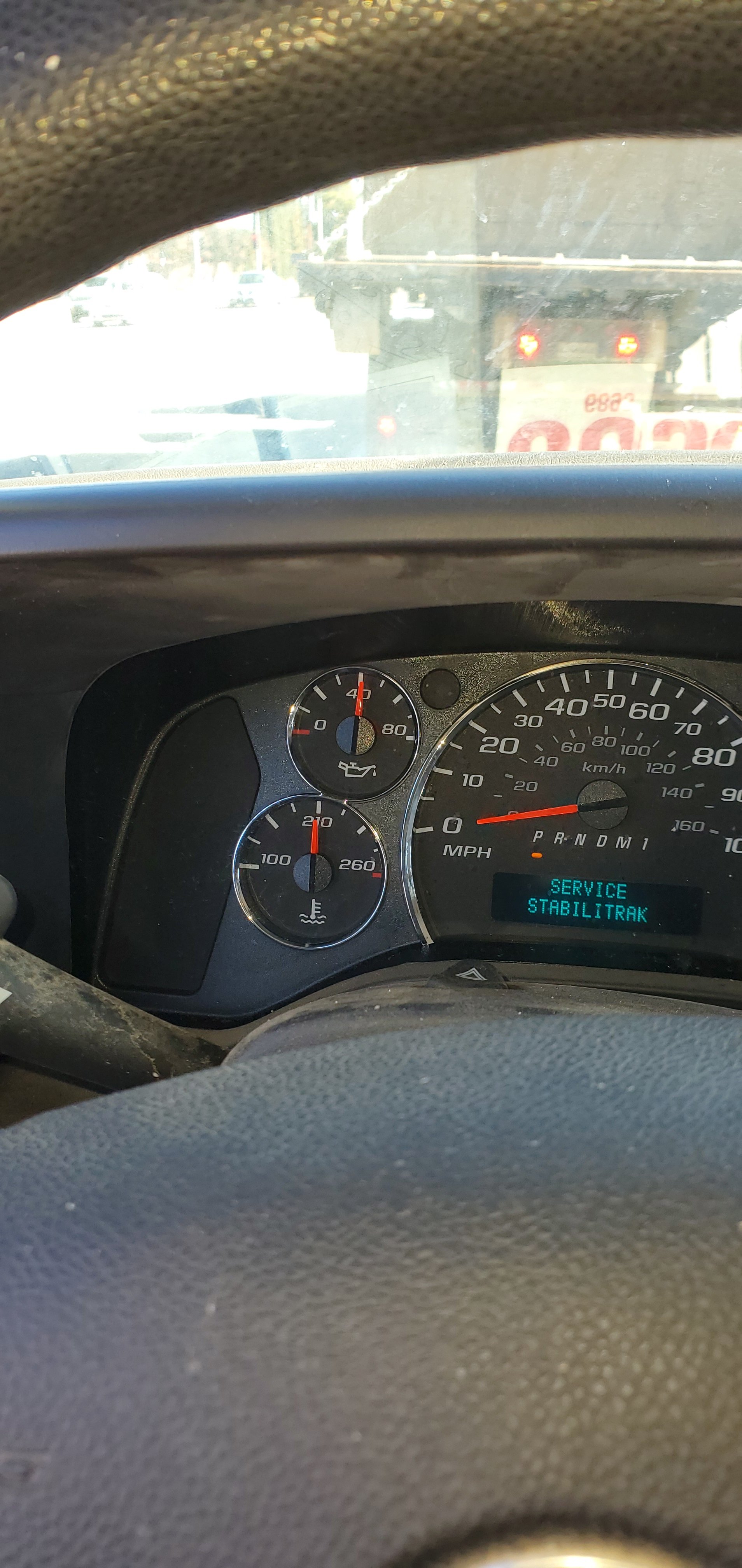

Check engine went in and out I asked them to please look at the catylic converter and make sure its good
11,297
Blowing a fan at the front makes no difference with air flow.
Couldn't feel anything until the van fan kicked on
And only on the passenger side could I feel movement of air.
I could see a higher rpm helping with fan speed but that would create more heat to cool also.
I really hope to get the 5 years out of this van get it paid for and give it away.

Its was bank 1 bank 3 bank 5 bank 7 open injectors.
Today they said it was an injector code.
Like if I use the van after a computer reset it takes 2-3 days for the check engine light to go on and goes into limp mode. Sometime it kicks in faster.
But I let it sit for 3 days and it ran fine when I took it to Hugo's.
Hugo's notice it went it and out of limp mode depending on how hot it was.
He suspected catylic converter possibly.
It's a 2016 chevy Express 4.7 liter engine 42000 miles.
When I Google the engine code its says bad injector or bad wiring or Ecm.
I would think they would look into those three things
