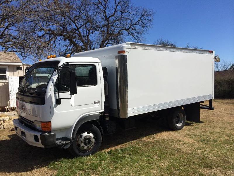

Just got truck 3 back from the painter. Can't wait to get her back up and running. Throwing new tires and wheel simulators on her today as well as insulating and carpeting the walls.

We just use marine grade carpet glued to Masonite, hung .5 inch off the floor. For insulation we are in texas, so we just use .5 inch Owens Corning r40 board that floats behind the hung Masonite with carpet glued to it.

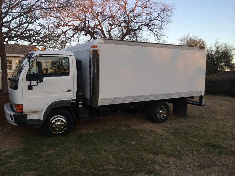

Did take a shot with the new simulators, paint, bottom rails, corner radiuses, and tires. Oh and popped a new windshield in today as it had a star.
I think simulators make a big difference.

Looks good, I gotta get mine like that.
What are the corner radiuses and bottom guards?
Is that the corners where the walls of the exterior box comes together and the bottom of the sides?
Mine are mostly dented, would be nice to know if they can be removed/fixed/purchased new.

Yes they are polished stainless steel and cost about 600-700 each installed. So make sure you don't get ripped off.

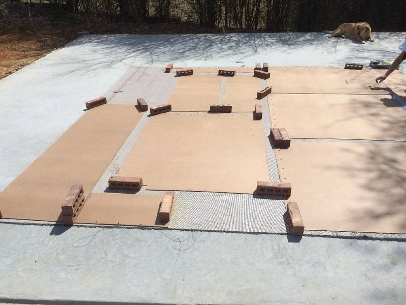

I know it is self explanatory but this is how we lay out the Masonite and glue carpet in a way to minimize waste.

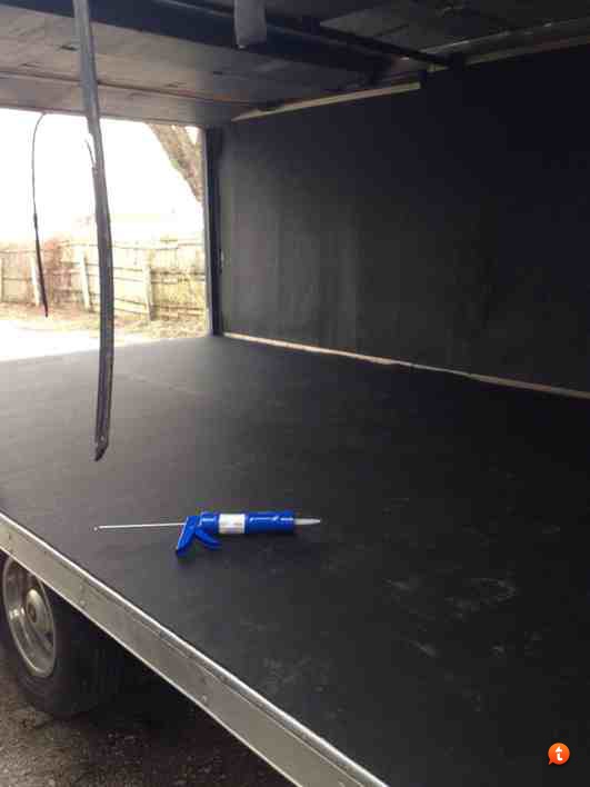

1/4" elephant bark went down today, double sided outdoor tape and black butyl rubber caulking for the seams.

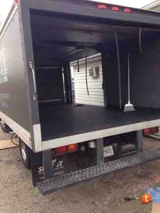

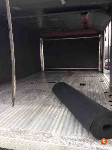

Damn that empty truck gives memories of how we start out gutting each truck when we first buy them and gut them.
It is a project for sure.
