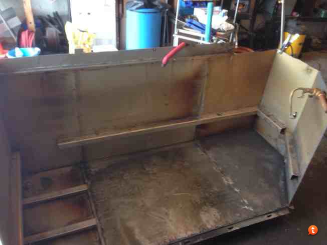

Nate, I did rebuild the the blower pictured, it came out of an 05 A/T with Low hours.
It didn't need a rebuild, but was filthy. So I took it apart, had everything but the gears put in a parts tumbler and put all new bearings, and reset the tolerances.
I ordered a new 6mp from Gardner Denver Louisville, but they said it could take 2 months as they are back ordered...
So I may just stick this in and swap it out for the new one whenever it arrives... or keep the new as backup.

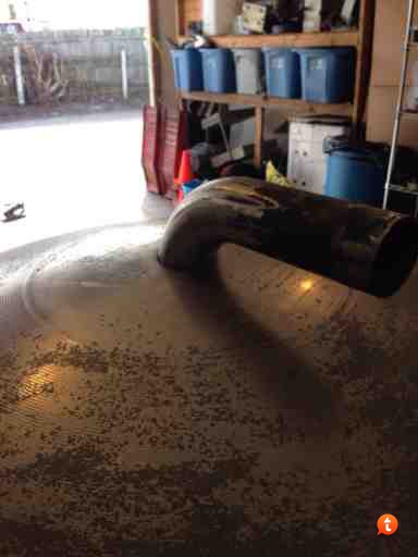

My Elephant bark flooring arrived today, I saved $1300 over going with line-x. Still plan on acid-priming the floor to seal it good.

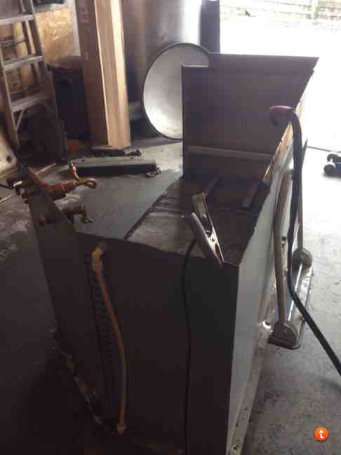

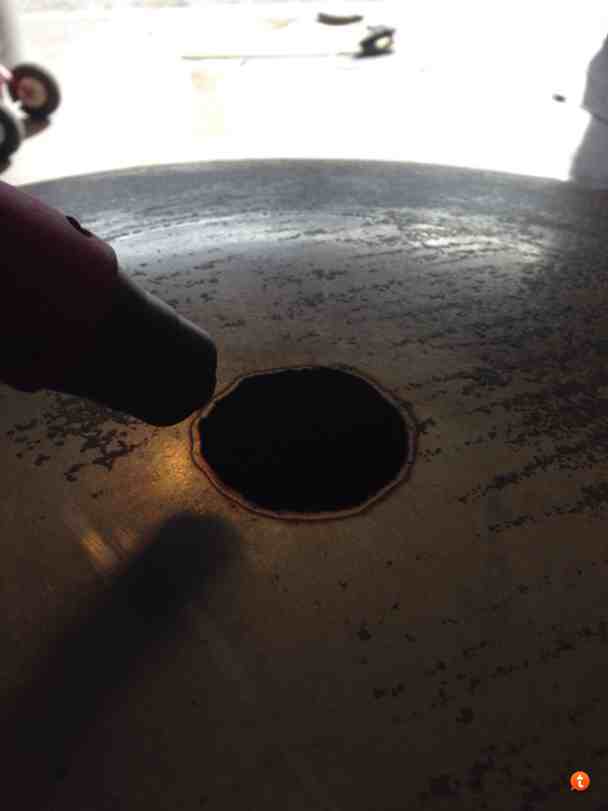

Got the replacement plasma cutter, welded the drain in

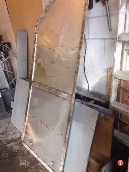

I'm having a custom panel water jet cut, with our V's having the puny 135 hp engine, we need all the help we can get :)

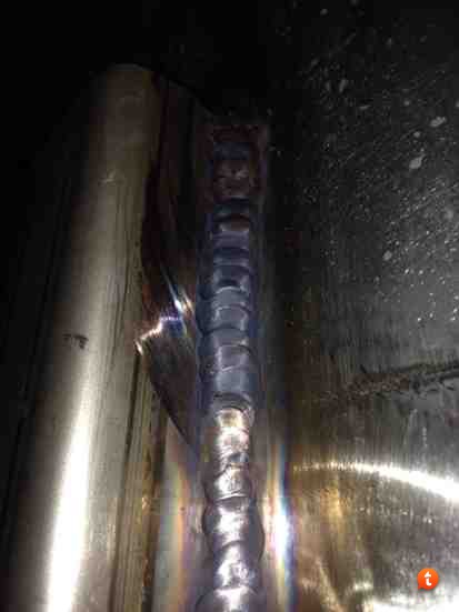

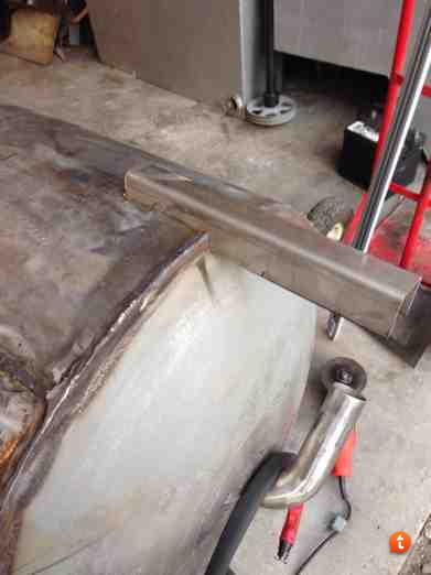

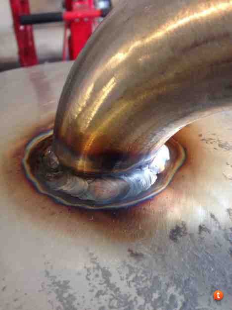

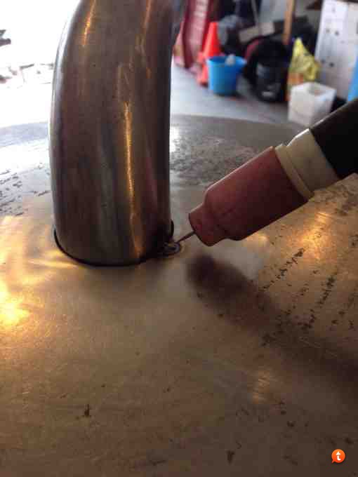

Welding the legs onto the waste tank.
My tig welds are getting slightly better looking.

As long as I tack weld everything first, it evenly preheats that eay
Reactions: JS41035
J
JS41035
Stainless can be tricky. But I like to go a little hotter and faster on the thick stuff. It's funny how fast you lose it. I was making a stainless mounting bracket for the waterbox on a 405. Hadn't run the tig in a few years. Got counterproductive real fast. :)
