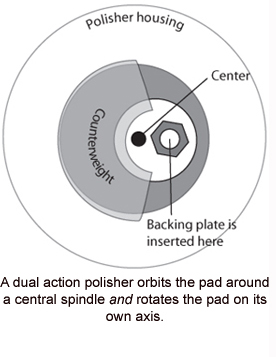

Can you tell me why I can watch many other vids with the vibe or eco and see a much faster revolution of the pad?
Rotations are a side effect of the oscillations. Faster the orbit, faster the rotations. That said, my Mytee machines used the same 9/16 orbit of the Trinity machines and didn’t rotate half as fast.
Mytee John tried to figure it out and said Trinity does something different with their flywheel, giving them a stronger rotation.
My Orbot rotations would sometimes come to a stop when I used the weights (almost always) depending on carpet.
My Mytee machines were a little better, but would still slow under load and that was with a 1.5 HP motor.
I see lots of Orbot owners complaining about rotation speed.

You are such a goddamn know at all, and you are simply wrong here. Rotations are at 100% a side effect of the oscillations, which is why you can stop the rotations on most OP machines without much effort at all and the oscillations continue at full speed. There’s nothing in an OP mechanism that directly drives rotations. Every bit of torque from the motor drives the oscillations and the oscillations spin the driver. You could remove the bearing for rotations and lock the driver from spinning and the oscillations would continue.
You simply have no clue what you’re talking about, but you think you do.

Side effect? The crankshaft turns the driver (rotation) and an eccentric offset creates the oscillations. This isn't a concept unique to OP machines......
Wrong. The crankshaft with the offset jiggles “oscillates” the driver and the torque from jiggling spins the driver. On Orbot machines, I can just put weight on the driver and the rotations stop, but the oscillations do not. The rotations are absolutely a side effect of the offset torque.
There’s nothing directly driving the rotations. If there was, it wouldn’t be easy to stop the spinning.
If there wasn’t a secondary bearing on the driver, the driver wouldn’t rotate it all. That secondary bearing is merely using leftover energy from the oscillations.

But seriously, if you were to remove the driver and get all the way to the initial flywheel, coming off the crankshaft and turn the machine on, all you would see, is the flywheel oscillating. You wouldn’t see the flywheel spinning at all. Now, the oscillations are directional which creates torque. That torque works its way down to the driver bearing, then gets the driver spinning. It’s no different than an orbital polisher, it’s very common to see those things not spinning at all with weight applied. When they do spin, it’s just torque transfer down to the secondary bearing.

The crankshaft does rotate just like a 175, but that offset flywheel turns all of that rotational torque into oscillations.
9,860
Is it like getting a pad off center on a 175 and changes the rotation of the pad slightly? They will what we call orbit?
No, because there’s no flywheel and the pad would still have direct rotational torque.

Yes, but everything I’ve told you still applies. Rotations are a side effect of the oscillations. Strip polisher down all the way to where the crankshaft meets the flywheel and you’ll see it oscillating only. At least the polisher I have. Every OP machine I’ve owned, the transmission doesn’t rotate after the crankshaft. It takes the second bearing on the driver or close to the driver on other machines to transfer some of that directional oscillating into rotations.
Lock up or remove that secondary bearing and you get zero rotations, and 100% oscillations.
You are arguing that the machine directly drives rotations from the motor, which is not the case.

If the motor directly drove rotations, the motor would bog down once the rotations slow or stop, and it doesn’t on any machine.
