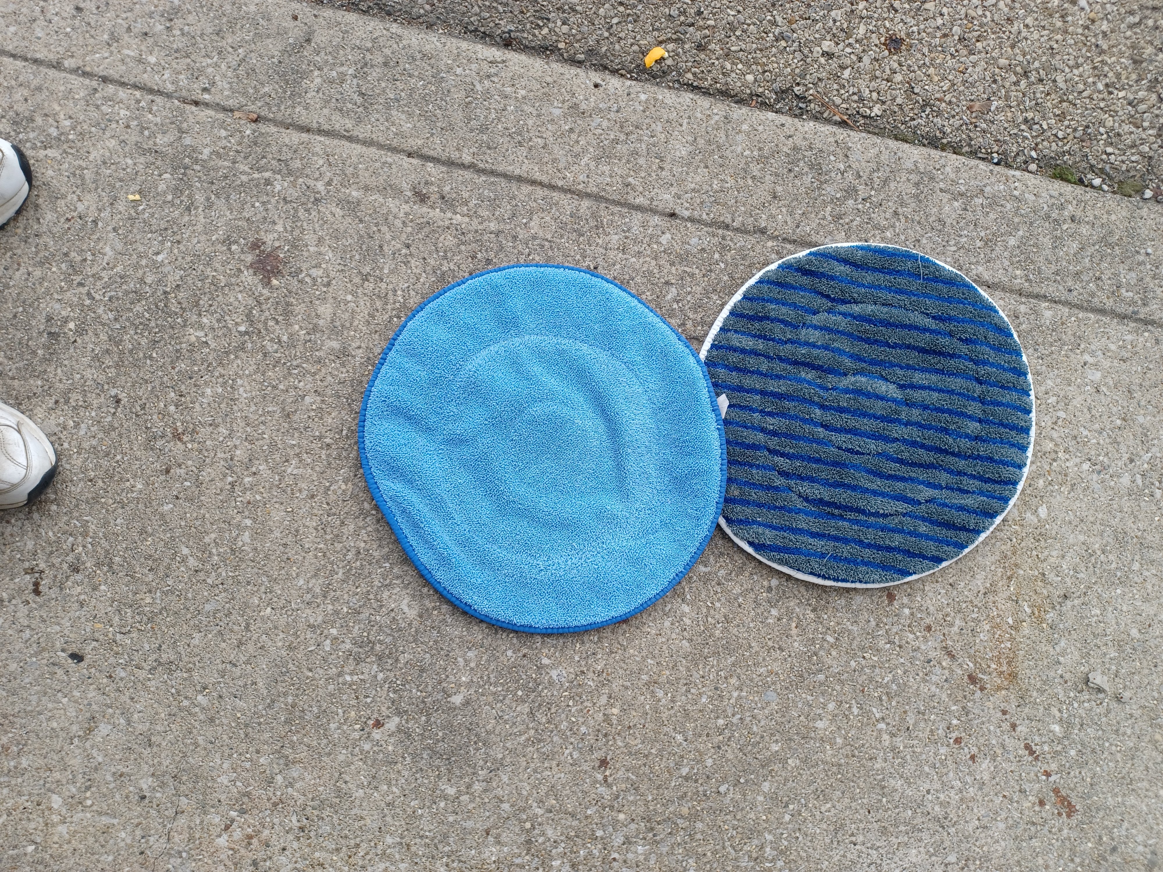

Here’s a Facebook post from a no-BS guy.
I’m out, I’ll get you a video.
maybe show me the tamping action as a claim in the patent instead....
and again all of that can be attributed to, in comparison to other machines, the increased speed/orbit of the trinity.....and possibly pads or specific situation*....no magical tamping action needed
*i can rub, without tamping, a rag across a rug filled with hair and get wads of it
