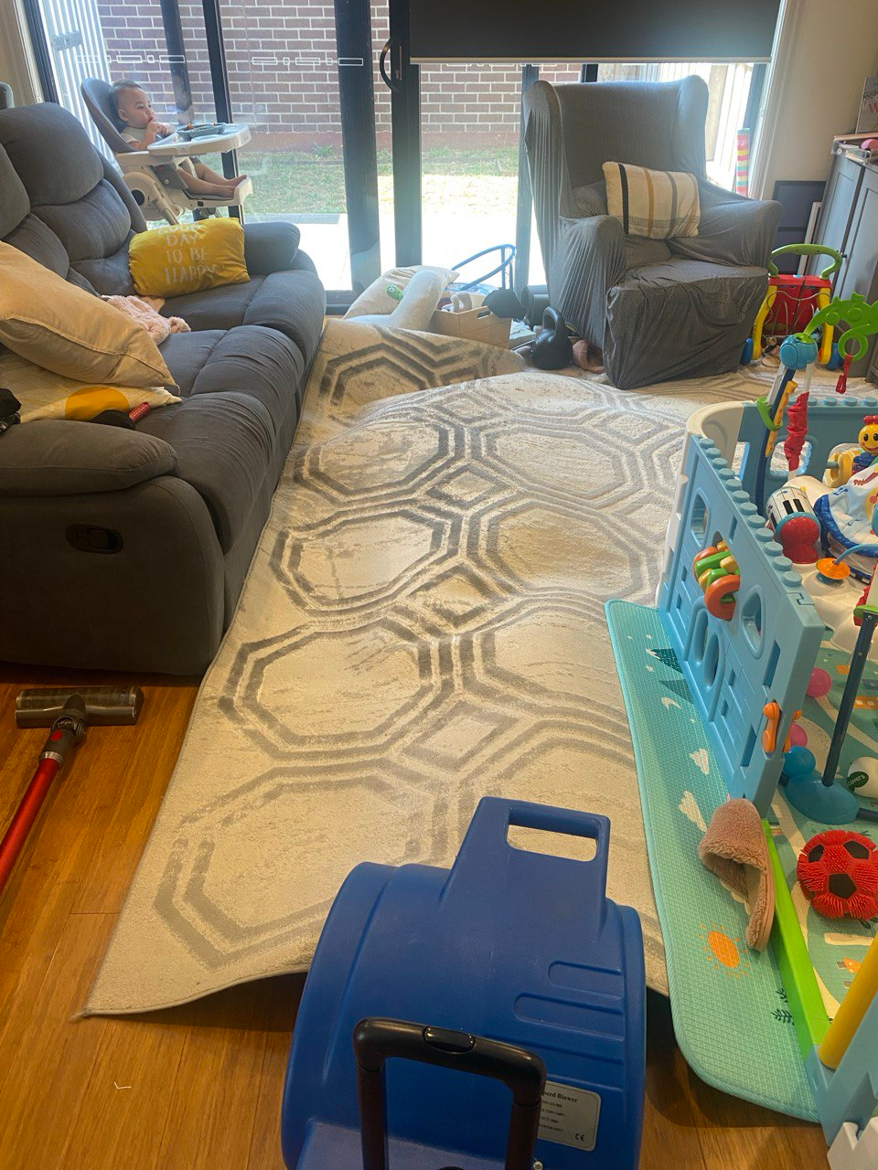

CaffClean
Jul 4, 2020
82
The blunder from Down Under
The culprit is hiding behind my son with an empty coffee cup...
