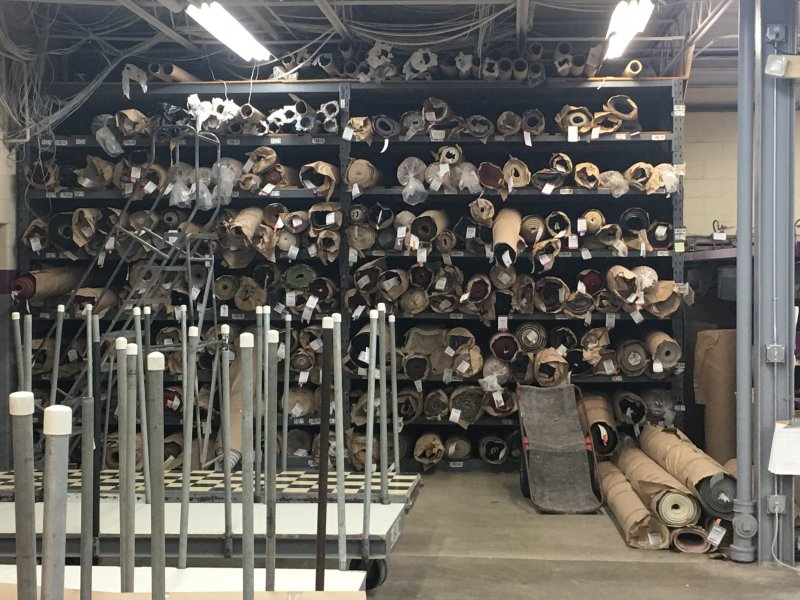

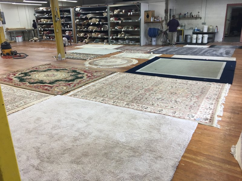

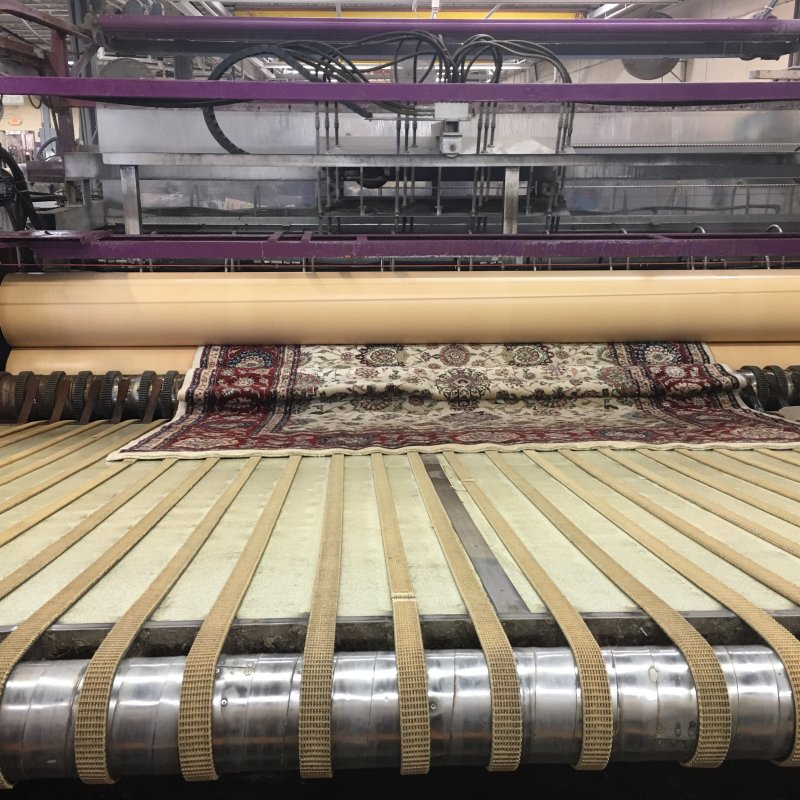

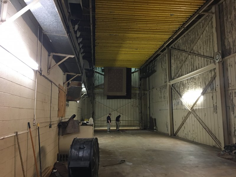

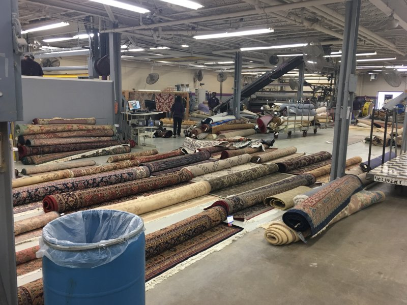

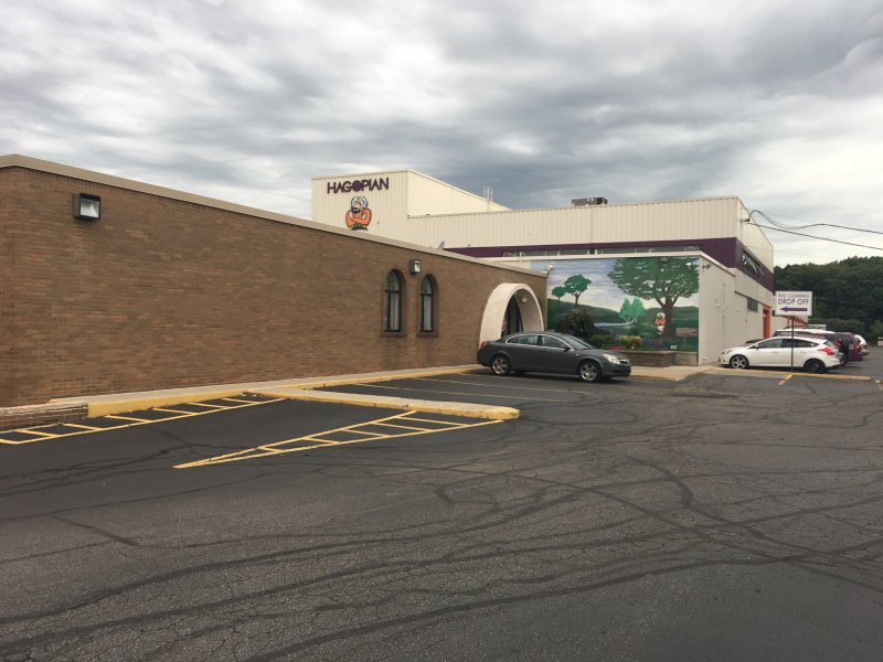

I totally agree Randy but what if you could get a quality in-plant experience for less than $1.00 per square foot? We charge $199.99 for a hand knotted 9 x 12. We also offer a 2 for 1 promotion if they are dropped off at one of our drop off locations. . If you have two 9 x 12 rugs that works out to less than $1.00 per square foot.
Our process is set up to be able to give customers a clean rug for less that it cost to replace it. We do charge extra though for repair, guaranteed odor removal, stain removal, etc.
Reactions: Nomad74
116,017
But I have to move to Michigan...
That was available here I would have a different strategy for sure. You are the lowest cost rug washer I have encounter anywhere. That probably isn't a good distinction long term, but if it works for now in your market, rock on. Personally I wouldn't want to be doing it for that and attempting to " make up for it in volume ". I just haven't seen that work very often in any industry. Lets face it rug shops charge what they do because it's a lot of work and overhead to cover. In someone areas you might be able to sharpen your pencil and make it work. Try that in area like here where rents are off the charts and you would be DOA quick. One rug washer I know has $60,000 a month in rent. A buck a square won't work in that cost structure.
We have only been in business for 81 years and are still learning. Maybe by the time we reach 100 years in business we will have it figured out. :biggrin:
Seriously though, how can we expect customers to pay more than the cost of the rug to clean it? We do clean a lot of rugs and do it in a way that we also make money at it.
Reactions: roro
27,875

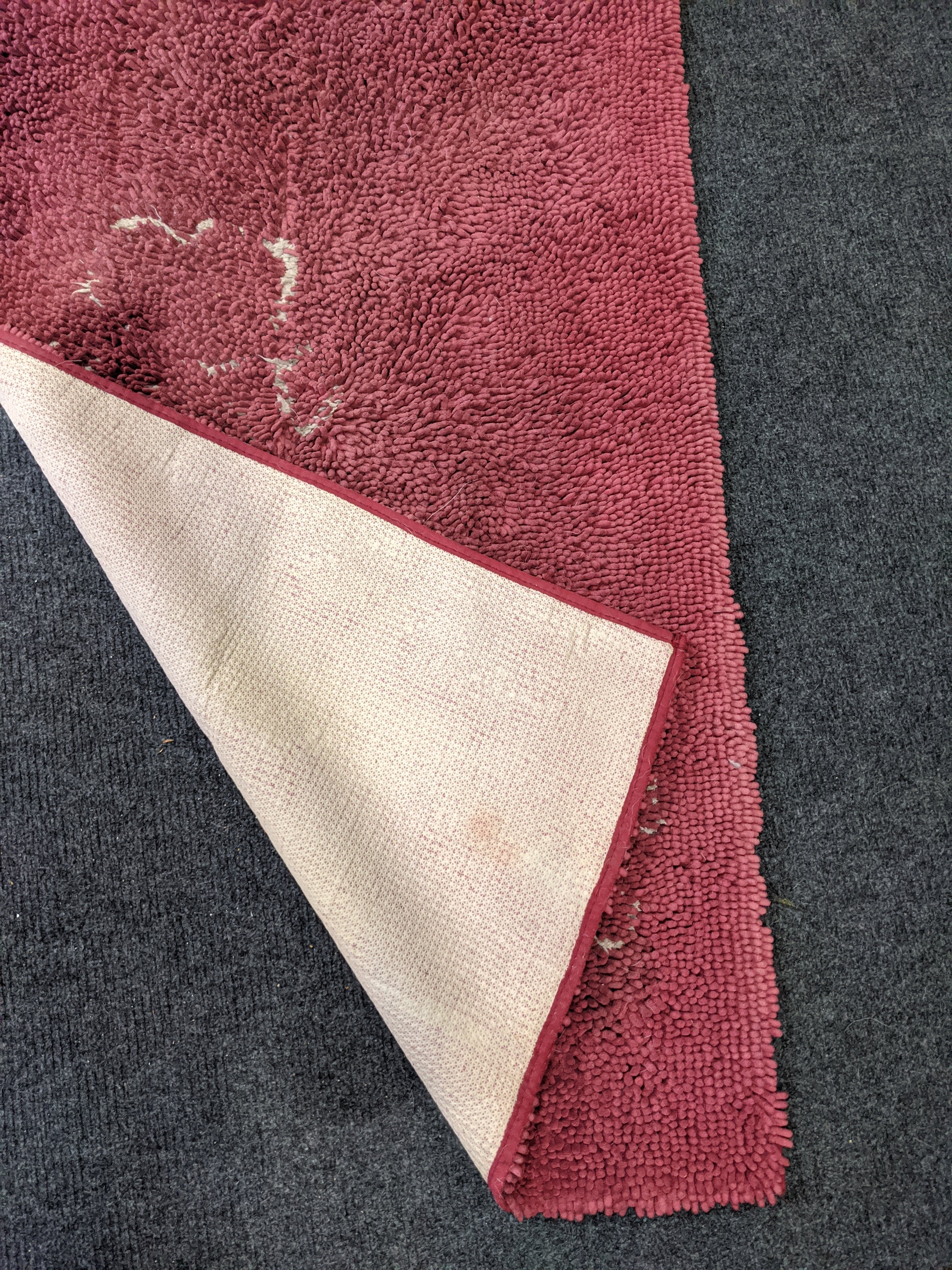

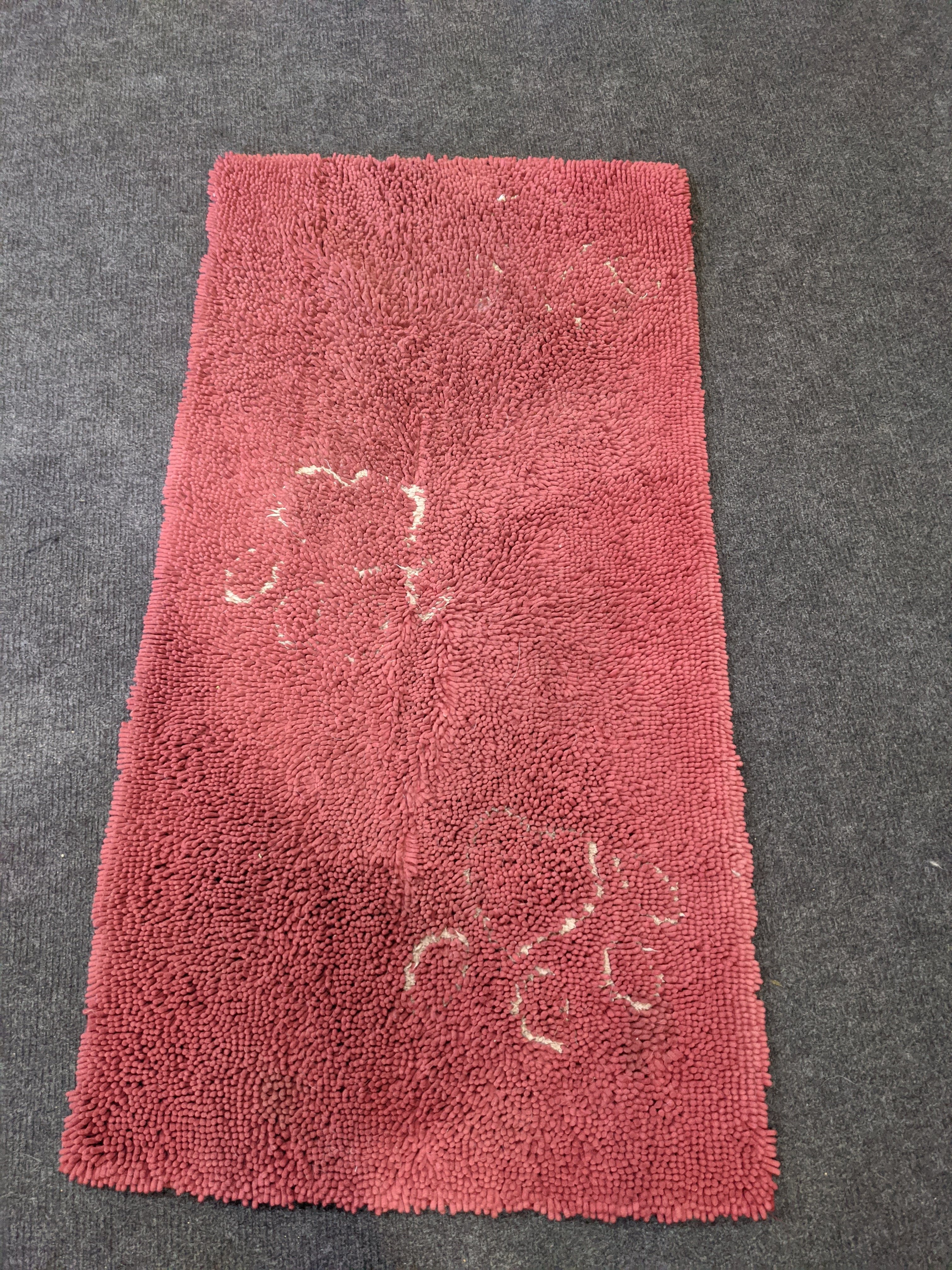

Customer pays me $50 to clean this beauty about every 4 months. It's the dogs favorite mat to sleep on. Probably worth $19.95 at Walmart.
