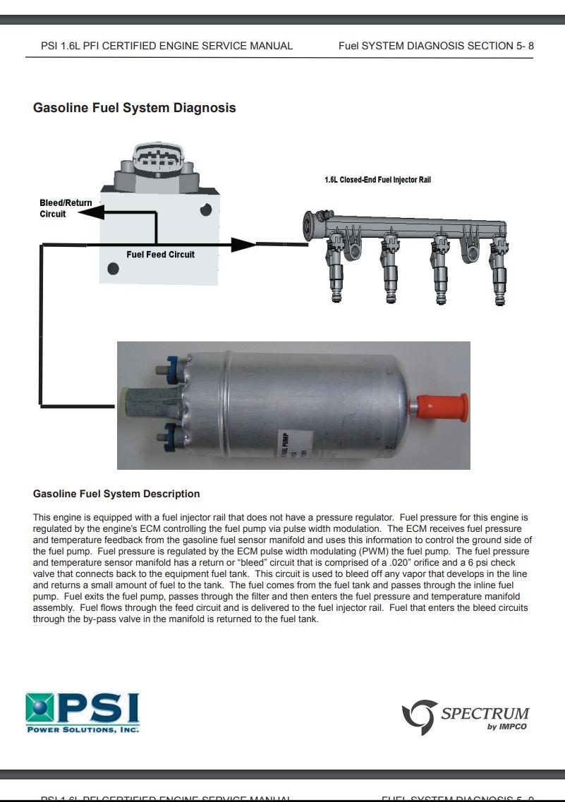

I need to do a test just to see if gas comes out of that vac line while it runs to see if that’s why the pressure is low
Which vac line?

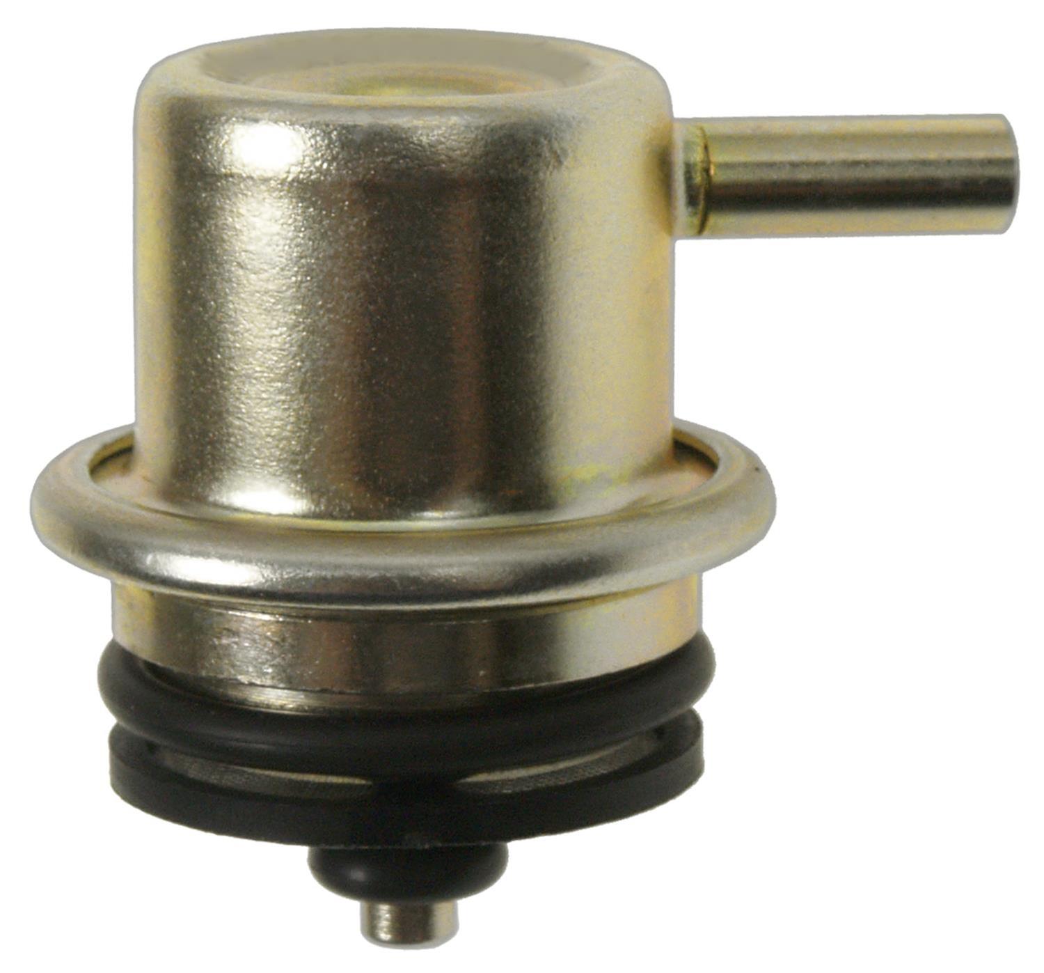

I thought he was talking about the one you would see on an FPR
Maybe I misunderstood. I was thinking about the fuel line that returns fuel back to the tank
I guess it could be bleeding off too much...
Do you have an actual manual?
If you talk to somebody at PSI that sounds like they know what they are talking about ask them which method is used to calculate the fuel pressure. It may not be gauge pressure and could make that 32 or whatever what you should actually be seeing on the gauge.
It's possible it could be bleeding off too much. Especially since it is the only thing separating the two sides with the only other leakdown point being the injectors. I ended up finding that 55 number which got me thinking about why would it be bleeding off too much.
When the manual tells you to put a gauge inline it doesn't say where. If we assume before the manifold is where you should see the 55 +/- 5 I suppose your reading of 70+ could be overpowering the check valve in the bleed circuit. Are you using the correct pump?
do you have a model-specific manual?

I was thinking pump also.
Yeah but think my line of thinking is incorrect because I would assume the circuit is designed to work at a constant rate so the only thing increasing the pressure would do is increase the volume going back to the tank. The check valve existing to close when the pressure drops so that fuel/air isn't pulled back in.
not opening up more with pressure increase as I was thinking
so I still don't fn know
Matt how were the spring and ball oriented in that thing?

I'm curious to know which fuel pump he's running and also what rate or GPM the pump is rated for. It's possibly underrated?
Reactions: FB19087
9,754
I'm pretty sure if you ball valve the return line and put a bit of restriction on it, it should boost the head pressure.. I'm no mechanic though.. I know that's a redneck trick but none the less..
Maybe.
but this isn't a traditional return line. It's a jet/orifice that sprays a small amount into the "return line"

Fred, that's the exact fuel pump I use. It's rated at 95psi, and sapphire told me they use a 120psi pump. I bought one of those on their specs and it didn't give any improvement. So I put that 95 back on since it looks more original
That ball in spring valve is deep inside the bleed port that goes back to the fuel tank. I'll post a pic of both the old and new one
And Nate, I tried clamping that bleed hose to see if it'd increase the fuel pressure, and all it did was prevent my machine from starting up. So that's a dead end.

And look how the fuel goes into the MAP sensor manifold. Sapphire flipped that thing backwards and the fuel enters the manifold from the other end. I tried flipping it on the old manifold, but not the new one yet. I never got an explanation on why they suggest that on the thermal wave.
OK....I'm back to thinking maybe the pressure is correct at the rail...
