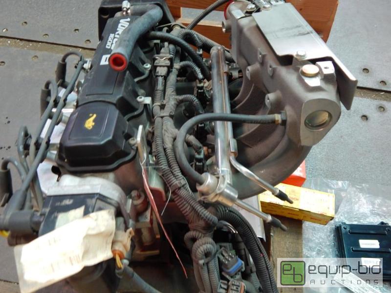

That connector close to the floor is where I’m reading 35psi right before the injectors.
Justin told me 55. And the chevy Aveo engine has the same pressure of 55ish also

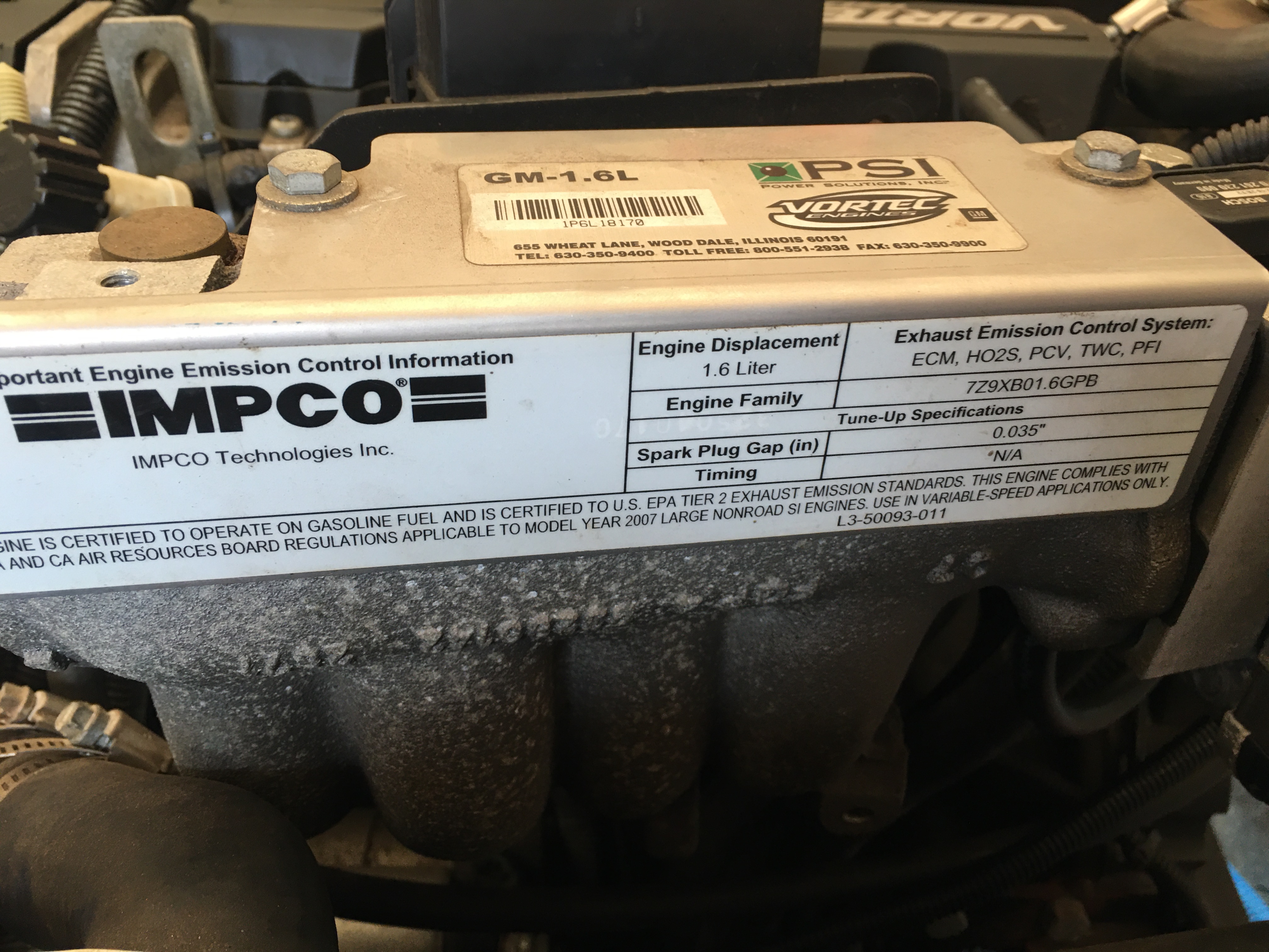

"The ECM will flash the MIL indicator with a pause between represented numbers that represent DTC codes. The sequence starts with code 1654. Code 1654 confirms the system has entered the blink code mode. The ECM will flash code 1654 (3) times before displaying the actual DTC code that may be set"
This is from a PSI manual and why I said 1654 may not be a code at all
and from a gm 1.6 manual
The Engine Control Module (ECM) receives information from various engine sensors in order to control the operation of the fuel injectors. The electric fuel pump, prevents fuel flow unless the engine is cranking or running. During key on, electric fuel pump receives a two (2) second prime pulse from the ECM which allows Gasoline to flow from the tank through fuel filter and fuel lines to the fuel rails where the pressure is regulated. With Ignition “ON” and fuel pump running pressure should be 284- 325 kPa (41-47 psi). When the engine is idling, manifold pressure is low (high vacuum) and is applied to the pressure regulator diaphragm. Vacuum will offset the spring pressure and result in very low fuel pressure. Fuel pressures at idle will vary somewhat depending on barometric pressure but, should be less then pump pressure.

It held 35psi from idle to full throttle. So my goal is to get it increased somewhere between 41-47psi. Is that correct?

It’s the MAP sensor I replaced yesterday. It’s called a FPR in the manual but is a MAP at the auto parts store.
