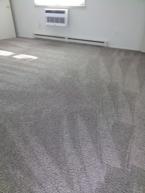

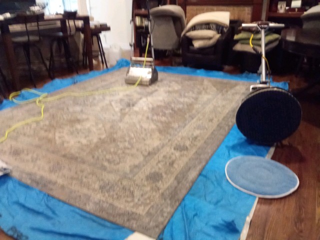

Some bad pics from 9am job today but forgot to take after pic of area rug
Been going to this house for at least 10 years
Family Room, and a cheap synthetic Area Rug
VacAway Double Trouble 3oz and added 6oz of VacAway Odor Death X2 (CL02)
Vacuumed but still pulled out more pet hair with CRB's
Scrub with Brush Master Pro CRB
Extract with Microfiber Bonnets on Tankless Orbot Vibe
Groom with 10'' CRB with soft brushes
I love SETT !!!

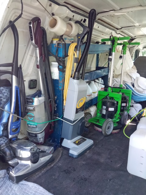

I love my encap machines. I have a vibe and a Phoenix. I also have a third one by tops, but can’t remember the name. I think its an Odyssey. Also my cimex and 175. All come in handy.
I have a 12k sqft jobber coming up. I plan to put them all in action.
I have 2 Odyssey
In most cases I use Odyssey on small residential and Tankless Vibe on big Residential
I bought Odyssey in early 2020 and it was a GAME CHANGER for me
I had been using a Challenger on residential to extract after scrubbing with a CRB
Odyssey was a huge UPGRADE over Challenger
Thank You TOPS !!!

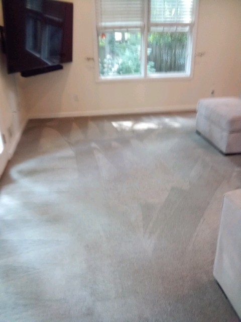

Is Mikey's Board VLM Friendly ???
Mikey's Board is GROUP THINK
Everybody sticks together, thinks the same, agrees with each other, and likes each others comments
You must flood carpet with gallons of water to clean it
You can do it that way, but is there a better way to clean carpet in 2025
What I'm trying to do is ... ''Open some Eyes''
I want to promote the VLM/SETT Method and make it the PREMIUM Carpet Cleaning Method for 2025
LESS water MORE agitation
That is a Living Room for one of the Apartments in the Apt Complex I clean
CLEAN and DRY in 1-2 Hours

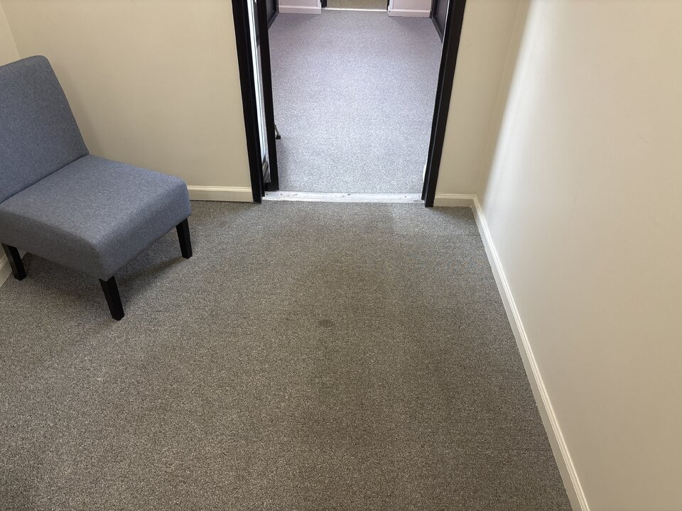

Before/after on a job m HWE today
Yes, this is a candidate to lmc
But will I ever do that? He’ll no
I’m going behind a cleaner last month who wasted their time bisseling it. If I buffed this carpet with the latest floor buffing technology, I’d leave behind all that leftover dry soap from the bissell
But hey, you do you
I’m really cleaning it
