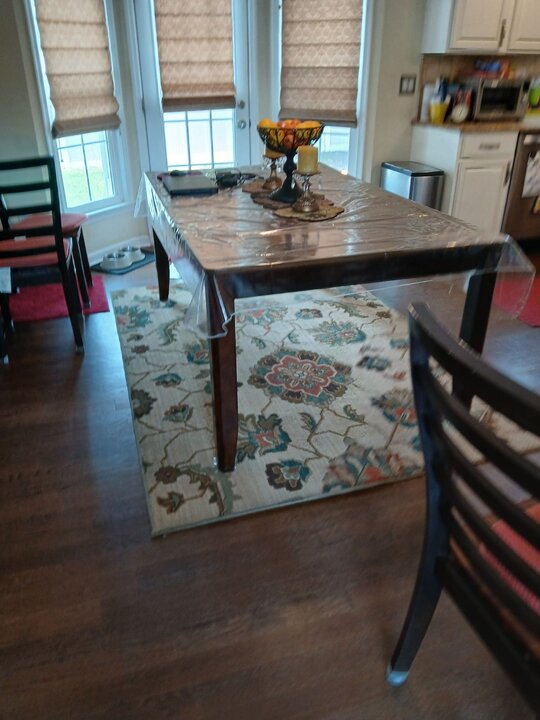

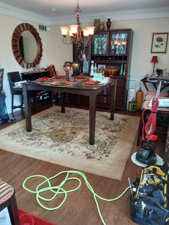

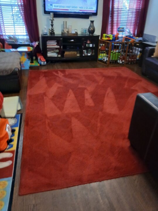

How I clean Area Rugs using the VLM Method
Yes I know GROUP THINK Members don't care
I've been doing this house for about 10 years. Ashley and husband went to Mexico for a vacation. Her Dad is staying at the house taking care of her house and three dogs. I did 2 Bedrooms and 3 Area Rugs. Kitchen Area Rug was trashed with many spots and spills. Dining Room Living Room Area Rugs were not as bad
The Oreck Obiter works great for cleaning thin Area Rugs. I used TOPS Odyssey on Bedrooms and Oreck Orbiter for Area Rugs
All 3 Area Rugs looked much cleaner and brighter after cleaning

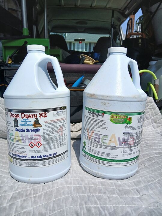

VacAway Encap Green and Odor Death x2 are fantastic VLM products that every VLM'er needs on their Van
Area Rugs
Vacuum - Kirby Avaril
Encap - WORX Sprayer with 8002 Teejet VacAway Encap Green 4 oz and 6 oz VacAway Odor Death x2
Scrub - 10'' CRB with Grey Brushes
Extract - Oreck Obiter with 14'' Challenger Bonnets
Groom - 10'' CRB with Grey Brushes
Get Paid with a HUGE Profit

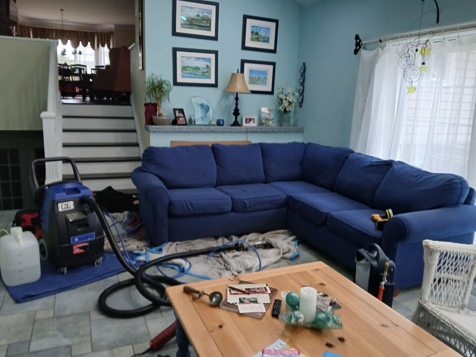

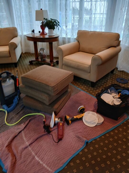

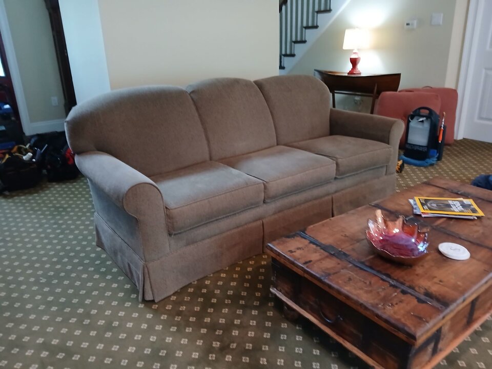

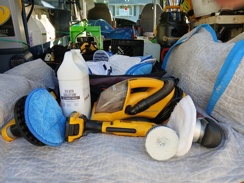

How I clean Furniture using the VLM Method
I've been going to this house for 5 years. She does her carpet and furniture every Summer. She has 3 dogs and they spend a lot of time on that Blue Sectional so I used my portable and the back cushions the fabric is loose fitting and hard to clean with VLM.
I used Bonnet Pro Omega Citrus 4 oz and 4 oz Vacaway Odor Death x2 and rinsed with Water on the Blue Sectional
I used Grey Matter Chemistry Silver Solution 4 oz and VLM on 3 chairs and Sofa.
I use VLM on the majority of Furniture but some loose fitting fabrics and TRASHED Furniture are very hard to clean using the VLM Method
When I don't VLM I use a 6 Gallon Heated Esteam 100 PSI Portable
VLM Furniture
Vacuum - Eureka Hand Held
Encap - Cordless Multi Sprayer with 8002 teejet 4 oz Silver Solution
Scrub - Drill Brush soft white Brush
Extract - 6 '' Orbital with 8'' Challenger Bonnets
Get Paid with HUGE Profit
I love VLM !!!

That LST formerly known as silver solution and vice versa is a great problem solver but it is not an encapsulate that I would not be leaving it behind expecting any magical pixie powder to vacuum away later..
SteamwayPro
Apr 8, 2012
295
George
I can't disagree with that but I have never seen any resoiling or any other issues using Silver Solution. There is very very little left behind on furniture. Furniture was dry in 30 minutes. I used it last year when I did that furniture and it still looked good and clean this year.
SteamwayPro
Apr 8, 2012
295
George
When I was experimenting with VLM I used film formers and never saw any problems. No resoiling nothing but I don't use film formers on carpet anymore. I do sometimes use them on furniture with the VLM Method and have never had a problem or call back
