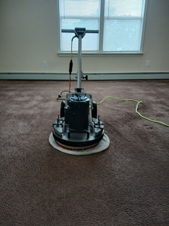

Vibe with a weight kit I'm not going to crb first probably use the stripped star two way pads
I have a Tankless Vibe that I use on Big Residential and Unoccupied Rentals. I CRB first and extract with Vibe
I always use at least 2 weights on each side. That adds 16 pounds of Head Weight

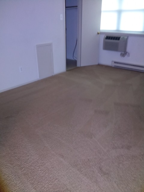

I could use a Carpet Brush/Rake to groom and it would be faster but on most carpet a CRB lifts fibers better and makes carpet look better than a Carpet Brush especially in the traffic lanes and in front of sofa
No I don't worry about making perfect groom lines. I just groom out the swirl marks and go to the next room

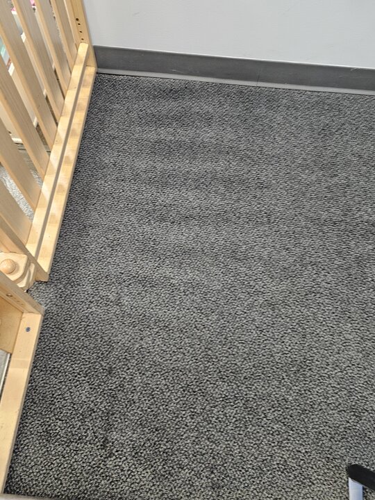

The dealership called me back. I didnt bother trying to fix this in the kids play area.
The place is filthy.
