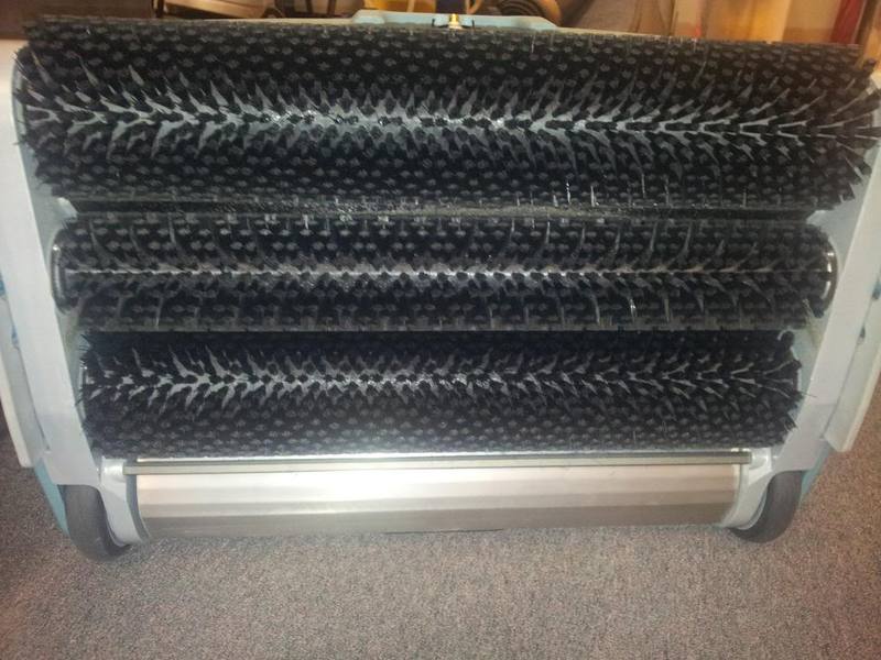

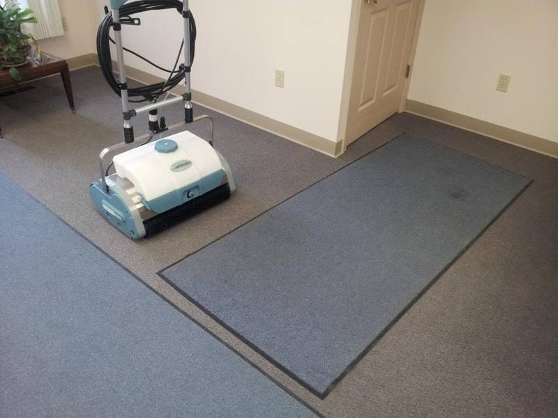

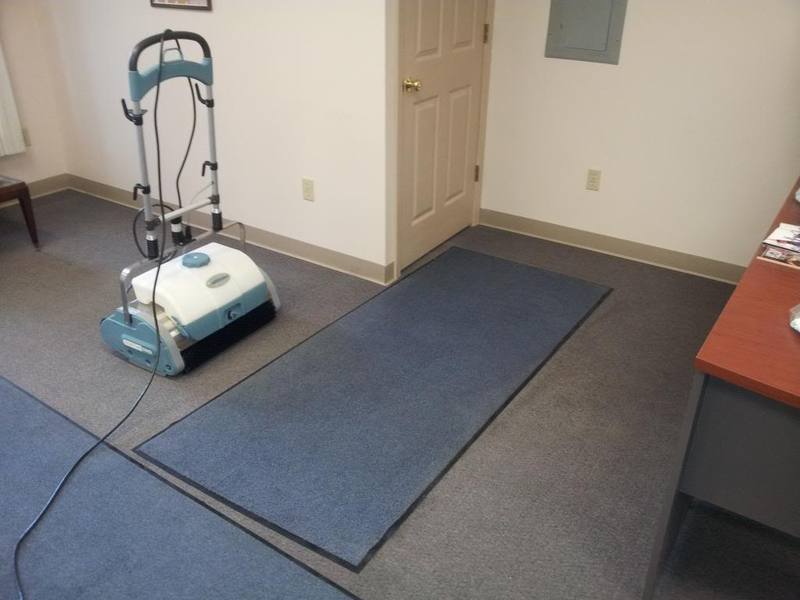

look at pictures 1 & 3 and you can see the 2 light-blue straps on the ends...very fast and simple.

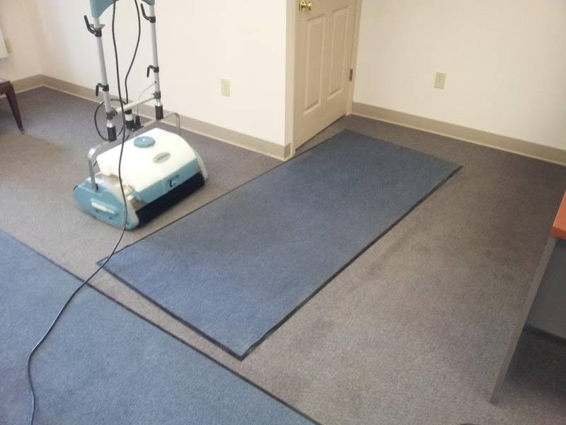

the pic's below are from a REALLY small job, i think it is our smallest commercial office (one of our insurance agent's satellite offices in a very small town.) probably about a 16'x17' room basically, with 3 mats. last time we cleaned it was 2 years ago. every time we clean it, it gradually looks a little better than the previous year...typical of my experience with encap on CGD. the 20" Trio cleaned it slightly faster than the Cimex it seemed, last night's larger job was a better judge.
hard to say on this small job if it gave a better appearance of clean than in past cleanings. overall i was happy with the outcome. it used i'm guessing half the encap juice that the Cimex would. and it dried in about 20 minutes, i was quite surprised. i was happy with the area of carpet that transitions to the chair mat...you know that area where the chair wheels roll off of it all the time and the carpet gets really worn (permanent damage) because the chair mat is too small? i'd say it cleaned that area up about as good as the Cimex. but i'll need a full day of using and cleaning 100+ cubes/offices and i'll get a better idea on that front.
my 2 biggest worries when running this CRB was:
1) it grabbing a loose seam and pulling it out (there was a seam all the way down the center of the carpet, i cut 1 piece off with my duckbill shears.)
2) it grabbing a phone/computer/monitor cord and tearing it out of the wall...i stayed far away from those things! with the Cimex i can get right up to them and let the Cimex push them out of the way a lot of times (although my Cimex did tear 1 phone cord out of the wall about 7 years ago :Oops ... but that is a rare thing for the Cimex.)
here are some pic's.
before pic of a mat with a spot:
after pic of clean mats and spot mostly gone:

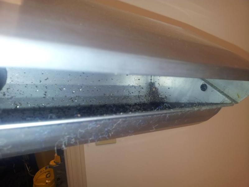

renovator tray after i finished (i thought it woulda had more in it, i guess my Dyson does a decent job of pre-vac'ing after all):
