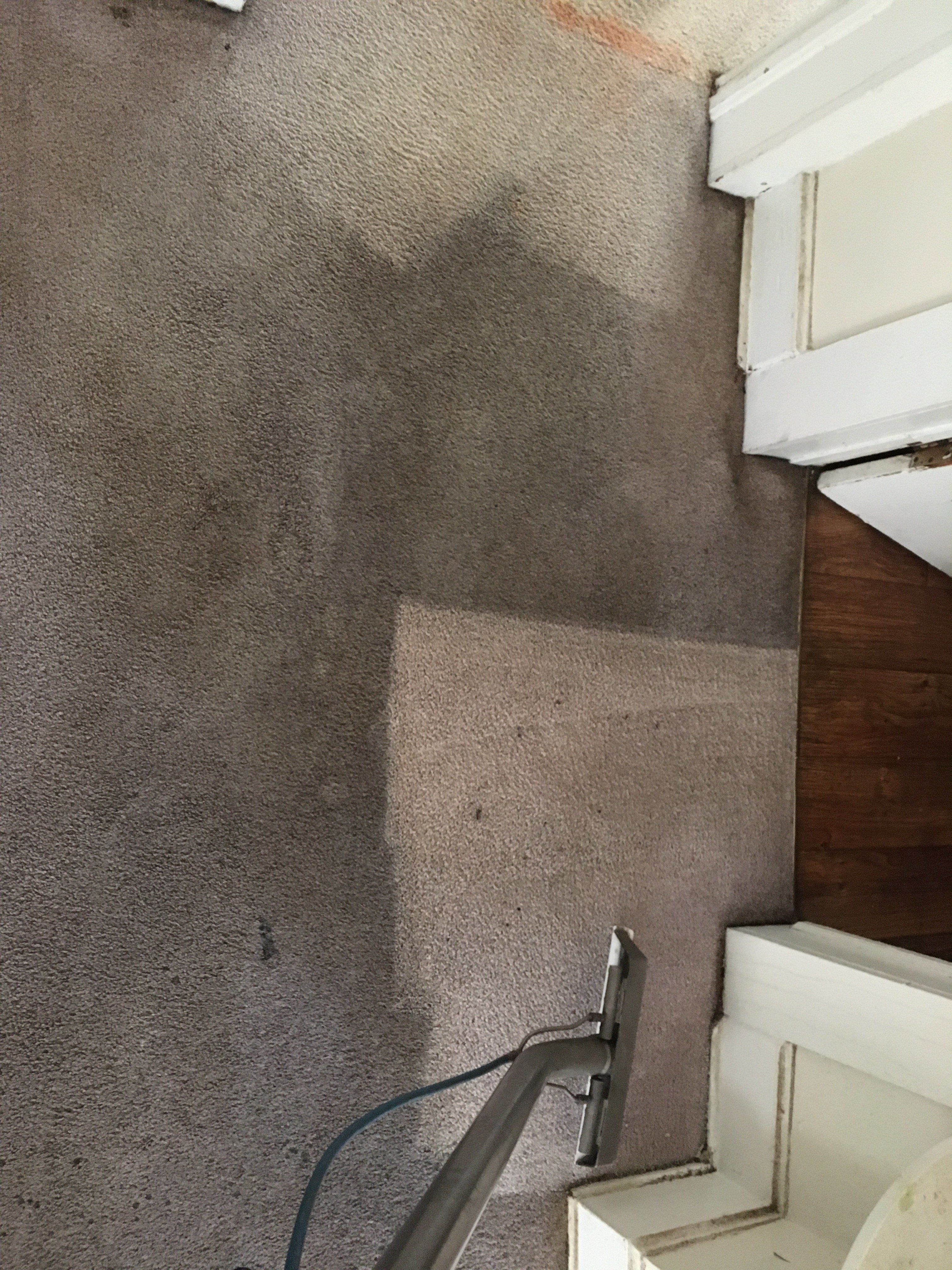

Yea that makes sense. Wtf do I do with this massive jug of purp? Save it for Chinese restaurants in January?
Here’s a job I used some purple on a couple years ago. Don’t worry about it
