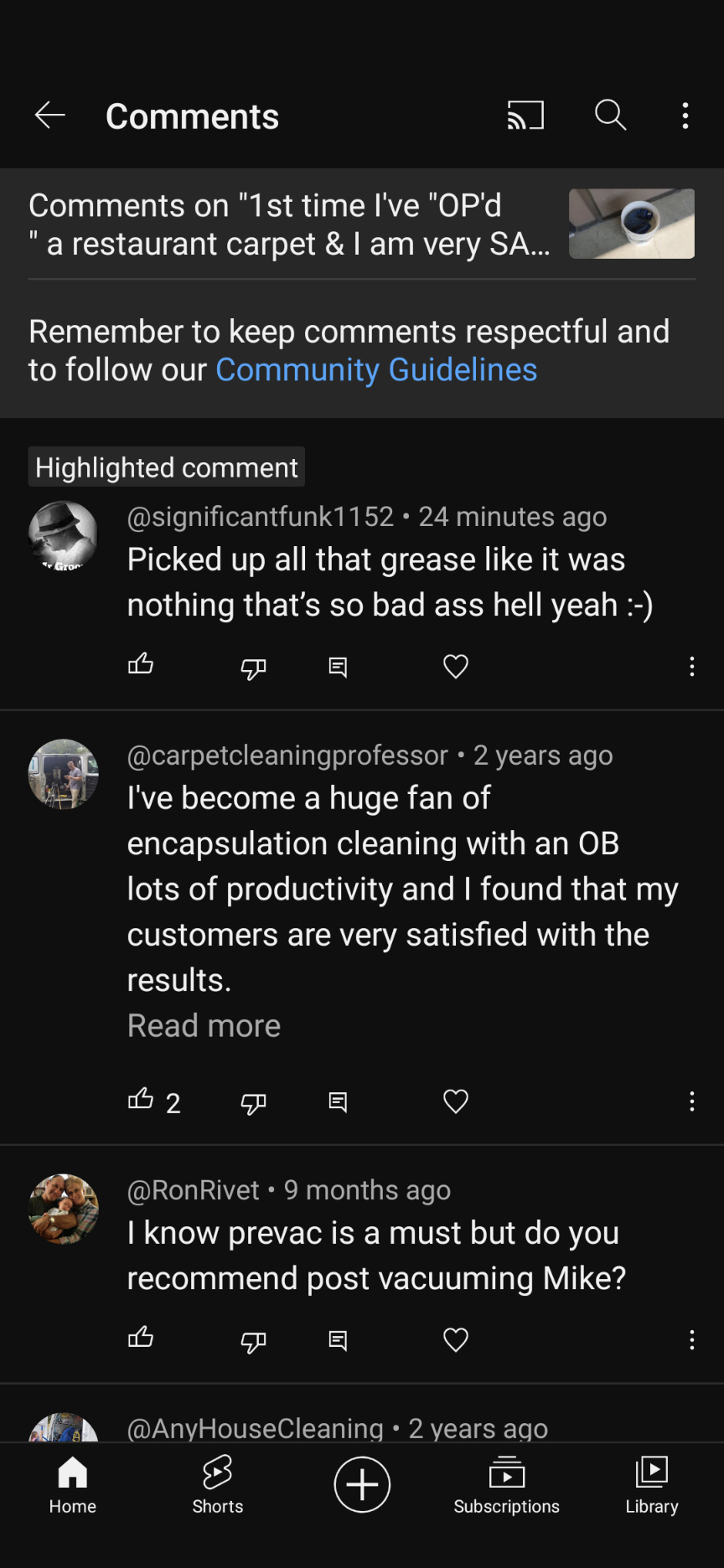

I'm so totally stoked using Mytee's ECO17 (1.5 hp & 3/4 hp) machines why would I ever want want anything else?
anBlZw
Had to raise prices across the board but still wanted to cater to the low budget client who simply cannot afford a premium service. I'm living in a state where half the population is on government assistance and living below poverty level. Yo, this ain't Tahoe bitch!
Besides, if there's a better method for cleaning carpets I want in on it. "They don't tell me nothing so I find out all I can". - Phil Collins
