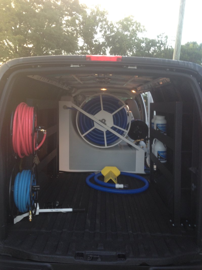

My old Prochem Direct made by Cleanco .. 120 gal fresh and 120 gal waste. The guy I sold it to has shut down. Hes looking to sell it. Hes in Midlothian VA. Lookin to sell the business but will part with the van and equipment.
(anyone notice Cleanco has slide ins that look alot like the Prochems - they are)
