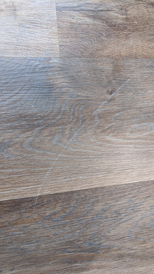

the trackless "spurs" on my Teflon glide scratched the heck out of a brand new Vinyl Plank floor today.
I wont call it Luxury because this Shaw product is complete garbage.
I noticed the scratching going on when I went against the grain almost right away so I switched to my WP HS wand to finish the project.
Luckily I caught it quick and even luckier I was able to use 0000 steel wool to make the damage virtually invisible..
As I worked deeper into the home I discovered over a dozen scratches that the home owner says the movers caused.
Some of the scratches that made sense, others I think could be the dog's toenails or maybe a Flea Circus skidding on their roller skates....
I went next door to the model home show room to test a plank and found that it took almost no effort to create a (against the grain) scratch with the screw driver on my pocket knife. She's only been in the home for a few weeks and has a six week warranty on all surfaces. I STRONGLY suggested that she get them to change out the floor ASAP. One year from now it'll be a sight to see.
TEST TEST TEST folks!!!!

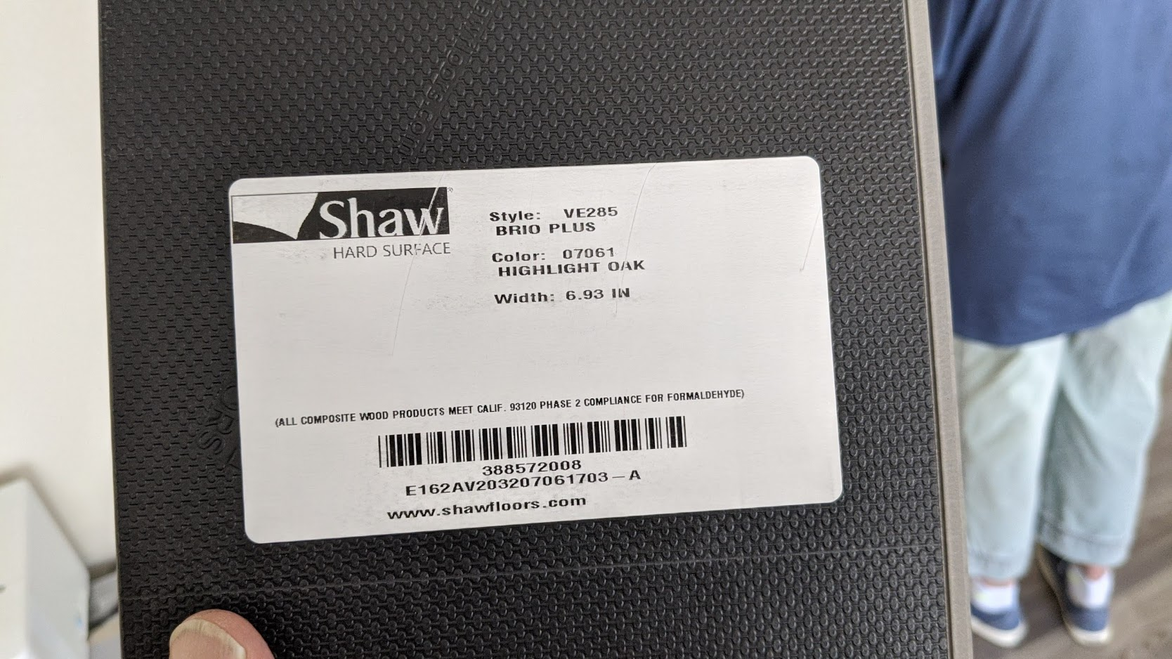

CONSUMER ALERT!
Considering Luxury Vinyl Plank for your next flooring project?
Do yourself a HUGE favor and test a plank or two before you purchase it by scraping it with a key or a screwdriver across the grain to see how durable it is.
I clean a LOT of this stuff and today I ran across a product from Shaw that a Teacup Poodle could damage by chasing it's tail..
*This product has a 6 mil wear layer, if you own a large dog, a teenager, a husband, furniture with legs or have small rocks in your yard, (so virtually everyone in earth) buy a LVP product that has a 20 mil wear area...
