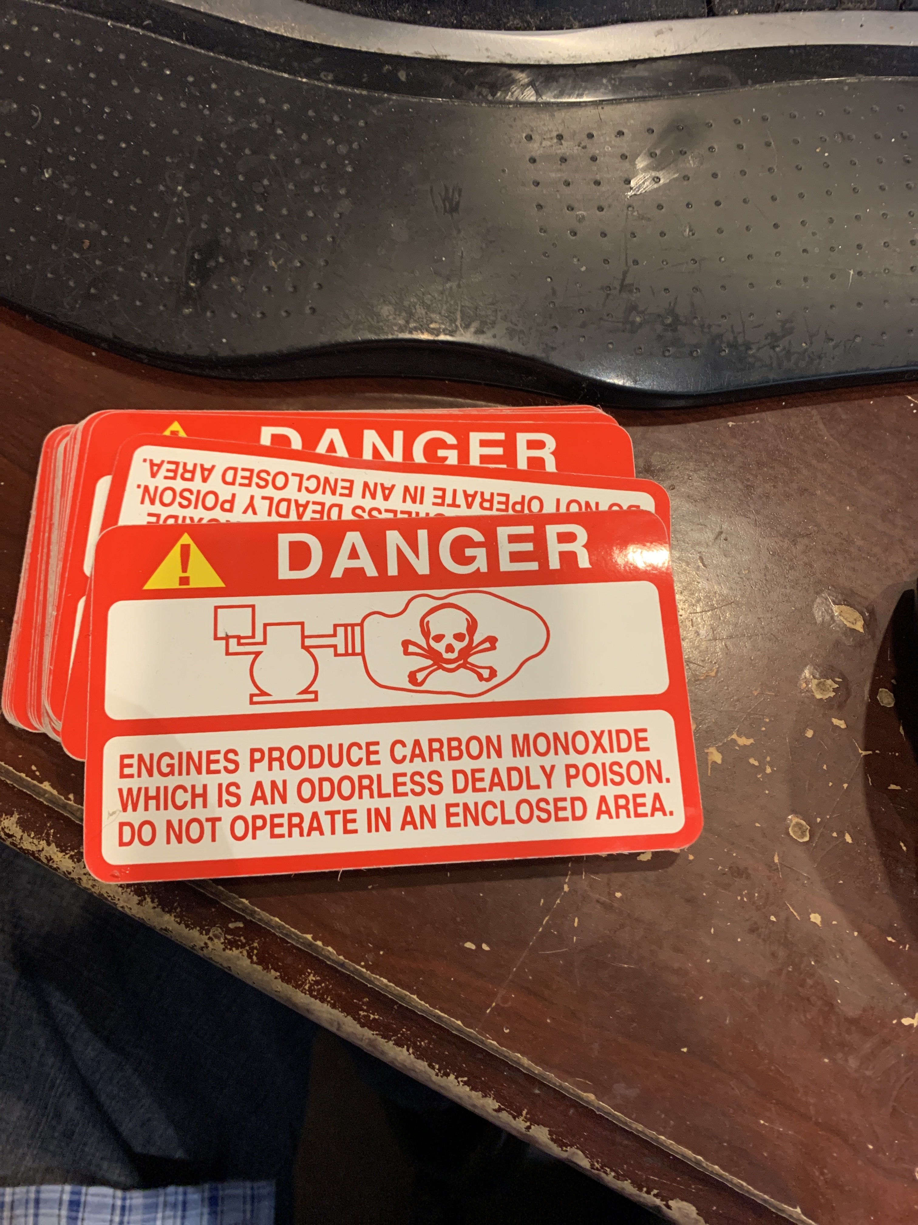

John Olson
6,281
Orem UT
John Olson
Fred you just broke my heart all over again and now I’m balling like a baby in my office. Jose was my customer and I had just met his new wife the day before. He called me that Saturday morning and I was with my son up at Alta while he skied. I missed his call while in the restroom and he left a voice mail. He said Mr. John,( he always called me me. John) don’t worry to call me back I’ll come see you Monday morning have fun with your son. That evening watching the news I see his van in the tv and turned it up to hear the most heart wrenching news. Please please please don’t ever do that to anyone. I miss Jose. He was a good man. If you need warning stickers message me with your address and I send you a couple free no charge for the mailing. These are what I have and I have plenty for everyone
