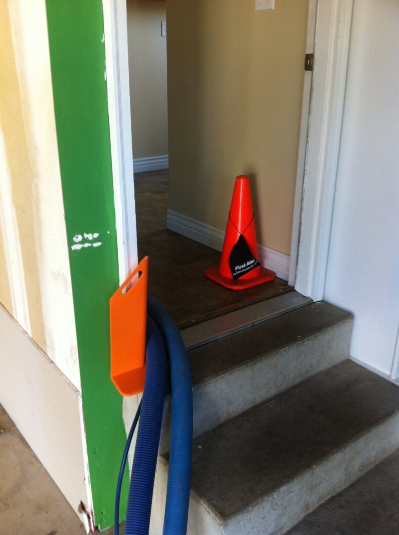

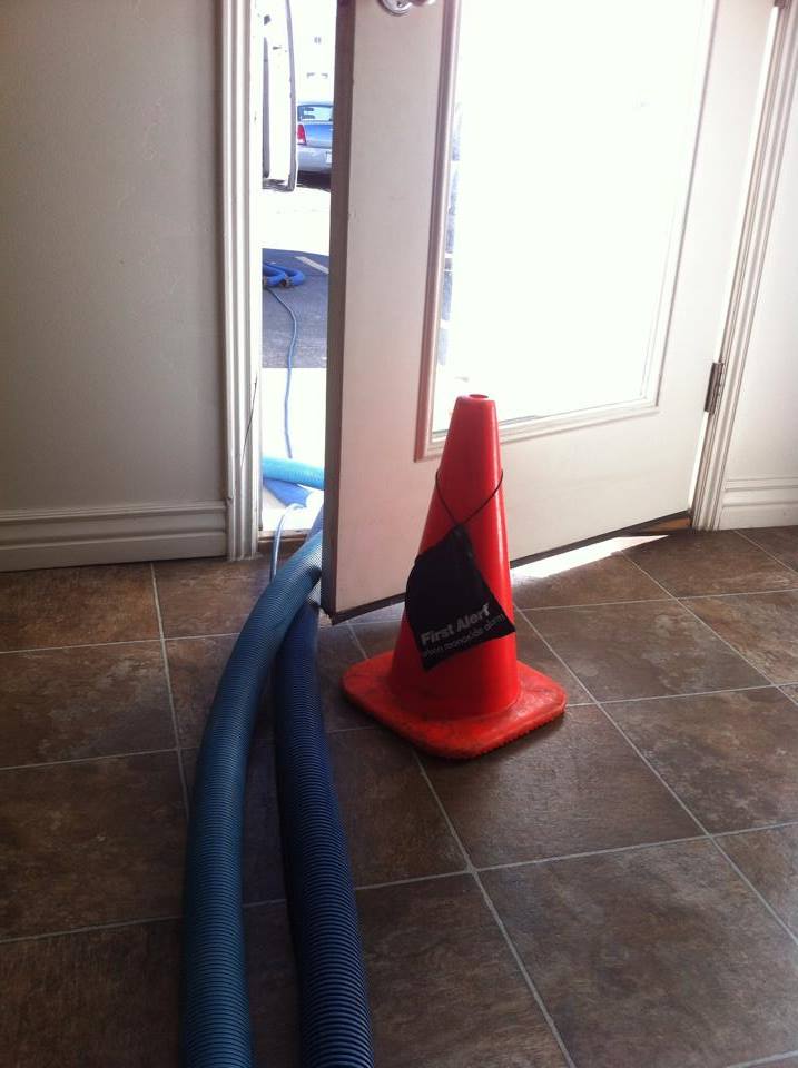

Every year it seems like a couple carpet cleaners die (or almost kill themselves or others)from carbon monoxide poisoning. Usually in the winter when operating the unit from the warmth and shelter of a garage is more tempting.
Don't do it!

Hey @Hoody can you repost this please?
I just talked a guy out of running his unit in a closed garage a few minutes ago.
12,571
No problem Jim - I made the thread a STICKY thread so it should stay at the top of The Clean Room.
Thanks Hoody!
The guy I warned bought a used truck mount last June from a guy who sort of threw him the keys and ran.
He almost made a very bad mistake.....
