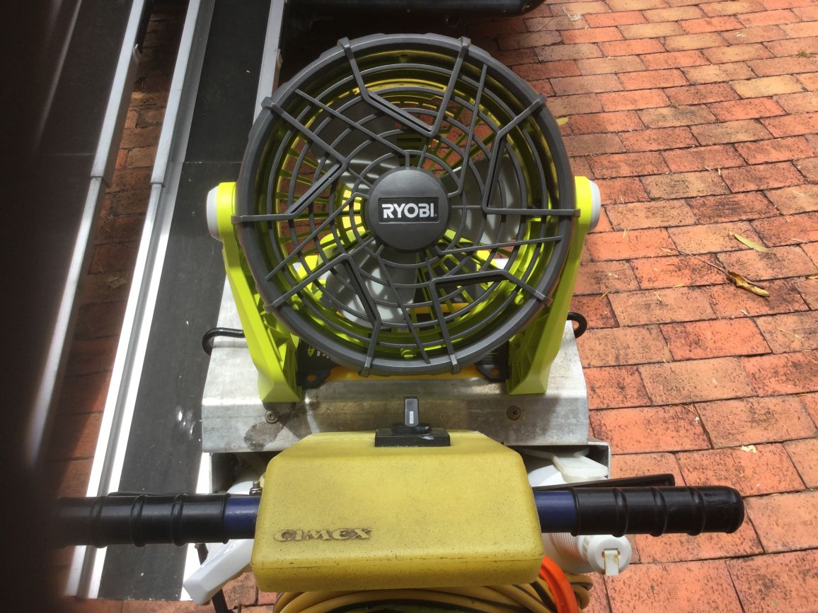

In places like this, I bring my own cooling system along for the Mighty Cimex.
Minimum moisture & technique ensures clean, dry carpet when the office is open for business next day.
