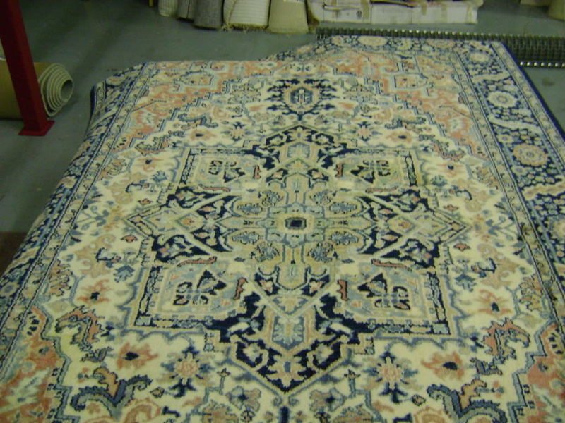

Light colored wool yellow:
o2 system mixed to strong equal yellowing.. ( have a sneaking suspicion that the previous cleaner doused it with an oxidizer as well and when we got the rug, we were not full washing at this point in time when this rug was cleaned.
