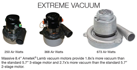

those are some BIG vacuums
117,330
http://interlinksupply.com/index.php?item_num=MXE-500#YTV
Who else uses vac motors that big?
50,037
I don't understand air watts. I always figured air watts was a term made up by the electroweenie guys to draw attention away from CFM's.

You know, I'm always a little disappointed when I look into the specs on these new motors. If you look at the typical operating point, at, say, 0.625" effective orifice, and compare with the venerable 116765 5.7" motor, the improvement is a little less spectacular:
116765 5.7" lift - 82inw flow - 44cfm
122176 8.4" lift - 99inw flow - 48cfm
an improvement to be sure, but not even close to double or anything like that....
The big deal for porty manufacturers is the efficiency I suppose, the 8.4 motor does it on 11.8 amps vs the older motor which needs 12.9.
There - that should draw Larry out into the open :winky:
He's cleverly devising a post where he can work in a sales pitch.....like all his posts.
Well minus the cleverly. :winky:
Larry Cobb
5,795
Larry Cobb
You guys need to pay attention to real advancements in our industry !
We pioneered the 1st 8.4" vacs a year and a half ago in an electric TM.
That unit has 17" hg of lift and now has 1500 hrs on the original vacs.
Now to Dave's post . . .
571/432 AirWatts is a 32% increase in vacuum and on less current.
That IS a big improvement.
And the improvement is larger when in a series configuration (~55%) .
Larry

I have 8.4's in my Techno Viking. These are the older ones but I only have 350 hours on these.
I have only had 5.7's in another portable so can't compare.

BTW, After I pimped out those mytees with these vacs, I was seriously impressed.
Someone with an older #4 Butler or a Machine with a 36 blower wouldn't be able to tell the diff. at the end of the wand.
Heck, someone with a Vortex with 600ft of hose out, would appreciate the Vac of these motors with only 50/75ft of 2"

On them mytees you pimped out did you put 2 of them motors on to get that performance ?
AshleyMckendree
Sep 1, 2007
1,572
Ashley Mckendree
1 Mytee was setup for max lift (IE Series) pulled 17hg while cleaning.
2nd Mytee was setup Parallel for max CFM (My favorite) this setup yeilded 12hg and 300ish cfm
