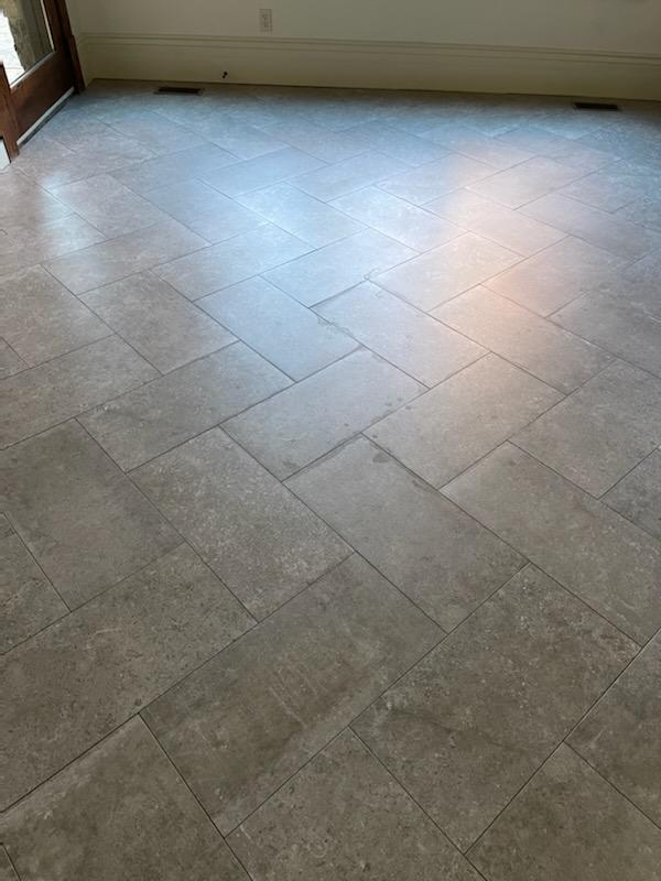

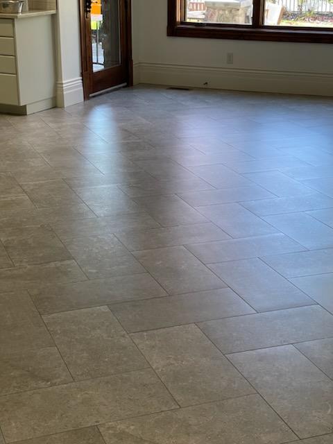

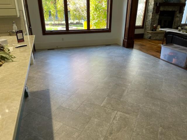

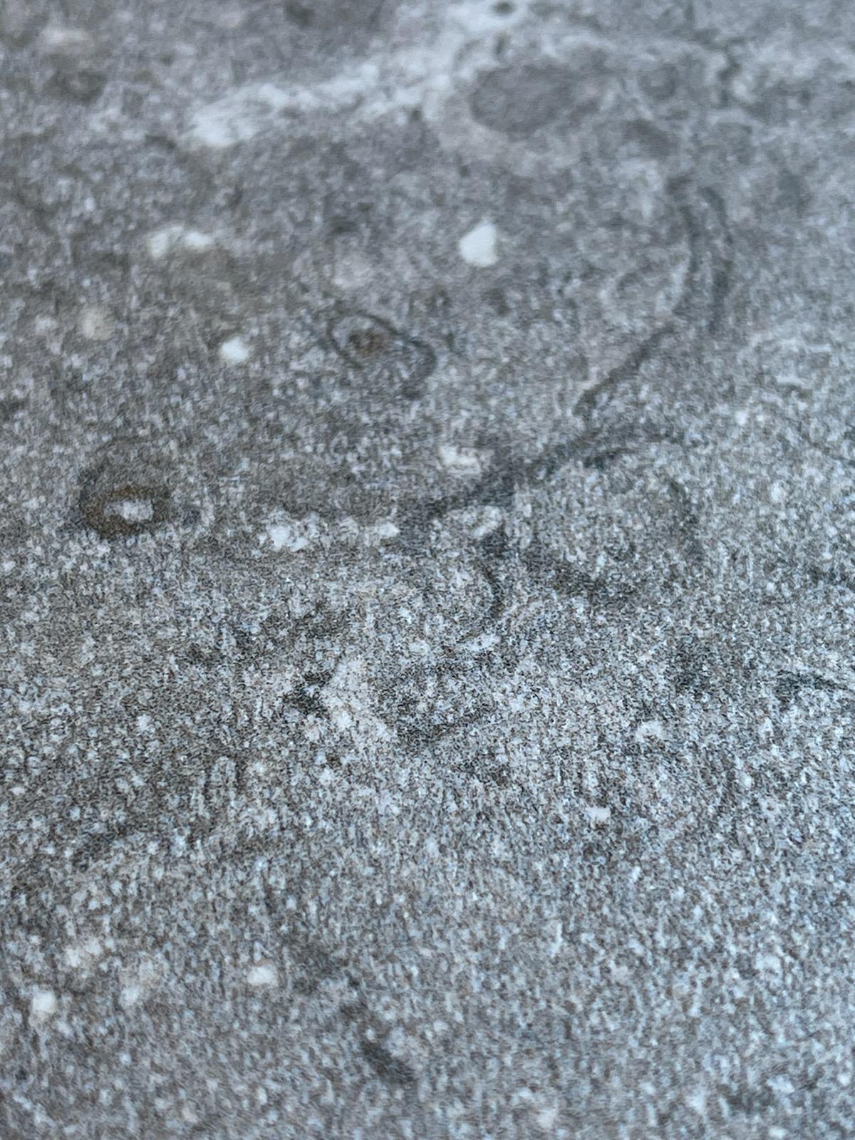

Yet another issue, this time with unglazed Porcelain..
It was a new floor that got sealed with Interlinks Viper Prestige water based sealer.
The cleaner used one of those blue wiffle ball bat applicators and didn't mop up or buff out the excess... IMG_20211016_134704.jpg
He tried cleaning it off with a spinner with no luck..
Sealing the whole floor ended up being the fixIMG_20211016_134729.jpgIMG_20211016_134736.jpg

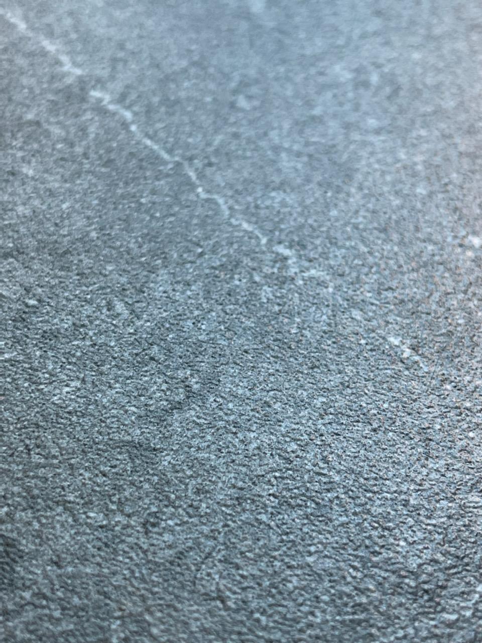

As mentioned, MBStone has created a fix for removing the splotches and light scratches from most every type of modern porcelain.
Small splotches can be removed by hand with just a hogs hair or white pad and a dap of crème, larger areas can be taken care of with a Makita or 175.
It's shocking at how little time is needed to erase the damage. If over worked, you can actually start to remove the glaze AND the photograph.
You and your customers NEED to understand that you are not restoring the glaze or making it more durable, you are simply feathering out the damage so that it's not seen by the human eye.

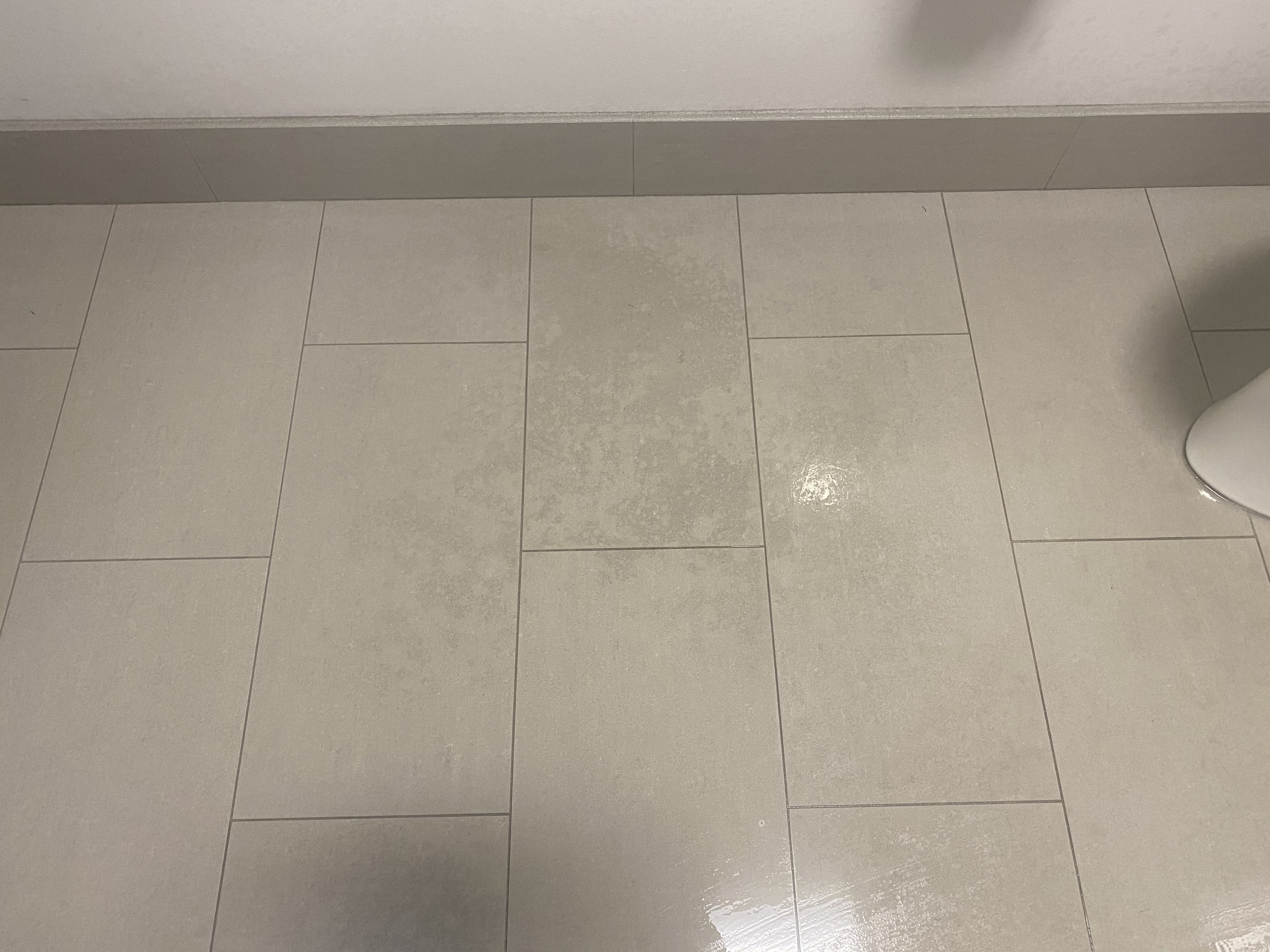

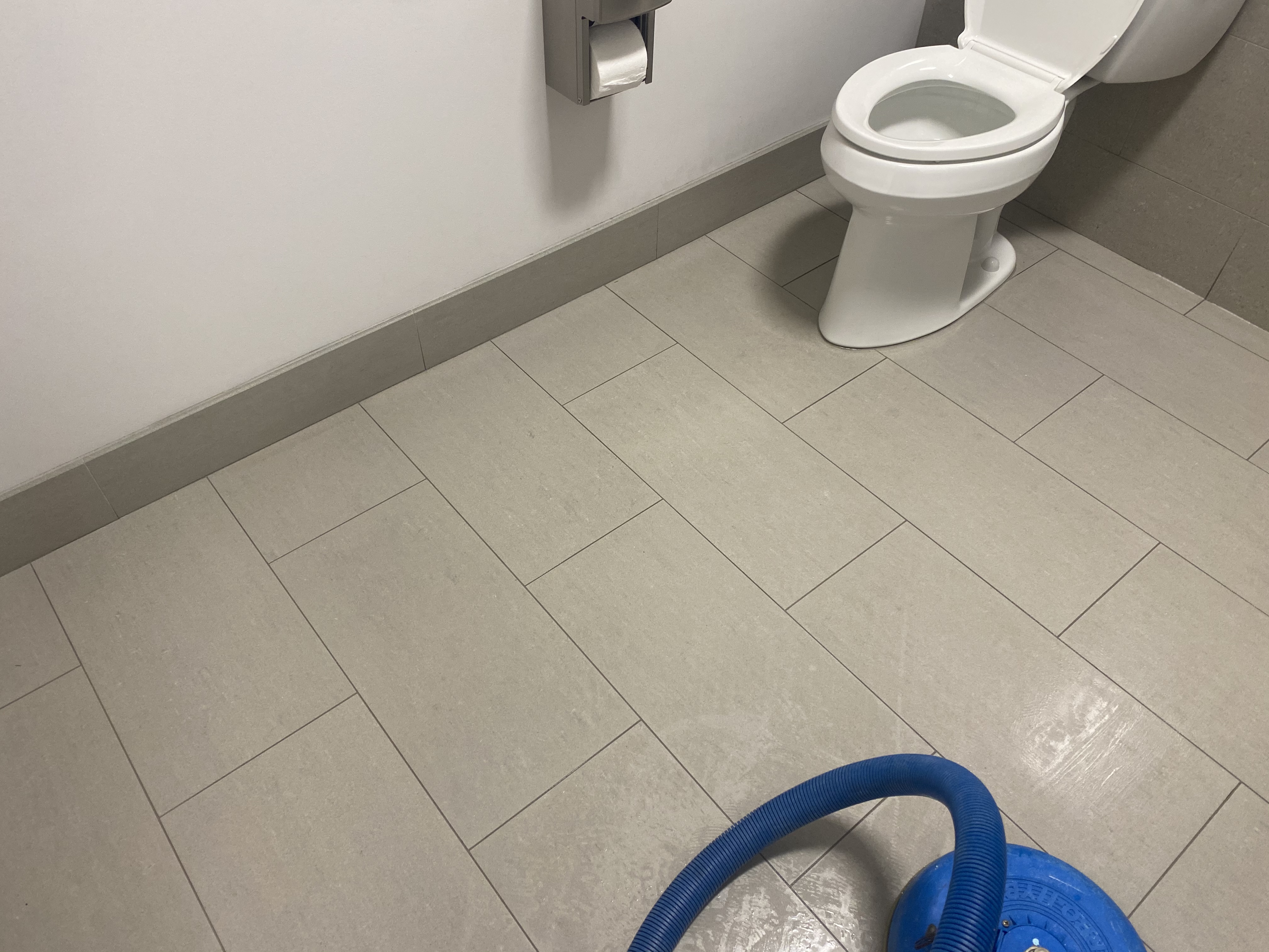

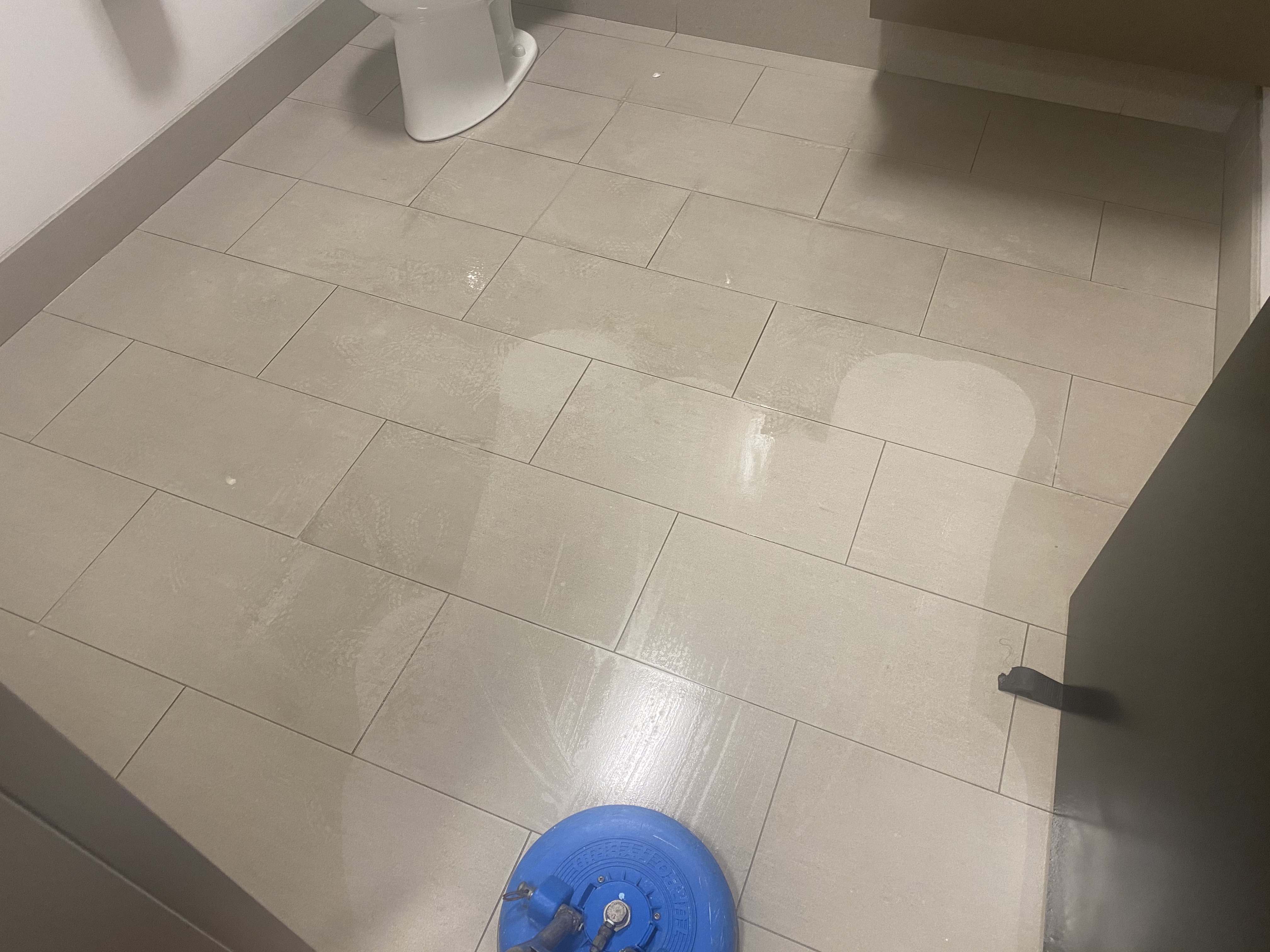

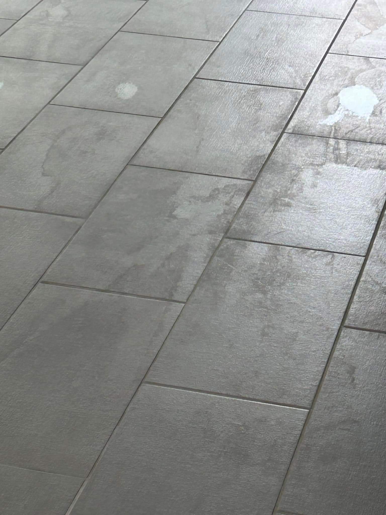

This was a commercial office with the same issue. The cleaning crew used something to clean and left spots all over. As you can see the cleaning was turning out great until I noticed the spots. I tested a portion with a neutral cleaner and it lifted up. You can see it most by the toilet.
7E2D09E3-1EB0-4891-ACD9-9639FB25787B.jpeg 5F299486-D0EF-4A8D-ACC1-6057123C8883.jpeg 0D7FFAB0-BE60-49AD-BB97-45DCAA4125F4.jpeg
