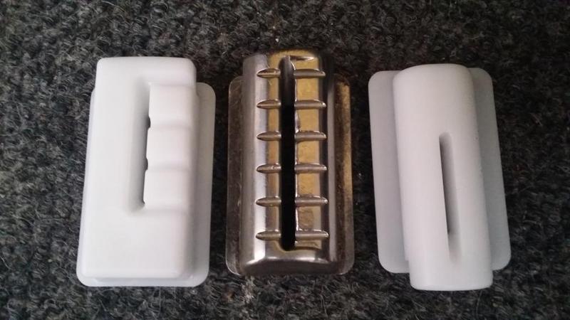

The new HOSS700 glides came in..
117,375

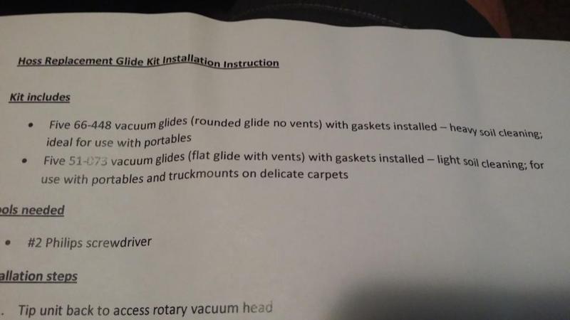

KS tells me that the flat option runs smoother than the stock shoe and cleans deeper so I'm not sure why the instructions recommend it for light soiling...?

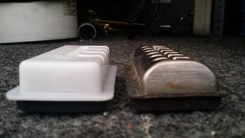

Haven't tried mine yet. The slots don't extend as far toward the edge of the turntable as the slots in the steel glides. And they aren't Teflon.

Don't even bother putting the rounded ones on.............not a good fit with your truck.........
The square flat ones rule......its a entire different machine..........

Used plastic glides on a couple jobs this am. Seems to glide smoother, less aggressive. Seemed to clean the same, but They weren't real dirty.

Dry time is better...machine float across carpet. .much eaiser to manage. ..you can get get closer to transitions with out having to worry about metal hitting them...

Cleaned a super-nasty this morning with the plastic glides. Surprised they cleaned as well as the steel and didn't seem to stretch/ deform the carpet as much as the steel glides.
