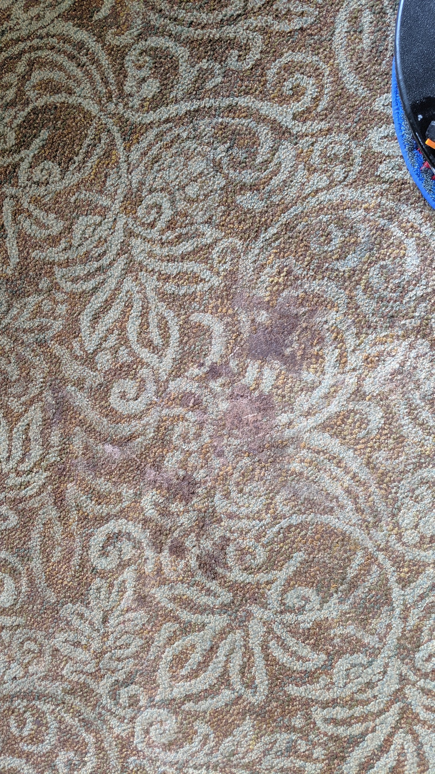

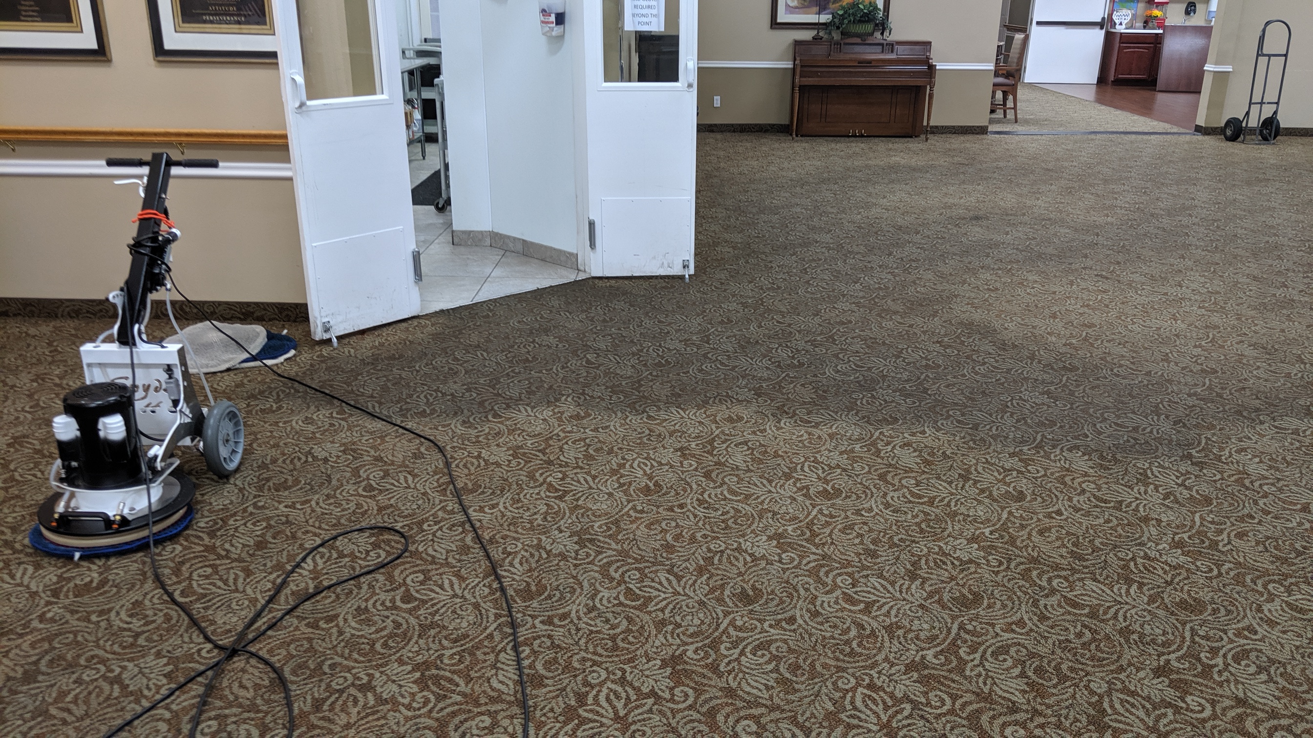

Testing 3 pixies tonight side by side

Did you mark the areas cleaned with which product to be able to track a difference in re-soling?
15,253
Impossible to follow up unless you are there every day.
Frequency of vacuuming and their technique.

This area was one quick pass with a MF pad.
