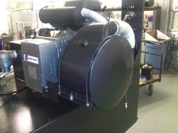

Here is a pic or two:

Is that a GD Tri-Lobe?
What model #?
How much lift you running?

Jeff, what the hell is that thing on the side
I have never been to get over not having a liquid cooled motor

Looks like a silencer for the blower :?:
B
Bob Foster
It's an awesome silencer. If you're standing next to the machine you can not hear any blower noise - NONE. Les had it specially designed for the unit.

What kind of relief vale is on there?

Bayco Valve.
As for Steve's request, a water cooled does potentially have more moving parts, and more things to go wrong, but I'm sure if you said pretty please Les might put a 28hp liquid cooled kohler on there for ya, Cu's Reactor has a 27hp LQ Briggs.
