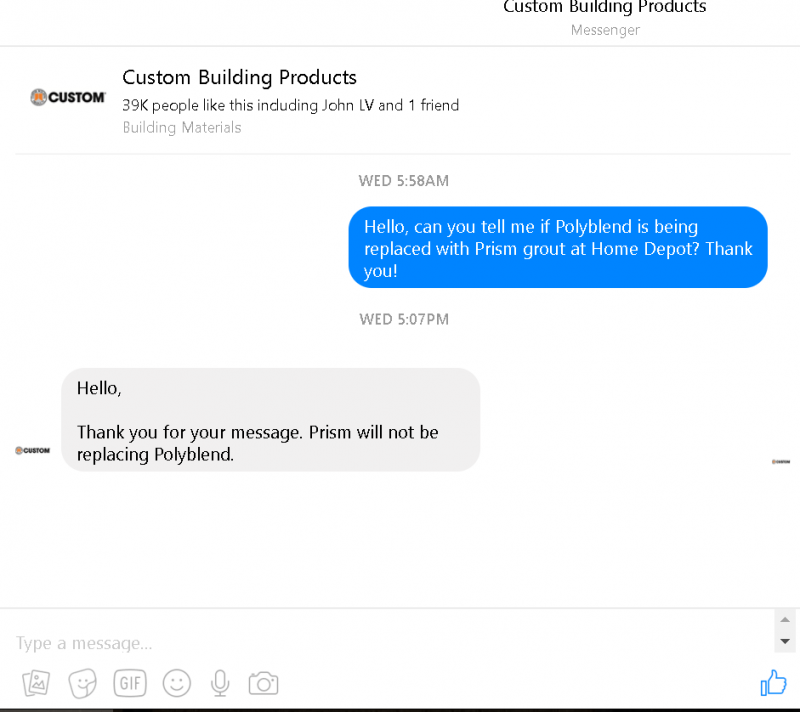

problem is that I know where this guy is going on this issue. I've dealt with it on other forums. He's posting information that is not true. Polyblend grout is available at Home Depots.
There's no intention of replacing it with Prism grout. I messaged Custom Building Product directly through facebook messenger where they confirmed what I have been saying.
