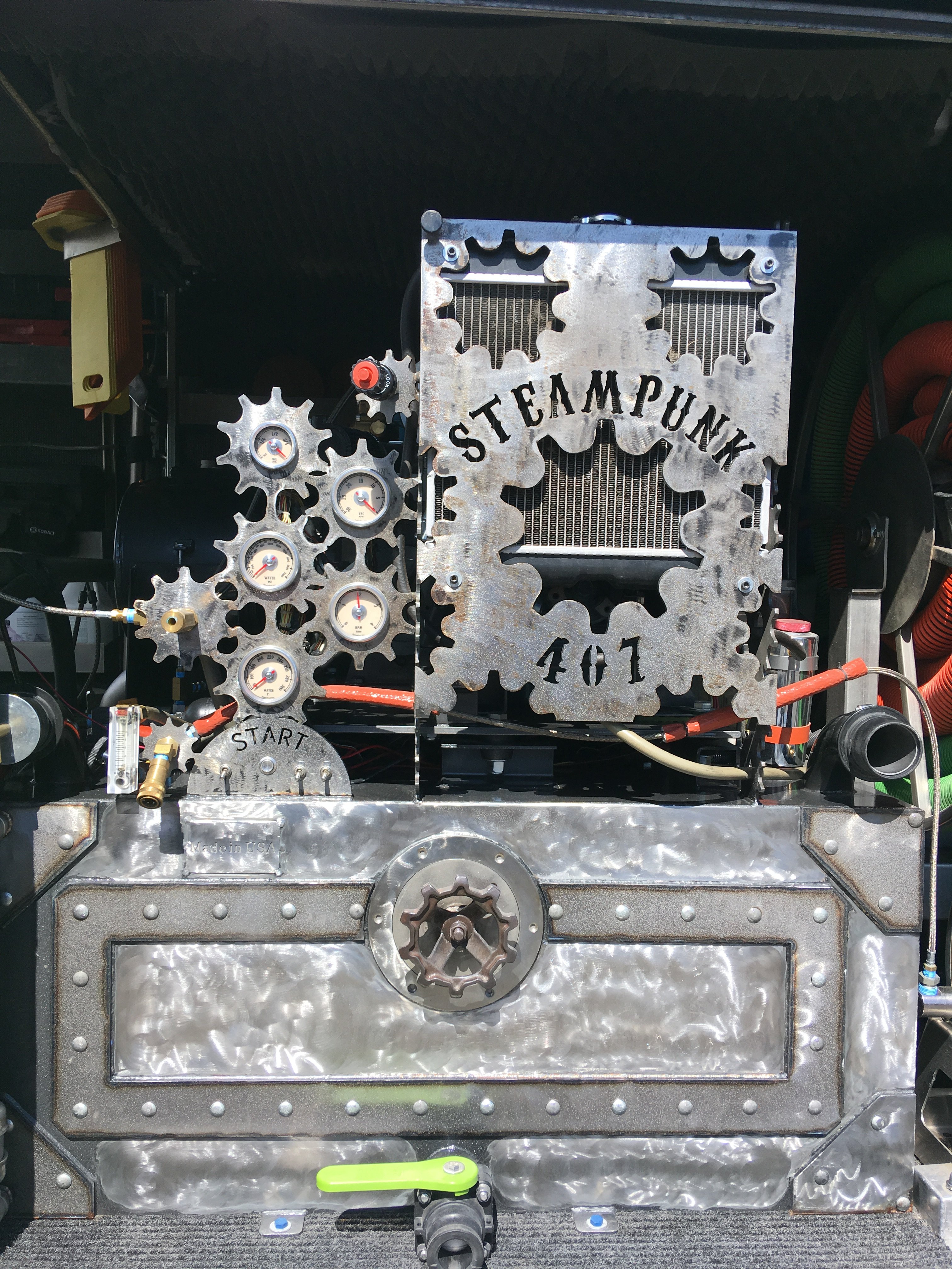

From what little I know you also have a Judson.
How much different from your Judson is this?
Am I guessing right that is a 40 horse motor with a #7 blower?
When using just one wand at 150 feet what rpm are you running the motor at?
Any idea what it weighs without water in it?

Rick, I sold my Judson. It was a good machine though. The Steam Punk has a 32 hp Kubota engine and a 47 blower. I run it at 2800 rpm's no matter how much hose I'm running. I run almost all 2.5" hose so I have plenty of suction. Im not sure I've heard of any machines that run an #7 blower.
Mike Draper
Jan 13, 2008
4,402
I dont know the weight of this machine. It does the same thing as the judson, but has a few more nice features. Decline in tank for faster dumping, last step injection, sight tube for waste tank and 205 gallon waste capacity. Blower pre filters. Kubota engine.

Guess he’s not starting a manufacturing business for these?
I think Mike did say it would cost that to build it. However he said he would do it again.
He still loves his machine.

Hello, hello. So my machine cost me $24,500 in parts and took 8 months to build. Will I ever build another like it? No, because this one will last me until i retire. No hiccups or breakdowns on it (other than Kubota has shit mufflers so I had to build my own). Runs perfect like the first day it started. Maybe I’ll try and post a pic later. I only run ethanol free fuel in it, which makes a big difference.

Here’s a recent pic. 1,600ish hours
