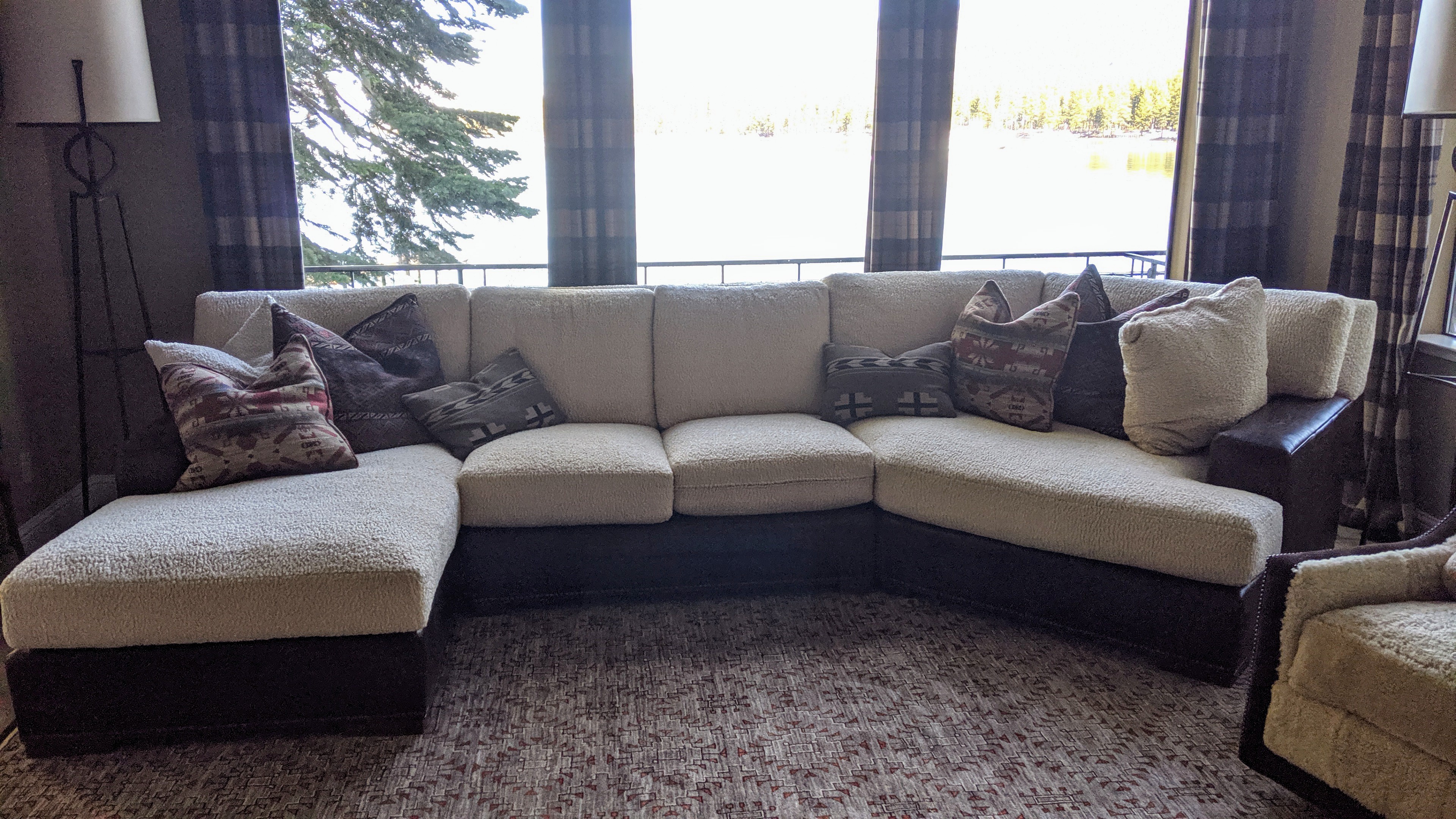

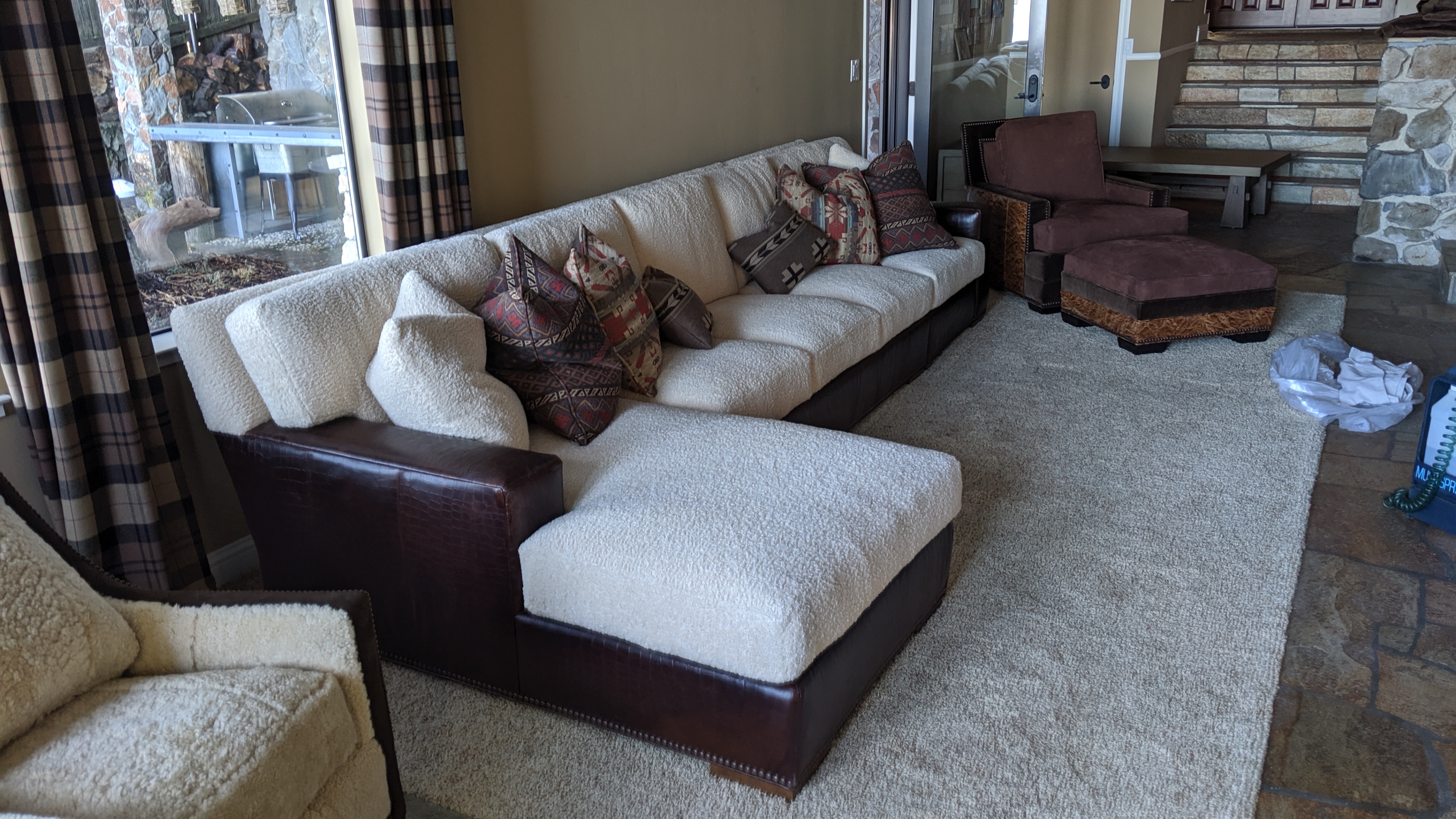

I left a huge mess with the 25 or 30 pillows all over the place yesterday on my big Fiber Protector job.. I told the house manager that the most important part in putting it all back together was to make sure that the creases are were left just as the interior decorator left them
28,277
View attachment 95422View attachment 95423
I once did a job in a show suite for a realtor. When I was done cleaning a large sectional with about 10 loose throw cushions, the realtor asked if I knew how they were originally arranged. When I said no, she said she would arrange for the designer to come back to set them up properly. I missed my calling, I should have been a cushion arranger.
