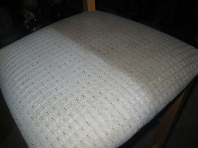

I've been running slurry(1/2 sug.) for carpet and uph. rinse for the last 2 months and haven't had a problem yet.. I went through the iicrc class for uph. I was taught that an acid rinse was the only way to go. Since switching to the slurry I've noticed that everything cleans up way better in less time. :? I have never personally seen color bleeding and have never had anything brown on me, so have I just been lucky? Anyone have any good picks of color bleeding on uph.? I would like to see what they look like..
Here's one(actually 6 chairs) I did today.. At least ten years old never cleaned. :D

if all your furn is fabric like that chair, slurry won't hurt it.
As mentioned, its the finer fabrics where you'll run into challenges
