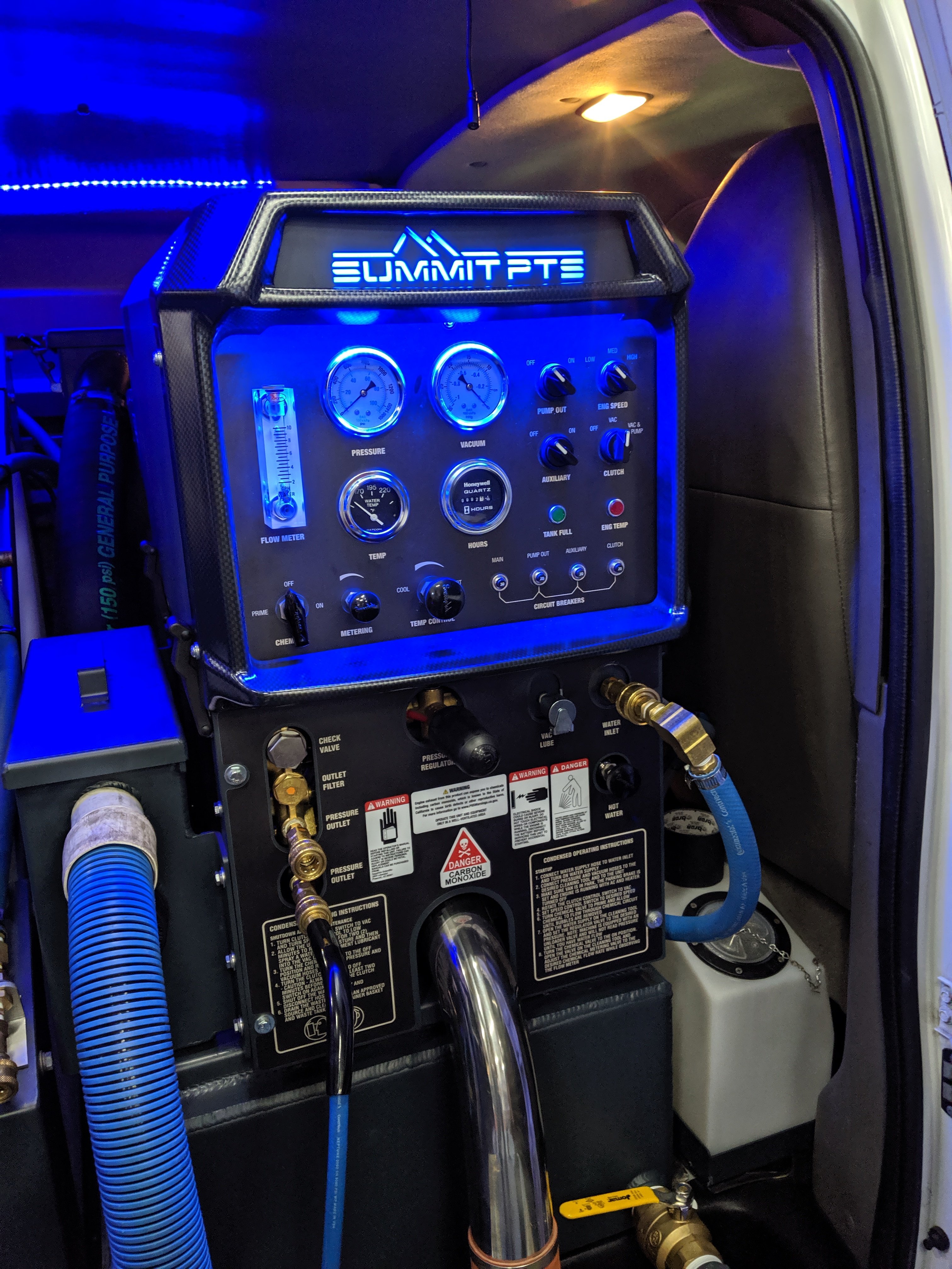

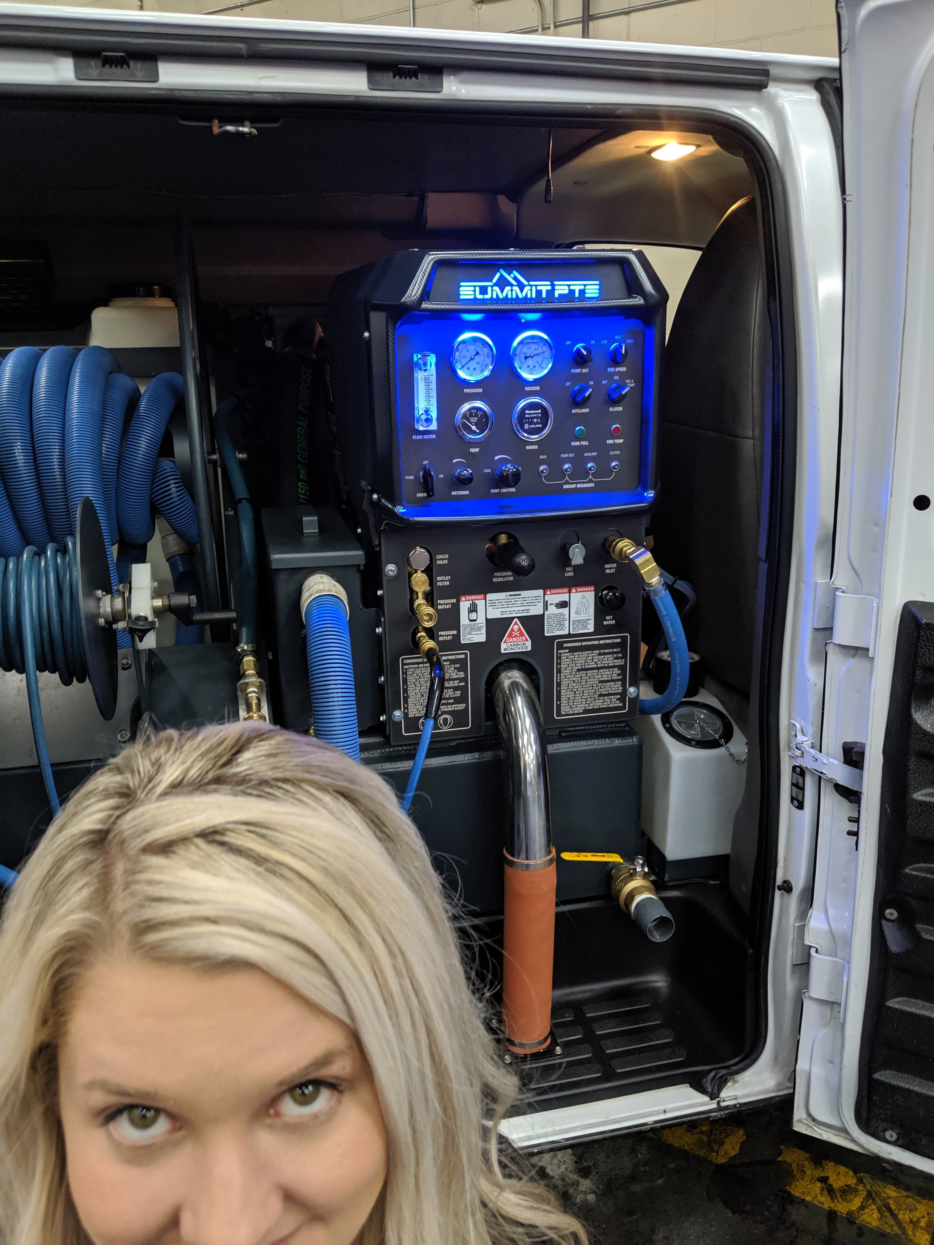

Sapphire Pro 1200 becomes the Summit PTS

Their "fix" for the heat issues is a direct driven flex fan, no clutch. I'm installing the first one tomorrow but I worry it will be loud as took with the fan running at the same speed as the engine...

They haven’t changed the blower exhaust either

I have it on good authority that very little was changed except the cooling fan added to the van, and the cerakote on the exhaust. They can keep em

The PTS IS the pro1200se, Finkle is Einhorn... They updated the look and made a couple small tweaks and that was it. The hood up in the promo video is the most damning evidence
