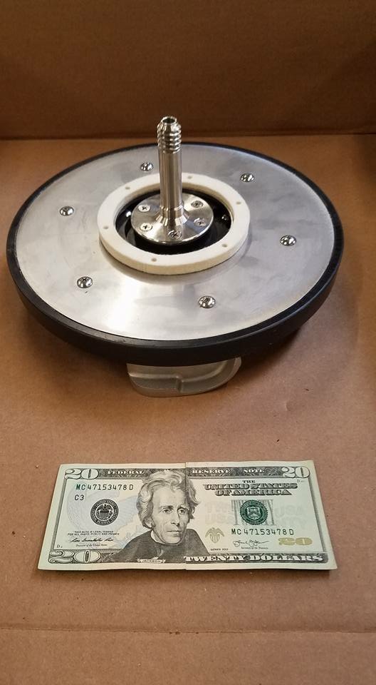

So today Rotovac has launched a new 10” cleaning head for 360 and 360i. It delivers better performance than standard heads on troublesome jobs. Also suits stair cleaning. $395 and available now.

I do them with the tool laying down flat and with the handle bars at shoulder height and then when I get to the bottom I stand the tool up.
Rotovac have specified its a stair cleaning and general problem solving tool.
Why would that perform better than the stock 3 port head?
Well. My best performing tool is my upholstery tool. Why?
All the power and heat inside such a confined space. So the smaller we go, to more we confine our forces.

What I did was..
Left the telescoping handles very short. Lay the machine out flat. Removed the plastic dome. Reinstalled the carry handle.
Sprayed stairs with HF coming down. Wanded risers going up. Put 360i on and cleanes treads coming down (machive was at the top of the stairs).
It was pretty quick as risers aren’t typically dirty. The treads were realky filthy it saved time and sweat.
I think my new wand will be better for tgis task.
With the machine is so short; it was easy to slide my hands down the frame and lift the unit down to the nexr step
Wanding is tiring, machining generally isn’t.

I have 2 RVStairPros dedicated for stair cleaning. They use the 7" cleaning heads. I have extra cleaning heads choked down to 1 jet each, jet sizing .05/1.0/1.5/2.0/ &3.0 set up and interchangeable in seconds to meet most cleaning challenges.
I can contour right over the bull nosing to clean, then cuff them. Really soiled nosing, I break out the Kleenright hand piece to flush sideways, and do risers.
That cleaning head as pictured would not be capable of cleaning over the nosing as it does not have the ss 'puck' that fits to the distribution chamber.
Hopefully the production heads will come with the puck installed.

I use my quad 360i on stairs all the time. It makes quick easy work of heavily soil and worn steps.
I find the size is usually just right. Maybe a little overspray on the next step down if steps are a little narrow, but the nose seems to clean well.
Yes, I do go back over the steps with a stair tool to get the edges and risers, but that takes little time after the tough soil had been eliminated.
Just shorten the arm and lower it most of the way and the 360 becomes a dandy little stair tool. The Quad works well on stairs. However, I have never used a triple so I can’t tell you if it is as easy and effective or not. I have used the two head power wand on stairs, but I prefer using the 360i for steps.
I seem to have found a way to just slide the Rotovac down to the next step so there is no jolting to cause it damage.
