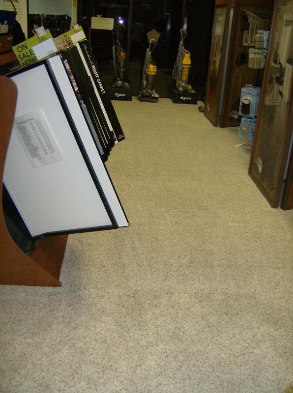

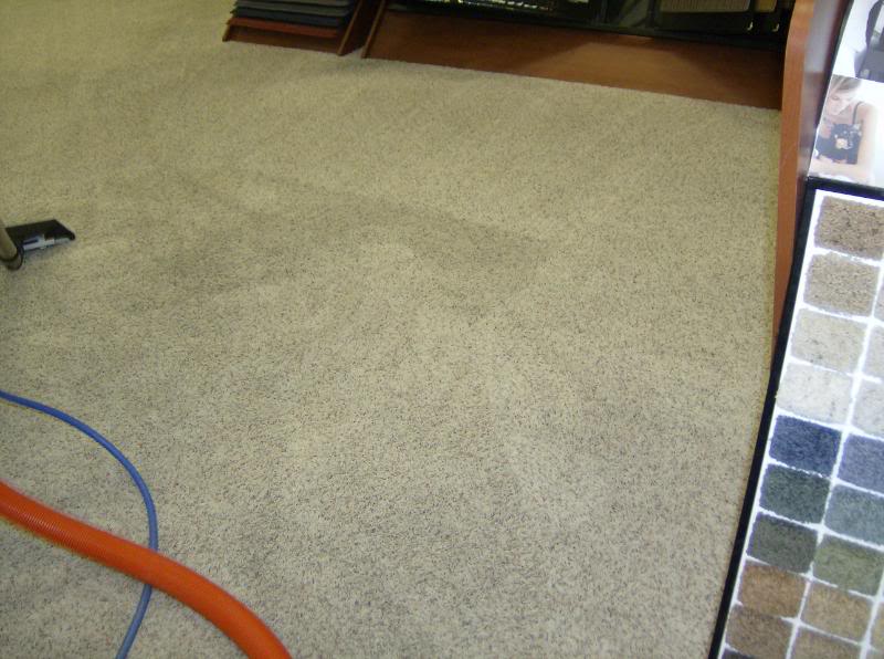

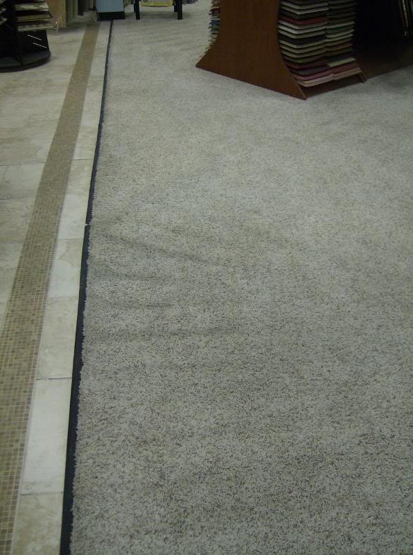

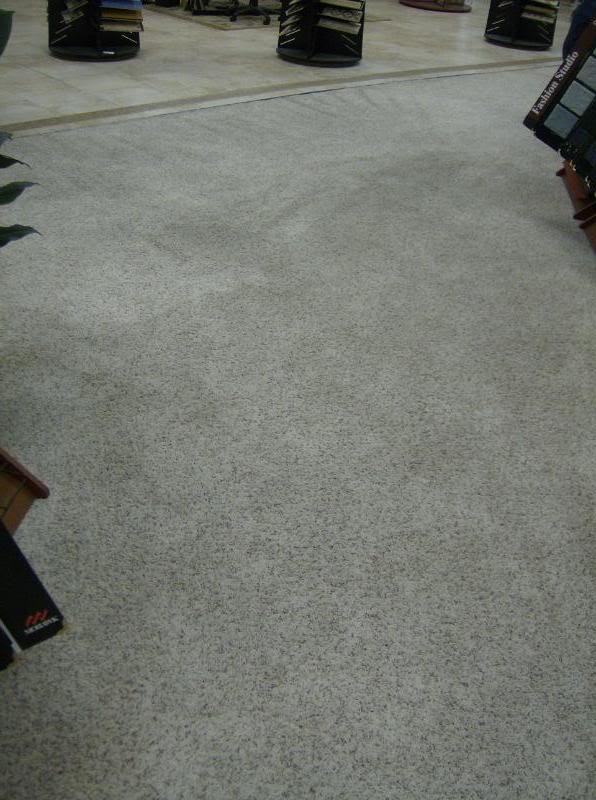

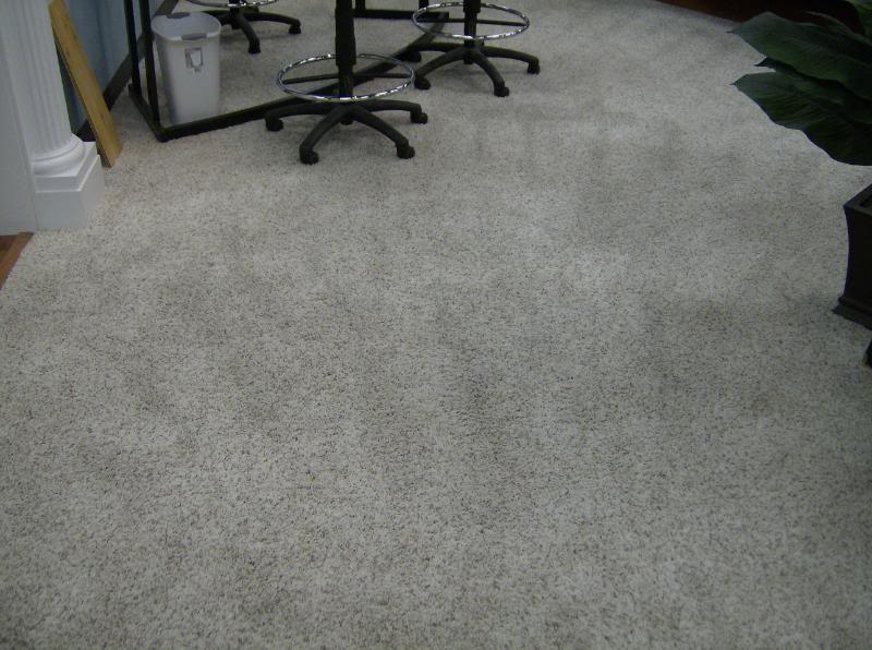

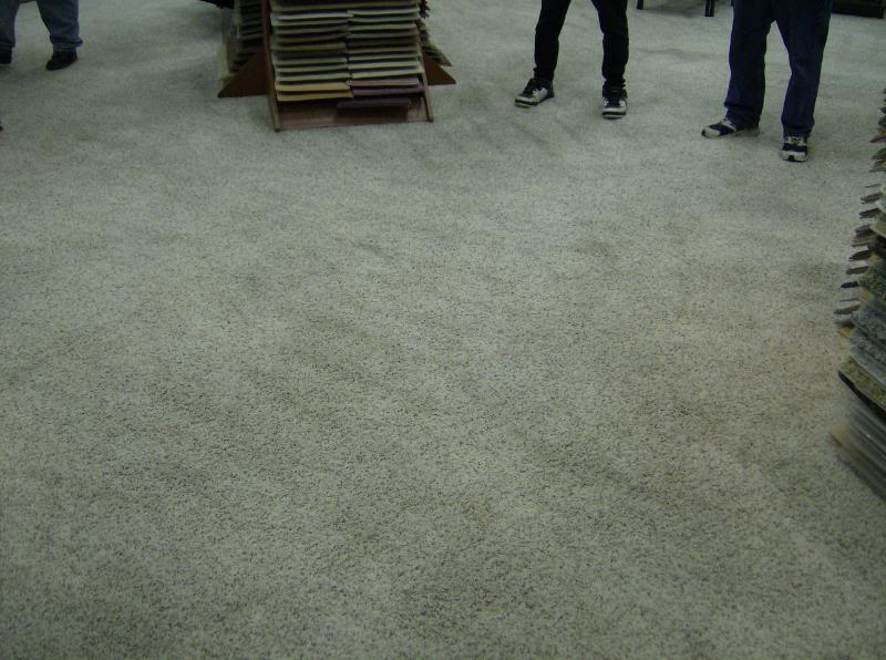

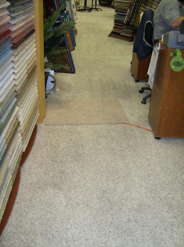

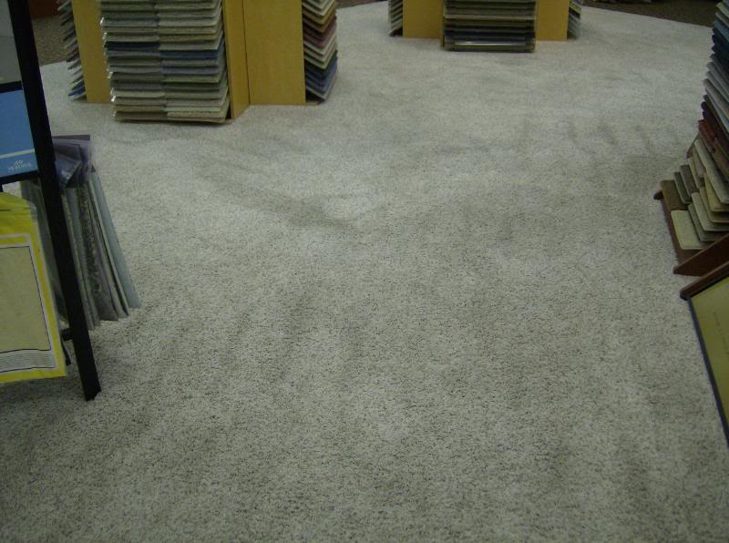

this is a huge local retailer that referrs tons fo work to us. he had someone come in a few weeks ago begging for referrals and was asking to be put in line 2nd to us. the owner told him he had to clean something in the showroom to prove what he could do..well the guy was bragging about how awesome his equipment was and how he was going to blow away what i could do..he told the guy that he could out clean us blah blah blah..
well this disaster took him 6 hrs to clean and almost 24 hrs to dry..i get a call from the owner asking me to come fix it..
question..would you have charged him to fix it or done it for free.
it took us 2 hrs and was dry when we left.
i didnt get good after shots because they turned off the lights while we were packing up he truck but all the streaking was gone and everything was sweet looking..
of the cleaning
we used powermax from cobb mixed at 4oz per gallon..layed down hot and about 10 mins dwell time

Hey Dave, I don't own a 360, so I don't have a dog in this fight, but how much of those results are equipment and how much is a lousy carpet cleaner. Sometimes I see jobs that were cleaned with great equip. and they don't come out good because the techs no good, just a thought.

Why does that look more like the original powerwand and not the 360 to me? did you mean to type rotovac powerwand but 360 was stuck in your head?
Could be too much powermax.

that could be it..i dont know enough about them to do anything other than aggravate people..
i just know the job sucked and after i was thrown under the bus..how dare he.
i would have to say that this is 90% user sucks over the equip sucking..but i am sure any somewhat new tech would do this and that to me makes the equip suck..

I have a 360 and yes, it will leave streaks like that if you hall ass and do a shit job. Only on certain types of carpet though. SO, that is something I don't like about it, however, if you hall ass on dirty carpet just about anything will look like crap when your done. TO tell you the truth, the more I use my greenhorn, the more I move away from the 360.

I have a 360 and love it. used it yesterday on 1400 sq. ft. in a high end home with very dirty white carpet. Used Judson juice mixed 2 oz. per gallon and got awesome results. It looked brand spanking new when I was done. The homeowners were elated and said it was way cleaner than they had expected. They went next door and bragged to the neighbors.
Those streaks are because the hack that was operating the 360 did not overlap the strokes. Somebody was in a hurry. It's just like bonnet cleaning, all the carpet needs to be cleaned evenly and dry stroked. There is a learning curve with the 360 and evidently that cleaner has not mastered it yet.
The 360 adds aggitation which takes it to a new level of clean. Yes you can get aggitation with other tools and then wand it, but doing both at the same time is easier. I also find myself doing very little post spotting after using the 360.

Looks like the guy was going forward and backward instead of going left to right and not overlapping and not doing a dry pass. I use my 360 daily and the results look nothing like that, the person who did that had no clue what he was doing.

The operator fooked that job up not the machine..even a dork in a vortex can do a shhhheeeetyyy job...
looks like an old rotovac job not a 360.

i dont think it was a 360.you can see the streak in between the two wheels of the original roto.

actually it was kind of a pain in the ass..he loaded it up with so much powder deodorizer it was crazy.
i sense some sarcasm in your question or am i reading too much into it?
mikey they told me he sprayed something down then started throwing out powdered deodorizer then cleaned it..it was still wet the next day so the day after that they ran a dyson over it and filled the dust cup 5 times..i vacuumed it with my 887 and filled it with powder also..dont know why he used so much or what it really was.
