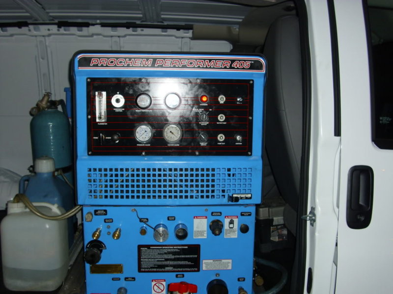

Besides picking this up
In 2011 for $9500 cash
