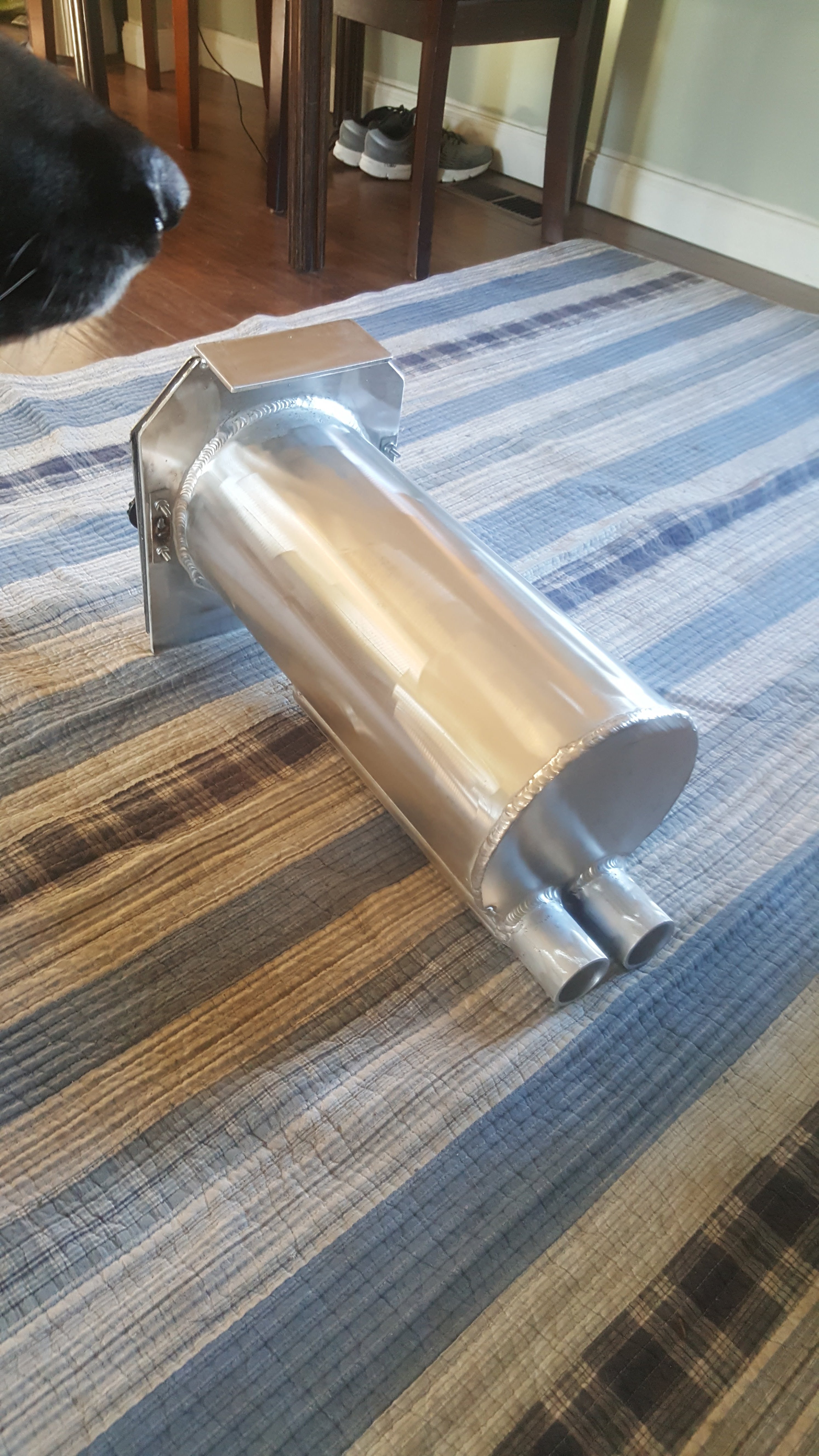

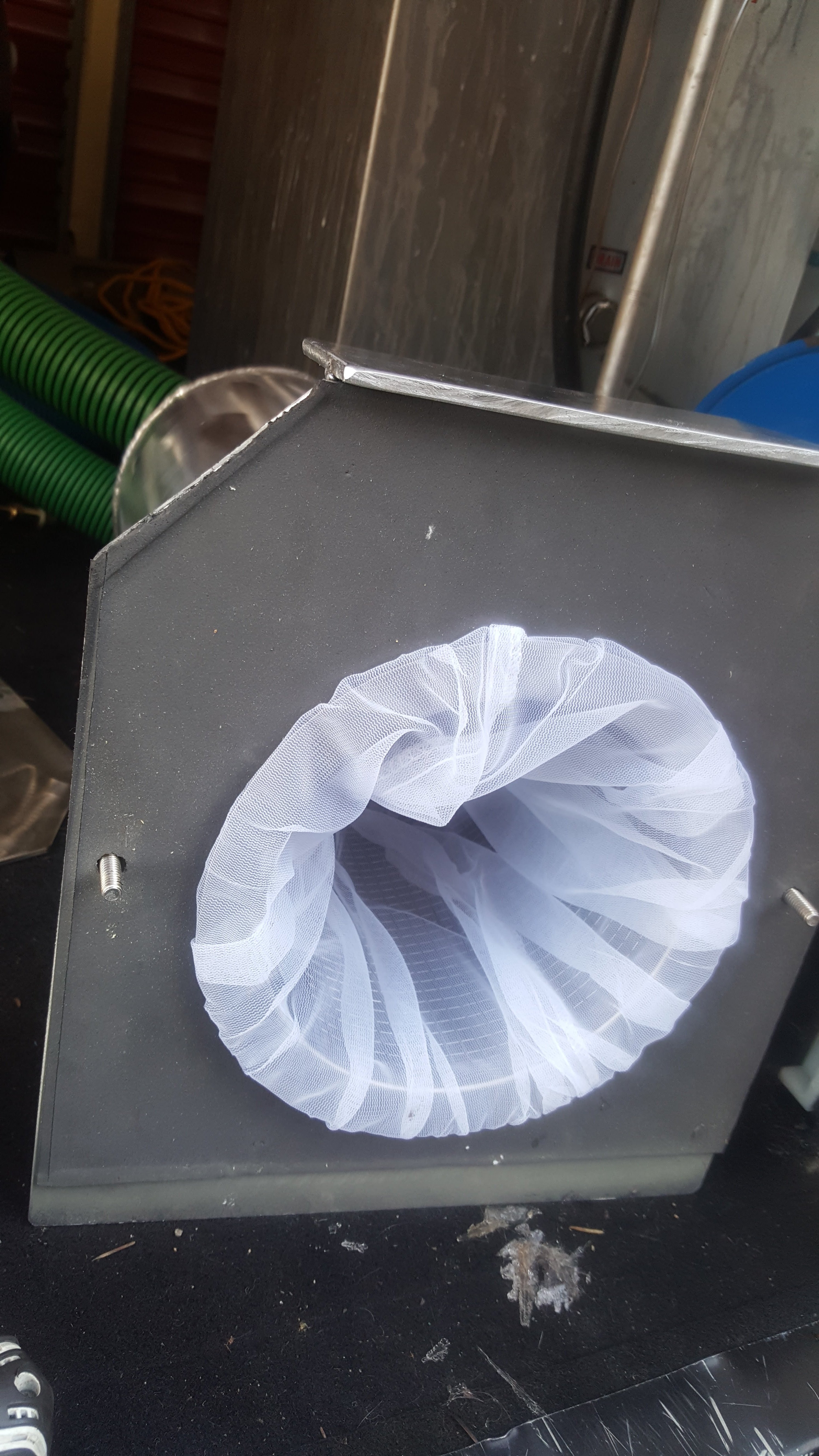

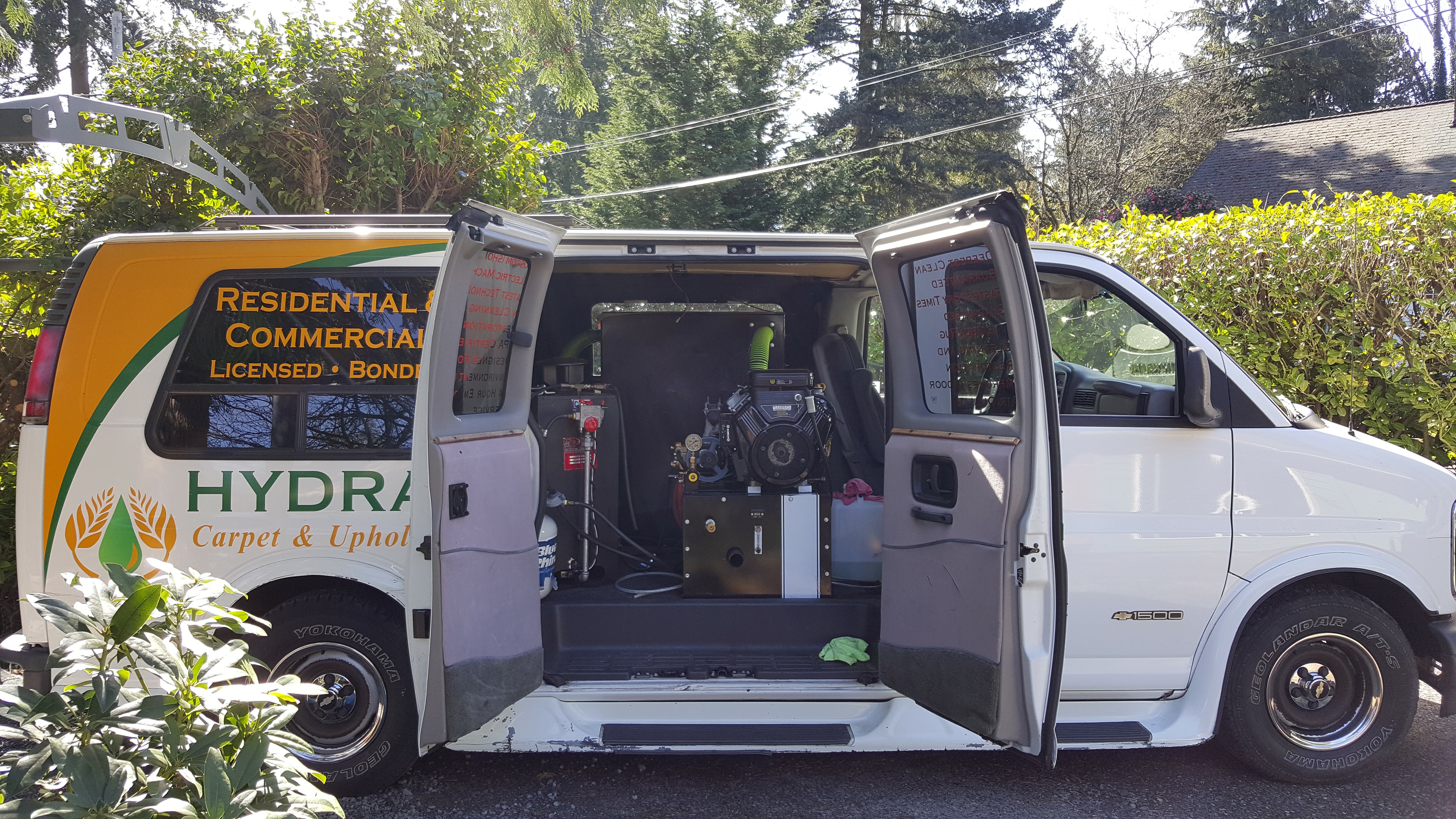

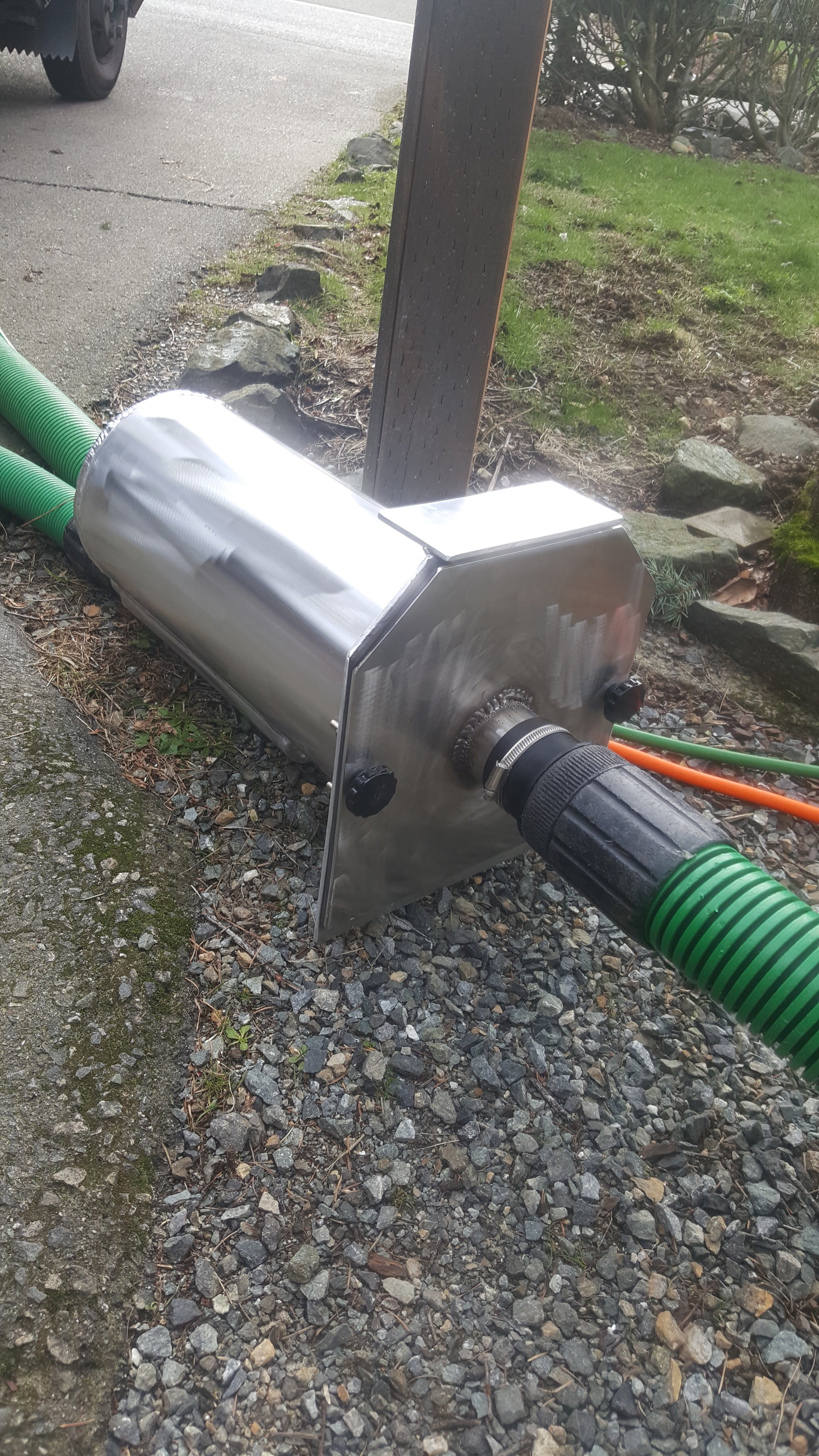

found an old one from when we still had it mounted in our express, its in an NV3500 nissan now... ill try and get some better pics lol Heres the filter cant remember what he calls it, nice design though.
20160317_141625.jpg 20180212_100801 (1).jpg 20180212_102353.jpg 20180213_113718.jpg
View attachment 86294View attachment 86301View attachment 86304View attachment 86305
Looks decent. I hope in your new set up, you've moved the lg heater further into the van. A good gust of wind will blow out your pilot light. I have mine against the far wall in the van. Haven't lost heat yet.

ya its a little further in on the nissan now but still near the door so you dont have to climb in to light it, have only had issues when its really really windy
