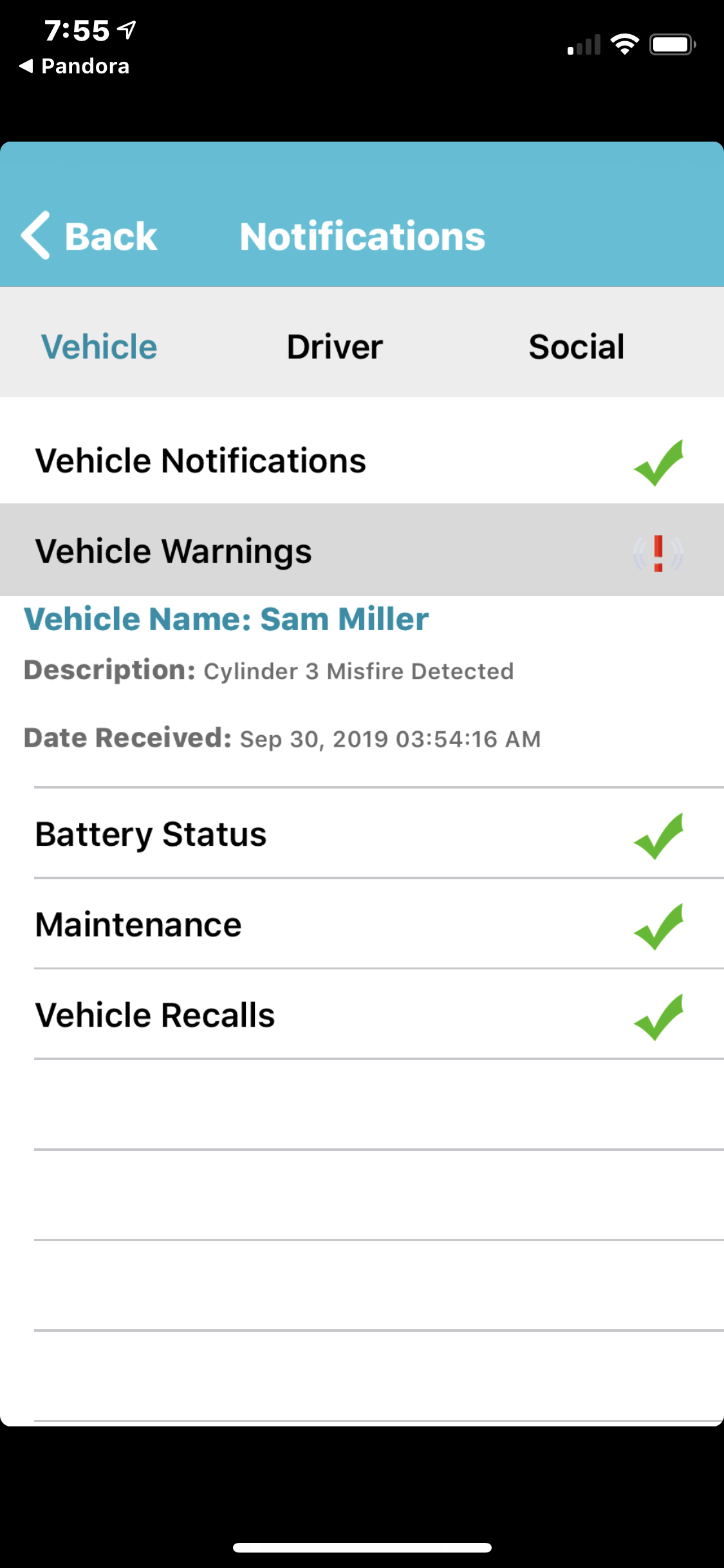

Originally it was cylinder #5 misfire now it’s #3 misfire
That’s the code my Vyncs gps device came up with
98861E0B-6449-48DE-9F83-1BCA528429E3.png 5D310EA2-84F0-4D7A-BDFB-9C1E44911B2C.jpeg
11,297
Put on the one wire for today reset computer and it runs good $40 cash for my mechanic to help me replace it
