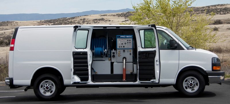

The Pro 1200 SE is not loud. Its the vacuum port that's loud as hell if you run it up with no hose on it.

The most frequent maintenance on a machine is cleaning out the waste tank. With the Pro1200 se how are you supposed to get in and rinse out that recovery tank? It all looks great when new, but what will it be like after a couple of thousand hours on the unit?

Devastator filter. My tank looks beautiful after 700 hours.

I believe you have an 870 with a different recovery tank. The Pro 1200 se is L shaped sitting under the machine. The section under the machine is what would be hard to get to. Devastator helps tremendously but eventually you will need to clean out the tank, if nothing else from sand build up.

Hmmm. Maybe a little spinner spray thing like they use on RV black water tanks.

The pro 1200 has an annoying drone on low speed, that you can hear inside the house, otherwise it's comparable to my 4.8 cds
