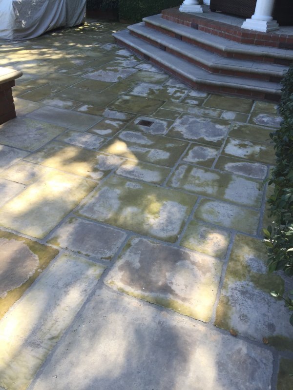

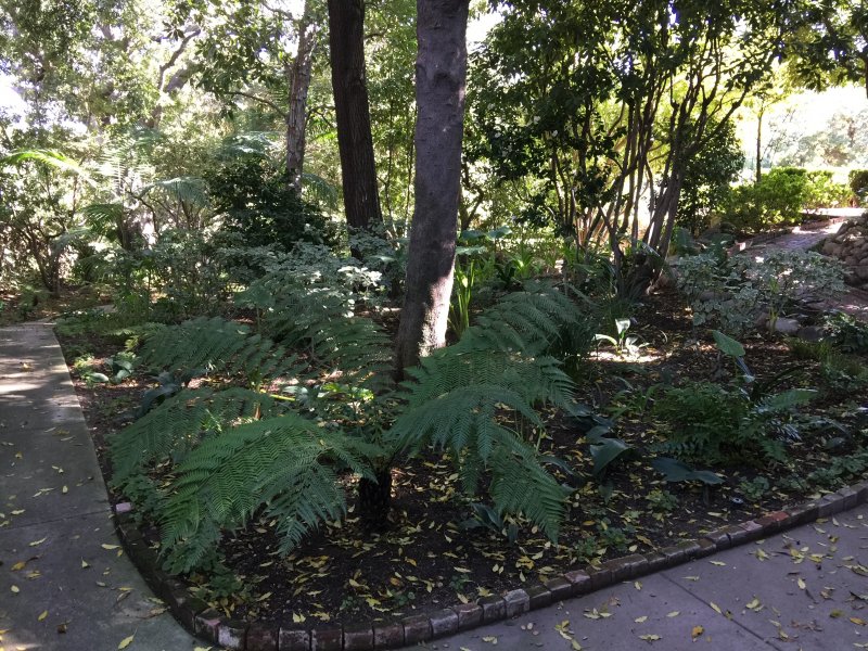

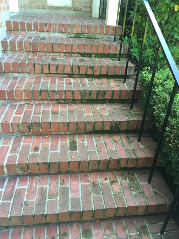

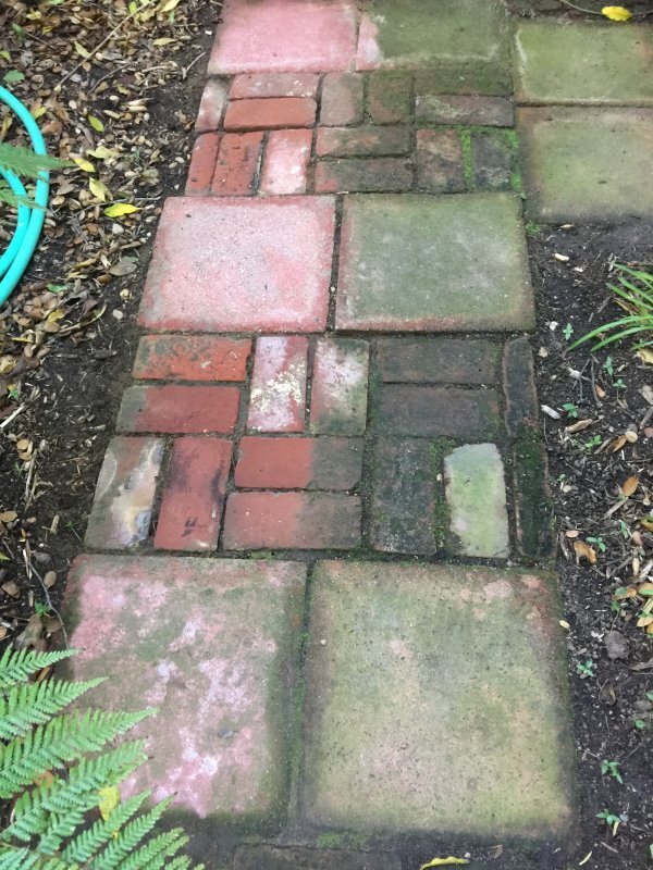

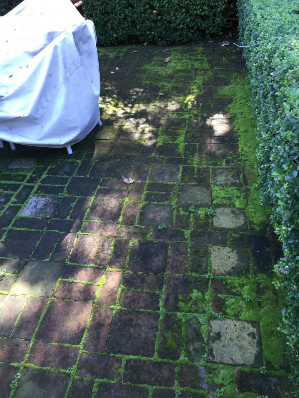

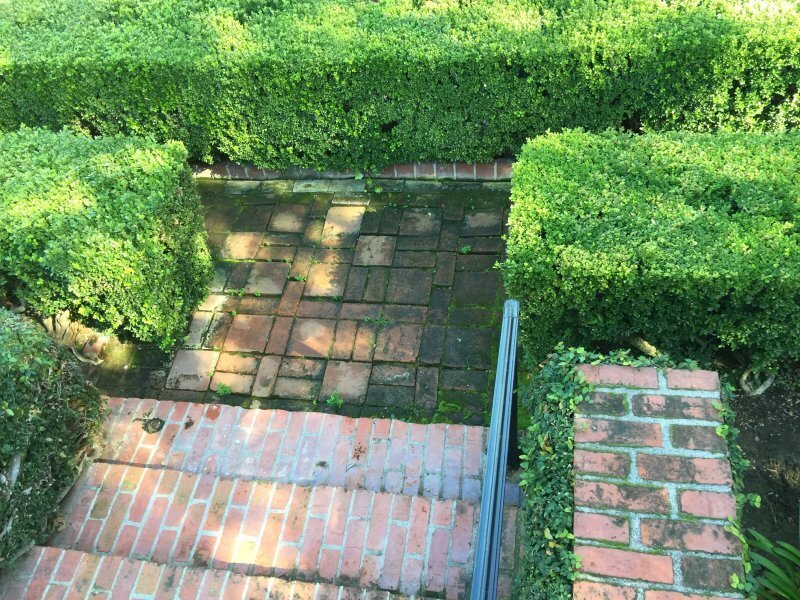

Pressure washing is a quick fix but I am looking for more, I want to kill & slow down the moss\mold growth as much as possible so the areas look great year round, customers exact words are "I want it looking perfect everyday" so cost of product is not a concern, my plan is to treat the areas a couple of times for a few weeks then 175 scrub followed by pressure wash. Looking for suggestions.
1. 50% Bleach\water
2. 50% Bleach\water+trisodium phosphate
3. http://www.mossout.com/walk.htm
4.???

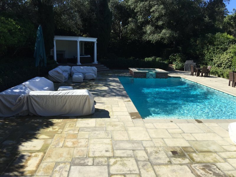

Visiting isn't the issue, I am there once a week "maintaing" the interior...she has been a client for 19 years so I know what she expects & will be satisfied with.
Pressure washing has risks associated that I would like to avoid, blowing out mortar & streaking just to name a few.
I could test a few products in the lower Rose Garden, I doubt they have stepped foot down there in years & its pretty bad.

D/2 looks perfect for small areas but at 300 sqft coverage per gallon I will need at least 1 drum at $1760.00

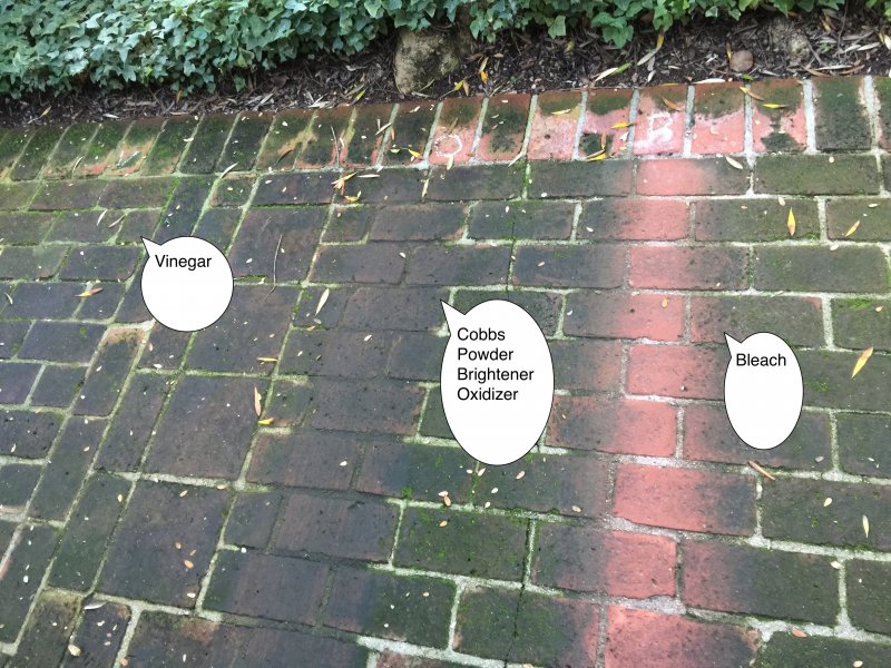

I grabbed some bleach & white vinegar on my way out this morning & had some of Cobbs Powder Brightener Oxidizer to try, sprayed all 3, gave 15 minutes of dwell & then scrubbed, vinegar did nada, Oxidizer fizzed but the bleach was the clear winner (did not rinse, wanted to leave overnight for further observation)

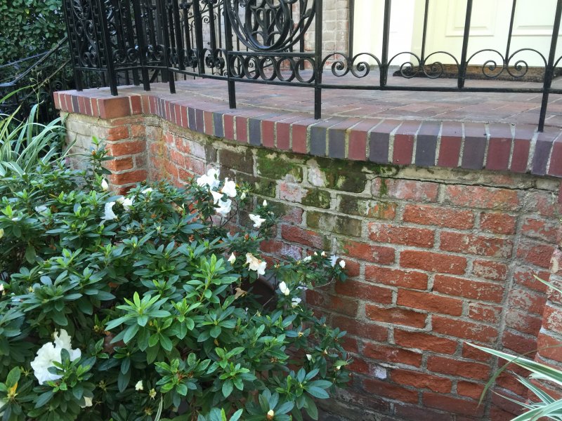

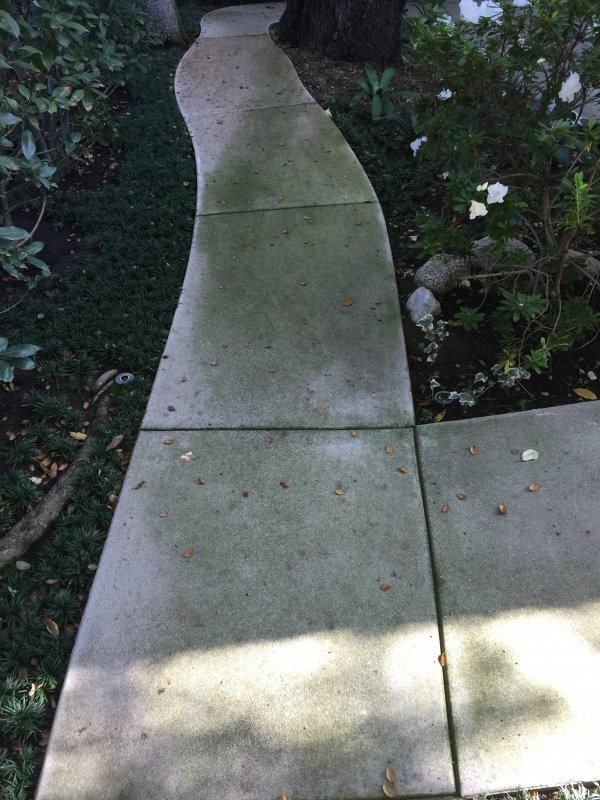

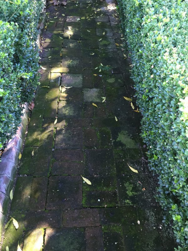

More areas (Client has had pressure washer issues in the past & warned against streaks & damage so cant just blast it away)

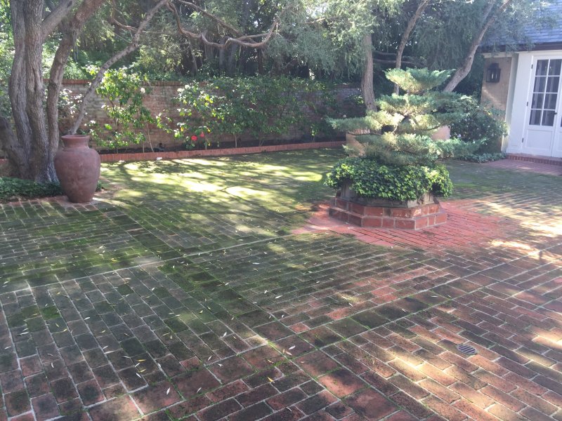

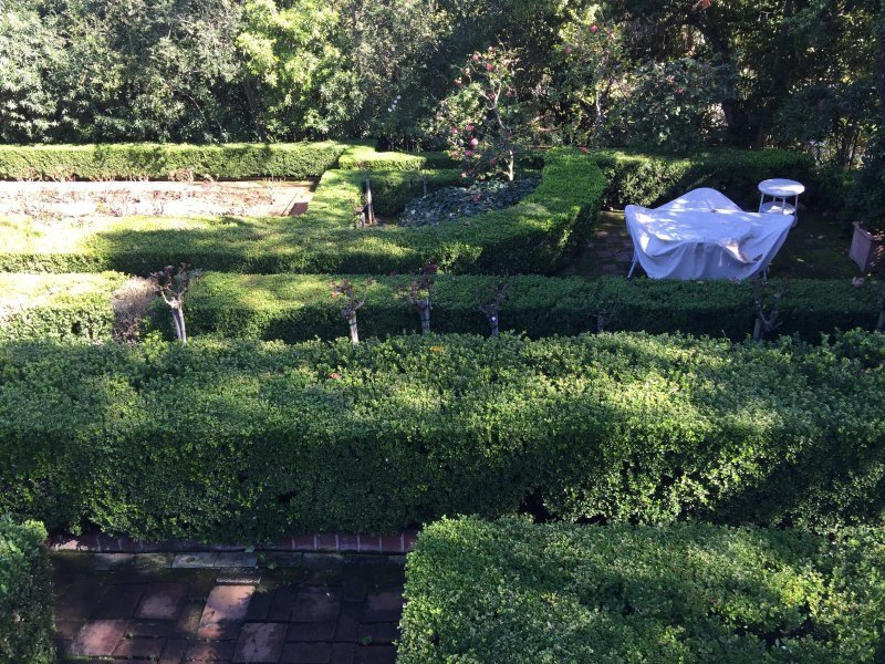

A few more pictures I took today of "Mossvilla"

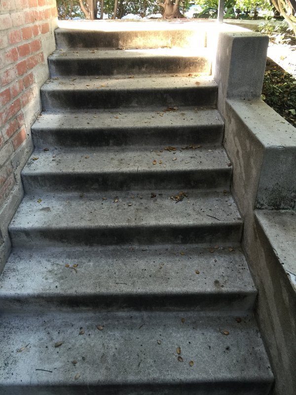

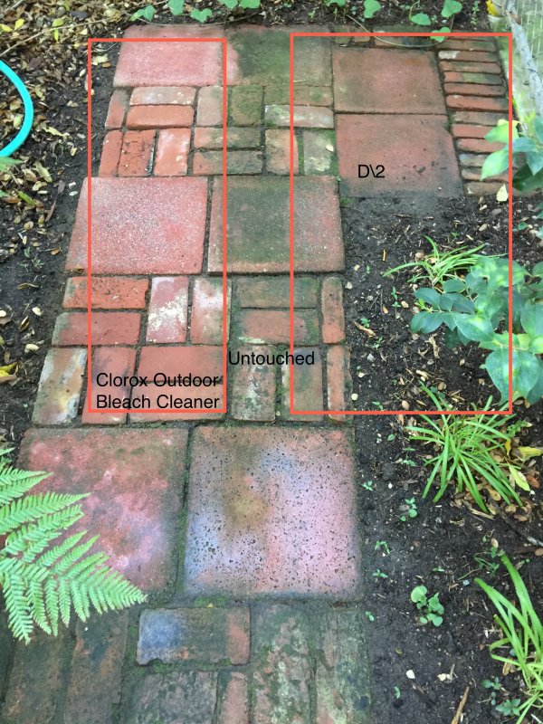

I did a quick side by test, Clorox Outdoor Bleach Cleaner on the left & D\2 on the right (middle kind of untouched) (Clorox was 50 % water dilution)
Spray-15 minute dwell-nylon broom scrub, rinse off.
If appearance & cost were the deciding factors Clorox would be the clear winner, I assume D\2 will do a better job "killing" the bacteria-fungazide & might slow down regrowth but at what cost?
More testing of d\2 next week, thanks Cameron for everything!

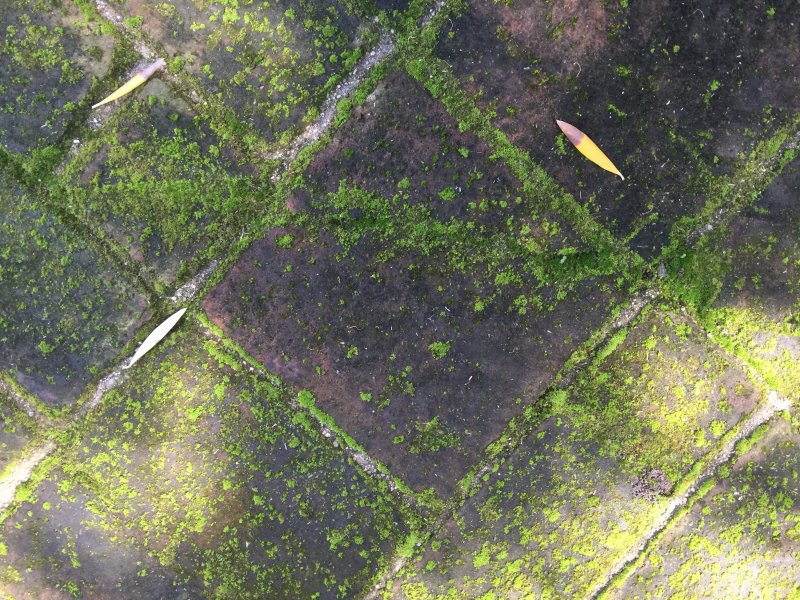

A better right side before picture if anyone cares
