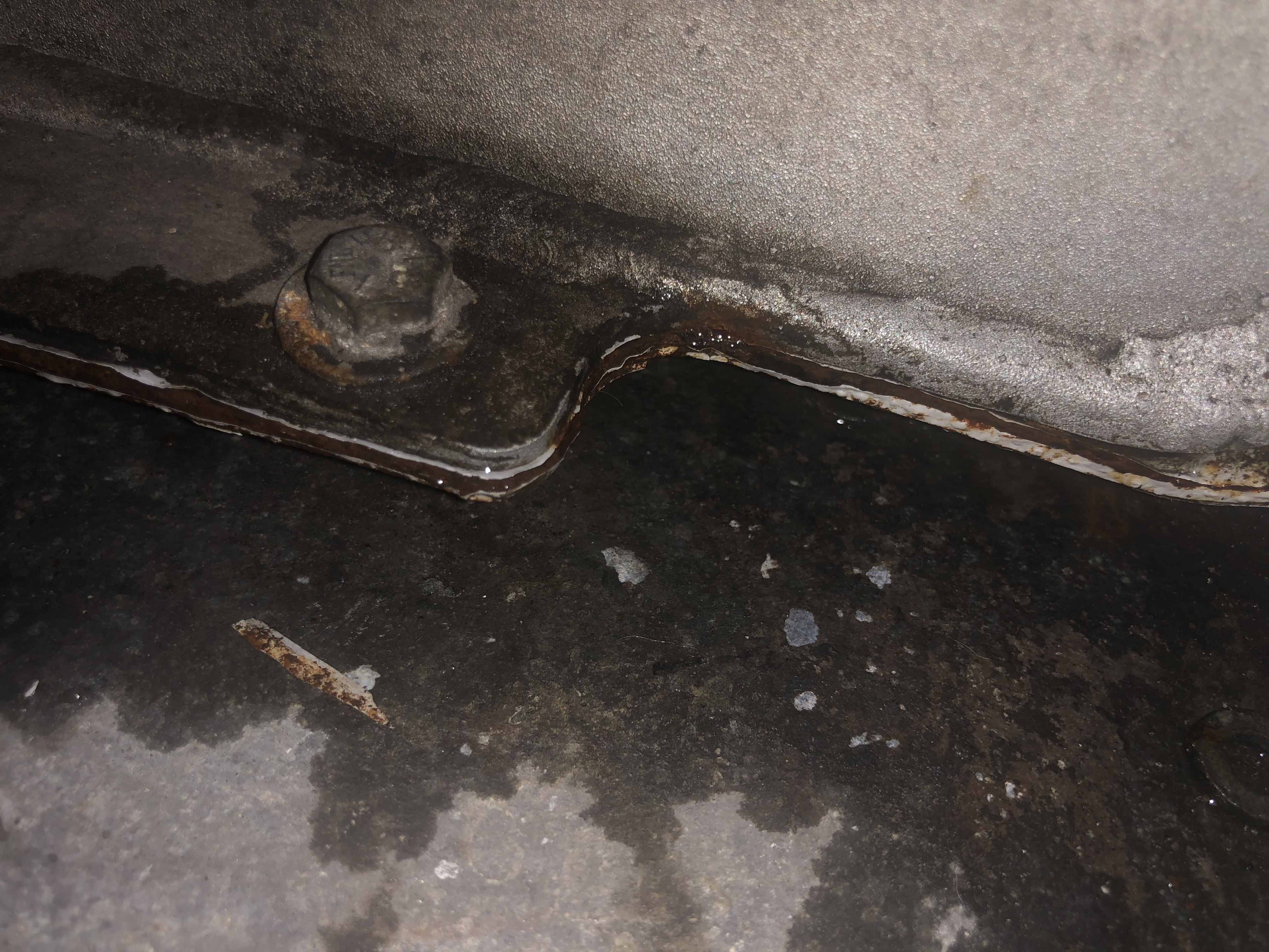

I have a 570 that seems to have a perpetual water leak coming from the bottom of the water box . I have a drip pan underneath that separates the machine from the wastetank so its definately not coming from there. I've checked the thermvalve and all related hoses. Thoughts?

I appreciate the reply, but its a significant amount of water. If I put my ear the left side of the heat exchanger, I can hear it hissing at the bottom when its pressurized. I have checked everything above and its dry. Question is if it is a leak, can you fix it by welding.

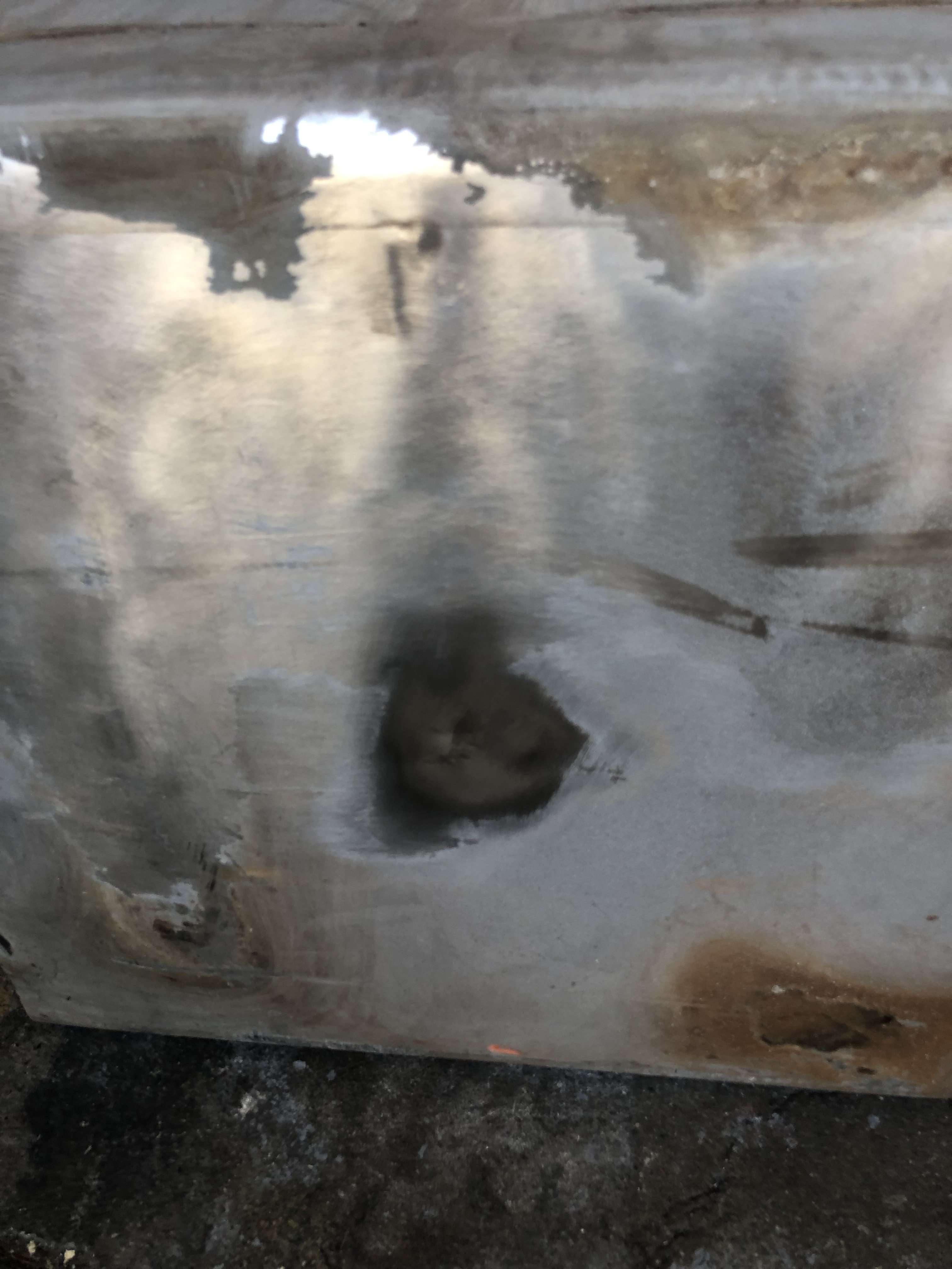

Bummer.
How old is the tank?
Stainless or aluminum?

Dude I bet a dollar JB weld will hold stuff is awesome lol
to much heat and thermal expansion JB weld will never hold....and when it does let loose..you will have to pull the entire machine out and go through this all over again....not to mention how weak and corroded it looks...your just asking for more problems...
someone should step up on this one...it should have never happened...

You can use a propane torch to melt it in. I've repaired a cracked engine block that way that was really bad.
But I agree it should be replaced. If it wasn't under warrantee that's what I would do.

"Someone" did step up at Legends and OK'd the parts and labor to fix this issue. They know that Tom is a long standing MB'r, a big SS supporter and a LEO to boot, so they did the right thing and took care of him.
But this Mitch dude, who Tom has bought three machines from, forced Tom to pay the difference in labors rates (what LB pays and what he charges) and for what he would have made off of selling Tom the box.
total douche move....
Had Tom come in two months earlier, it would have all been covered.
$950 * pounding...

Seriously Sapphire said they would pay for 3 hours labor on a seven hour job.
Tim worked late to get it done.
I don’t know, just cause your a distributor, your not going to eat labor based on a flawed design.
$900 was a lot cheaper then paying for the whole thing!
