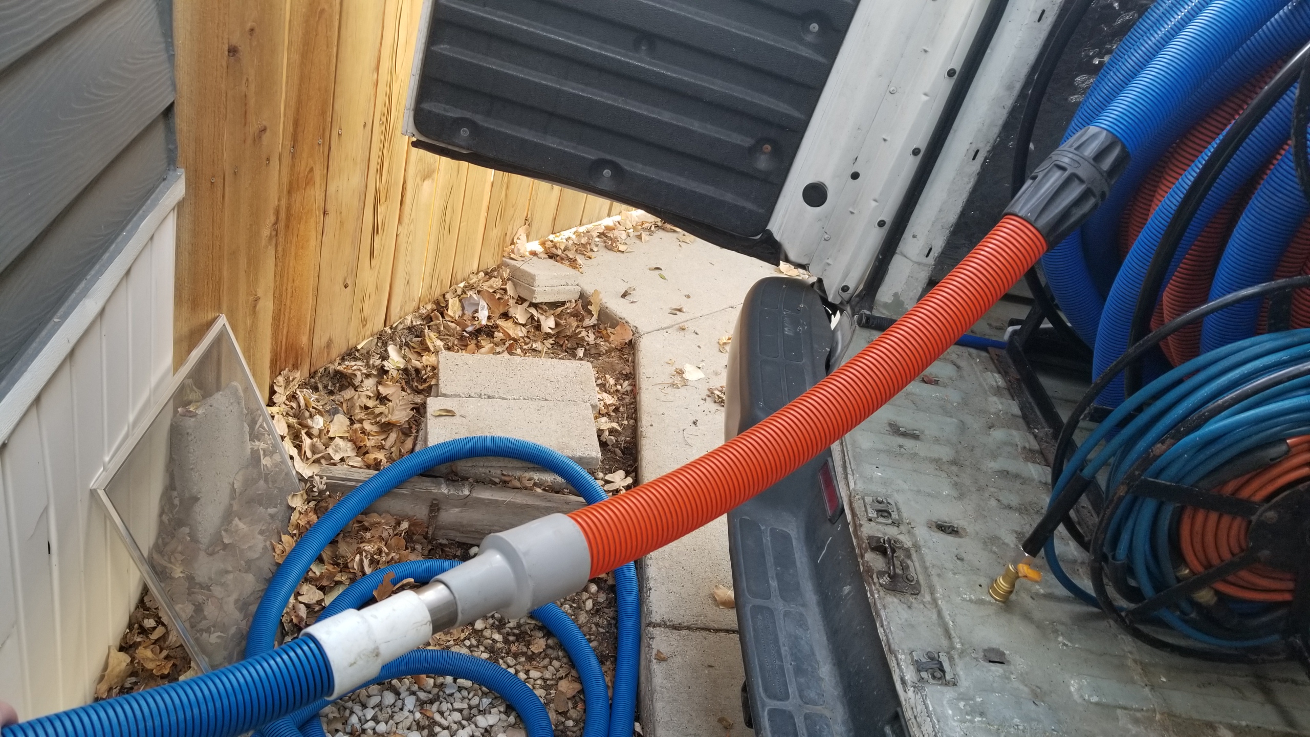

We did a job last year, and there was a resto company in the next building. He WAS running 1.5 all the way....IDK how long his run was, but I watched him peel off at least 100’...
I’m sure that carpeting was really dry by the time he finished...
I've seen it done twice. One guy bought it used that way and didn't know any better. The other was a moron and thought he had invented sliced bread. Told how loud his hose whistled now. 🥴

when running 1.5 wand, we always ran 2" all the way.

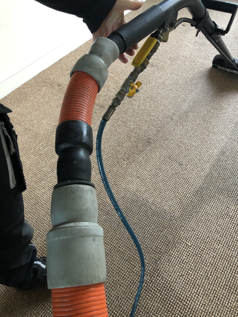

Those of you who run an 1.5" wand, do you prefer to use a whip hose or do you use a converter cuff and run 2" straight to the wand?
Hey Mike, Alejandro here, I just joined. I prefer the 1.5 inch whip hose. MY back does too! I have not noticed any real loss in suction. However its not like i have a gauge on my wand so i wouldnt know either way.

Every extra connector creates loss of suction, airflow and turbulence. I know one guy that has all of his hose in 25 ft increments so it's easier for his wife to carry.
Loss is minimal but i dont use all that. I rarely use the whip except for upholstery or stairs.
eeyeahbutt...
these "cutting edge" guys have gone from "open it up" with 2.5 ports and hoses, 2" wands and max tweaks on TMs to choking the chit out of the front end.

best reducer I've seen, 2" to 1.5" and remove the insert and it'll take a 1.5" whip
