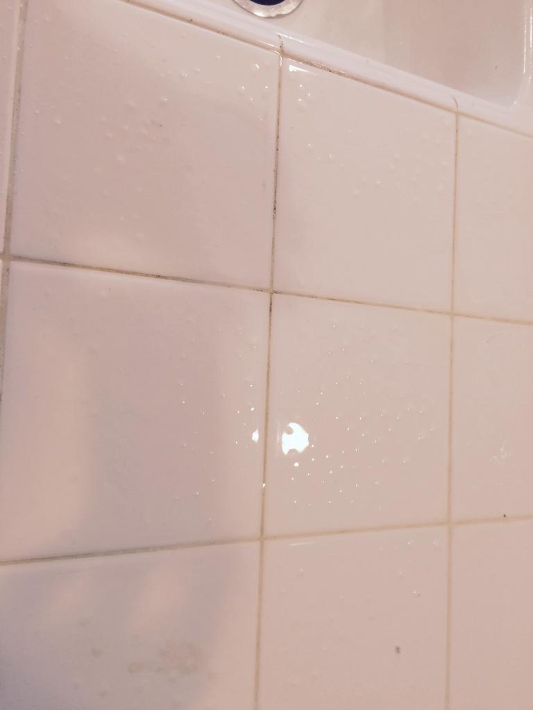

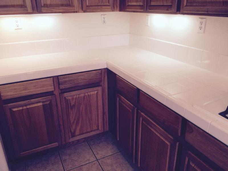

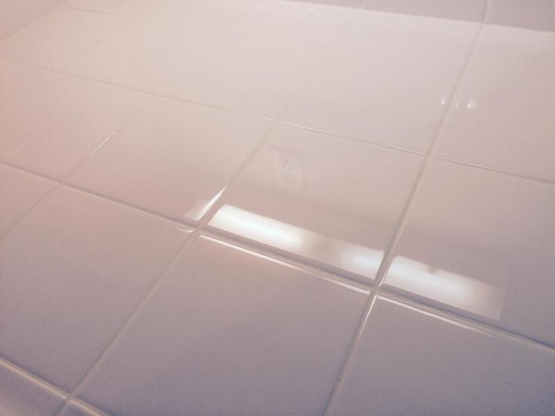

Oxy-Blaster and scrubbed with hand brush. After the countertops I cleaned the floor also scrubbing with Brush Pro.

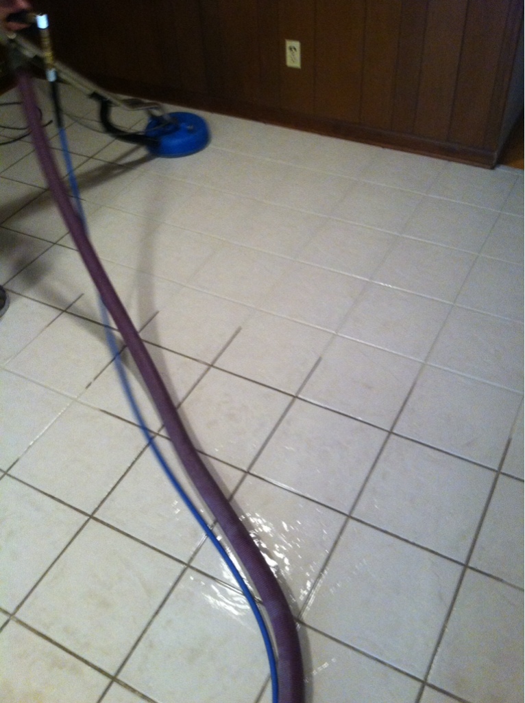

I can't think of the last time I've had to scrub a tile job. The one it did Friday had an 8th of an inch of black crud on the grout.
Hello Marty, what machine are you using these days? How hot does it get and what chems and dwell time are you using to get these miraculous results? Do you mix your chems with cold or hot water? What kind of sprayer? How do you get the edges? What tools or rotary do you use? Do you wipe up the edges kneeling or standing up? Air mover to dry or not? That's a start. Anyone else have a question for Marty?
49,918
We didn't scrub this one.
Reactions: Russ T.
Russ T.
Sep 26, 2008
3,556
Russ Terhaar
What pressure are you cleaning at Marty? My Cleanco tops out at 1000 psi.
49,918
I clean T&G at 800 psi. On that job up above, I used TCS's Max Ultra T&G Restorer. It's an acid cleaner. If I run into stone, I use Cobb's PowerMax, unless it's filthy. Then I use OxyBlaster.
