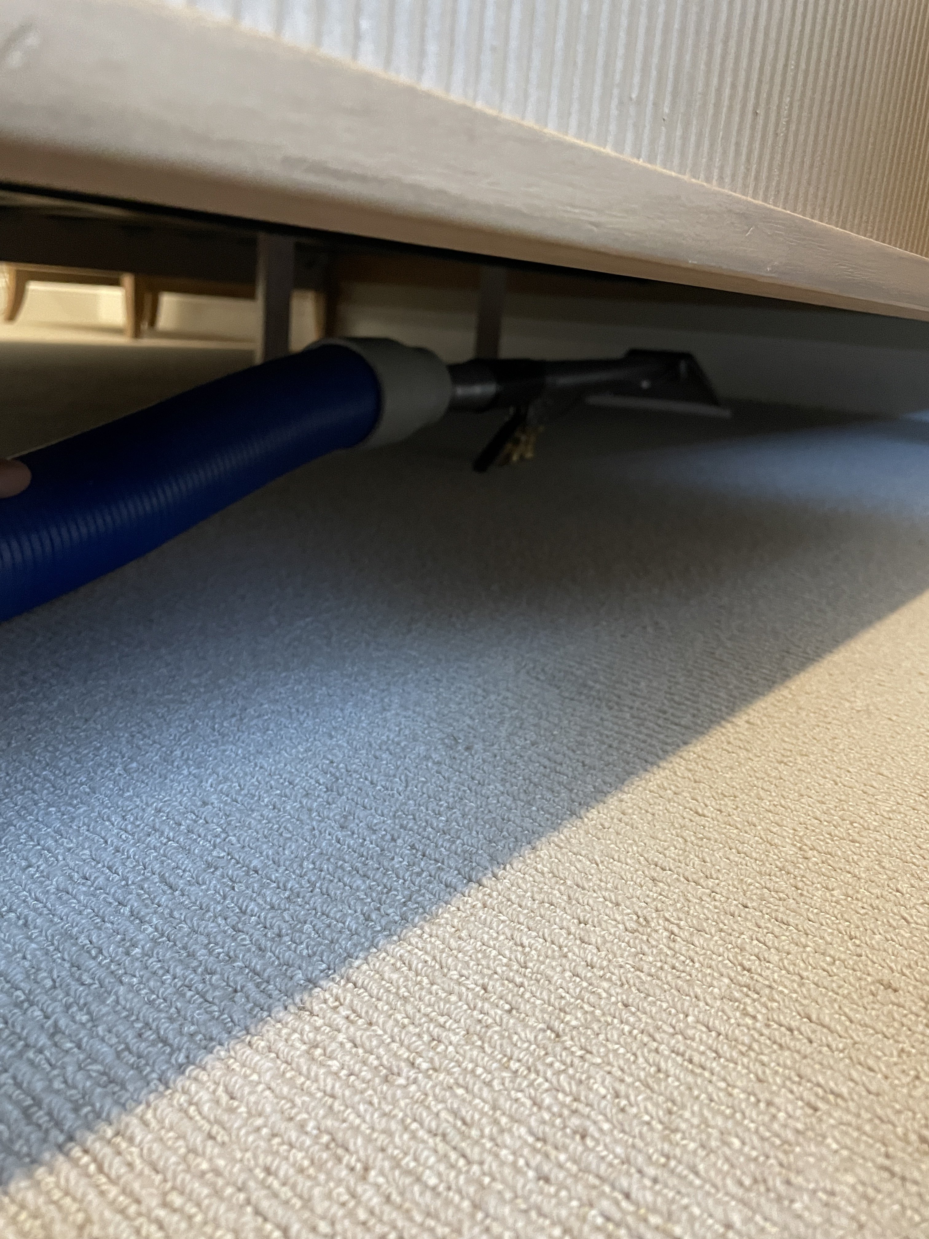

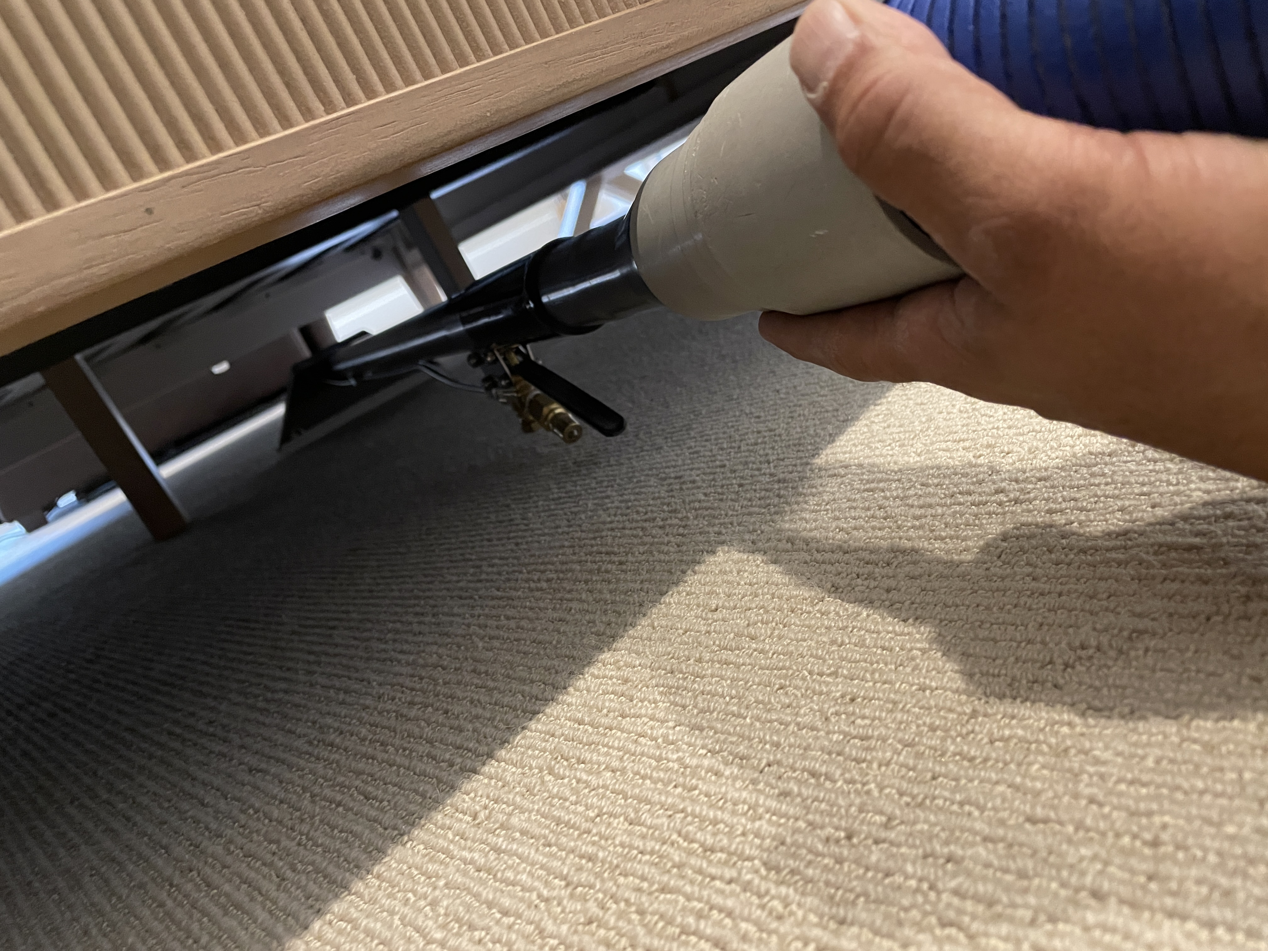

Bypass hands and knees, Im on my belly. From foot to head can get the whole king bed. Do it before prespray is better.

Or lift the mattress and box spring, clean between the frame, replace, and clean as usual….
THIS ISN’T ROCKET SCIENCE PEOPLE!!!
I lift, clean and replace if they are paying for it, or the bed is neatly made up with layers of blankets.
This wand is the best when working solo, and want to avoid dust flying when air movers in place. Probably make more in tips then if I was to charge. Takes a minute per bed, another minute to dust the nasty baseboards under there with microfiber mop.

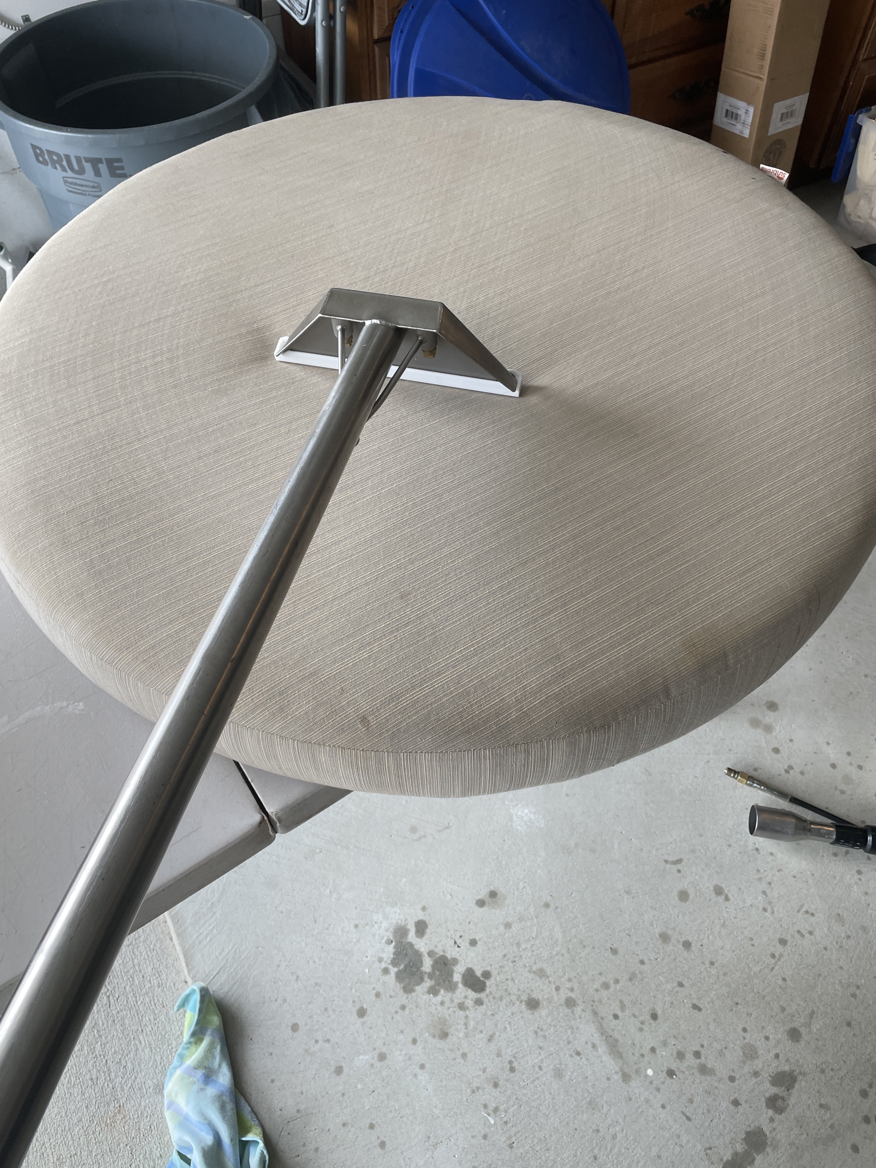

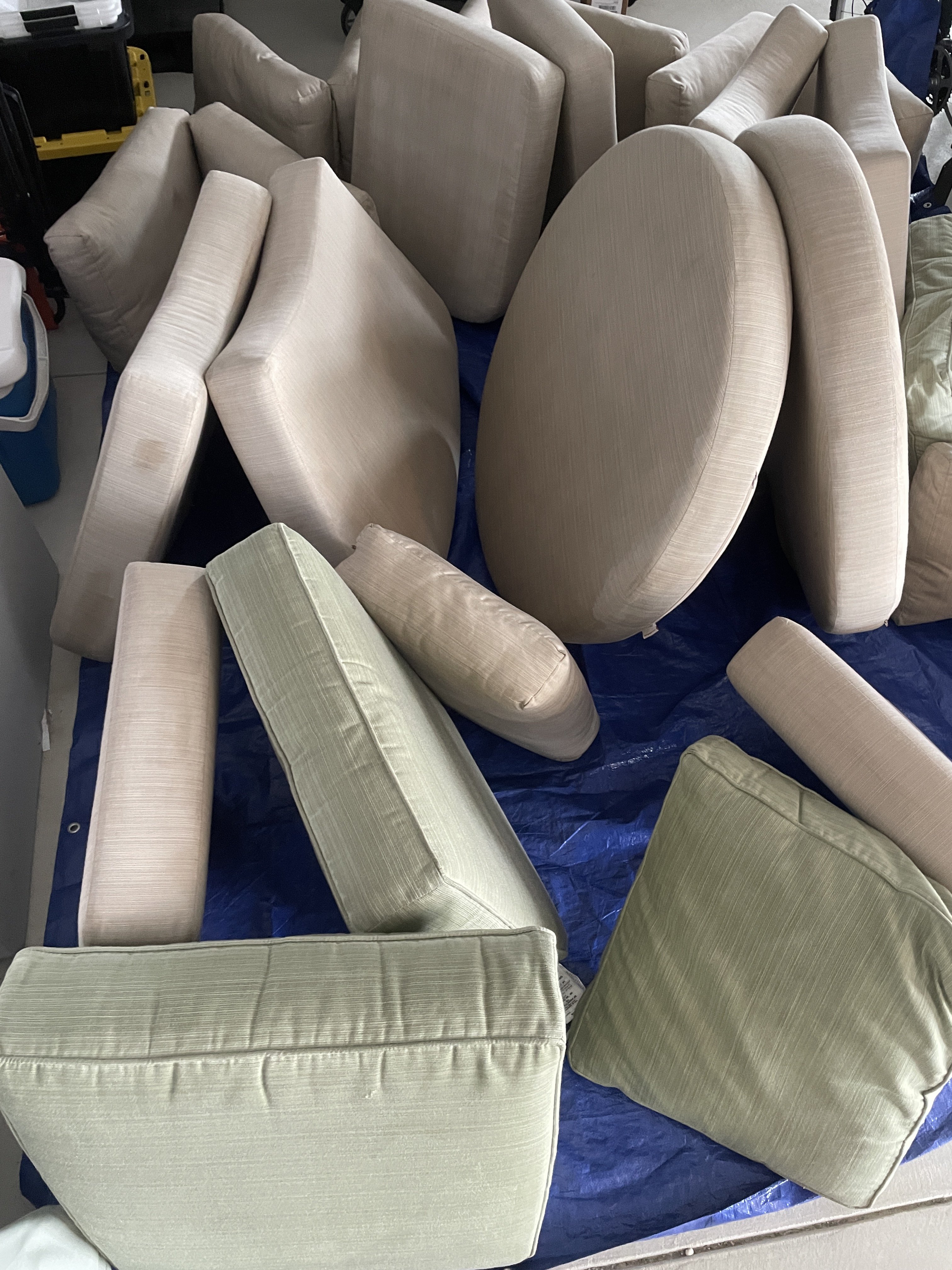

This is awesome. Hybrid Greeenglide,PMF 1530 on Sunbrella. Just got it, just saved me a couple hours.
Honestly got better results with more flow and vac.

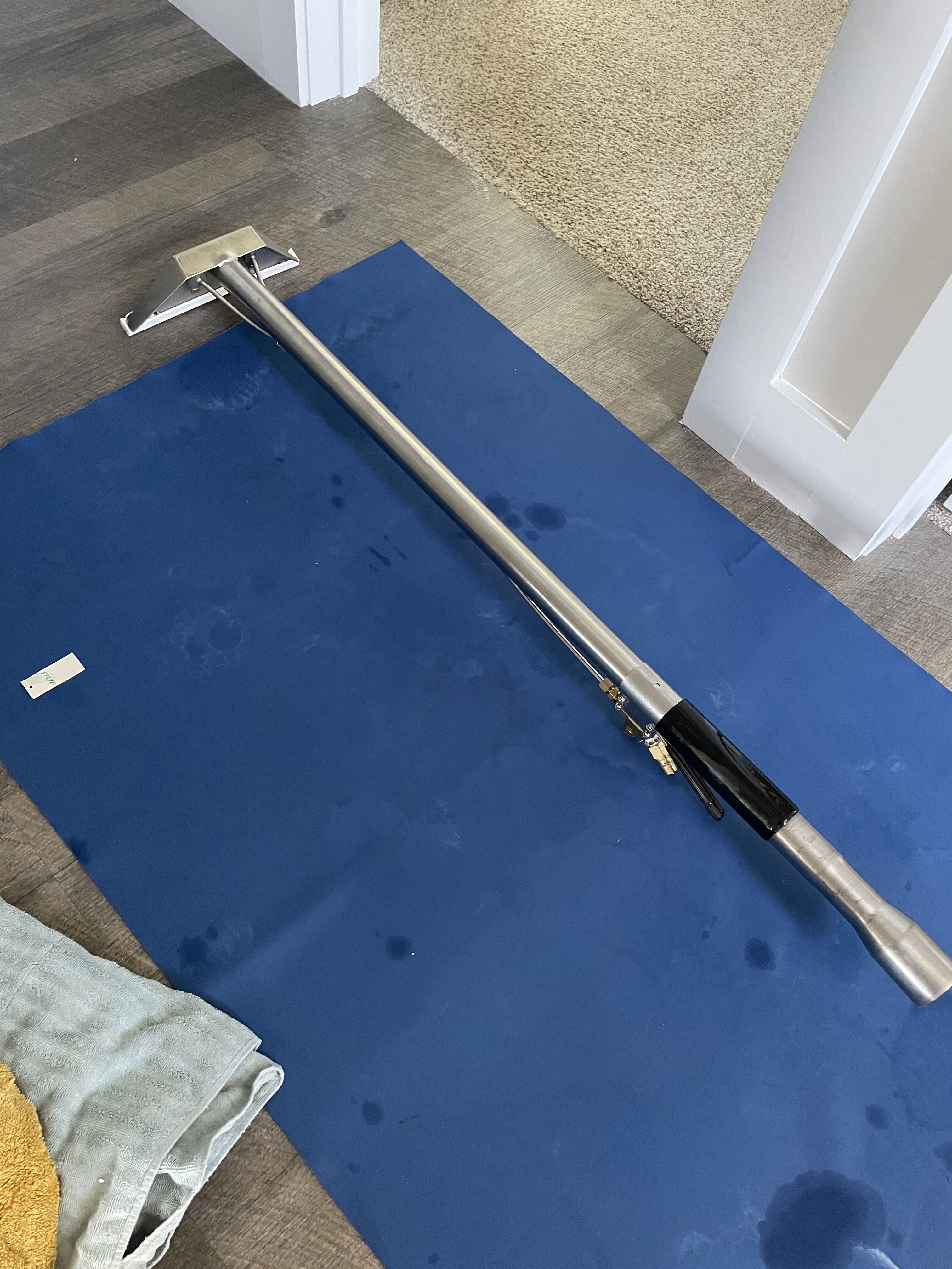

This is actually hard to post, but true. I am taking 2 PCQJ off the truck, and my new wand plumbed out by Greenglides with a glide, quality brass fittings and valve. Cant beat the price, but the kicker is the quality is there.
I actually really enjoyed cleaning every carpet so far with my new Wespak 530 customized by MikeyP @Greenglides.
I actually have 1 brand new Prochem (original) in bubble wrap. The wrap is coming off, and this PCQJ will actually be mounted on my wall. No use in selling it, because the right thing to do would be to get the Wespak 530, honestly. And I have a backup PCQJ in wrap too (just no decal, same wand).
All kinds of pro qualities. This may sound petty, but it fits under door stops way better. I encounter this at least 2o to 50 or more times a day. I am all about efficiency, about 23 years late to the party on this one. Drying times quicker, not using as much water, and my brand new full timer likes it. He will never know the PCQJ. That is so strange. It was my only carpet wand for my career. All good, just strange.
