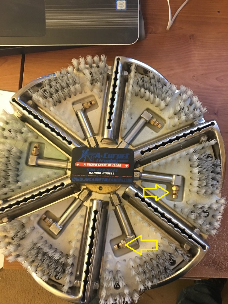

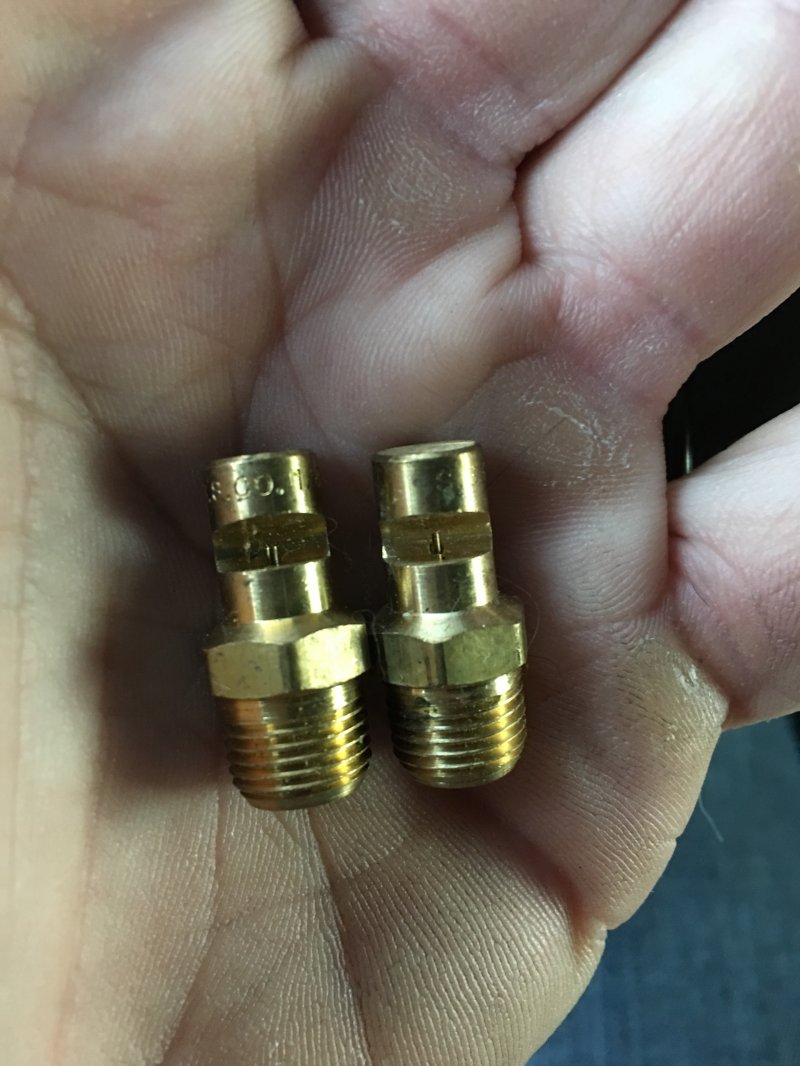

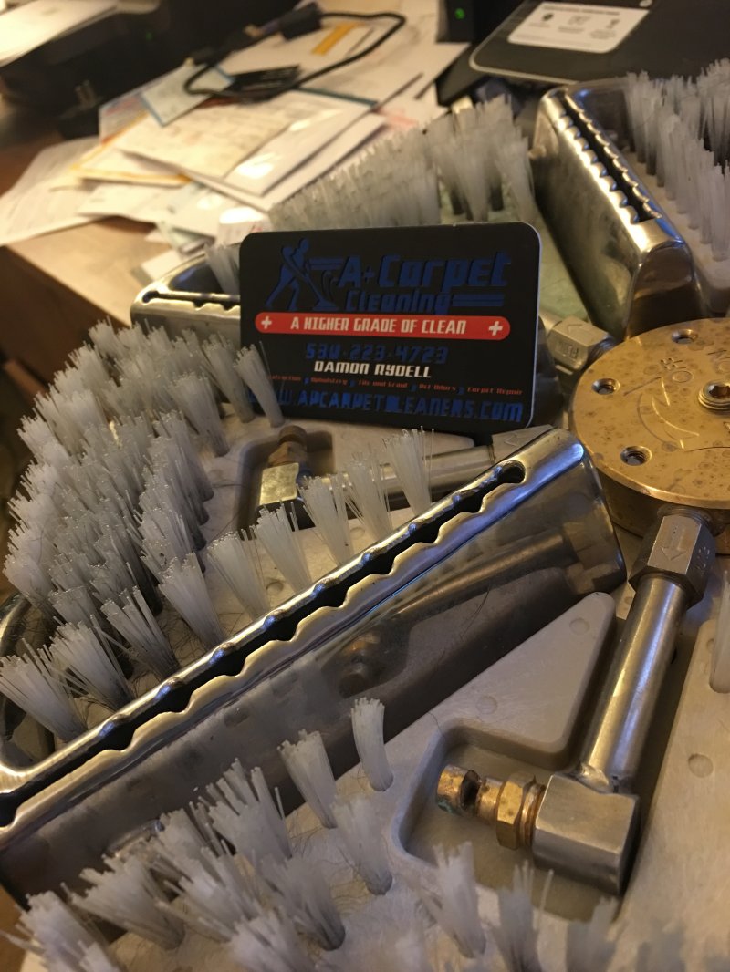

Have you noticed how some of your jets are blown open? is that by design or just cheap thin walled brass getting tortured by your 3000 /270º 870?
img_3509-jpg.68425
24,038
View attachment 68456[/QUOTE]
This is a new head sent to me. All the jets seem to be working fine and spraying evenly. But now I'm going to really have to look close. So far it's good. I do keep extra jets around just in case
img_3509-jpg.68425
24,038
My day just gets better and better. A rock cracked my new windshield on the way down form Shinglentown. :(. Having it fixed now.
On a happy note. The Trex head is doing great. The jets seem to be fine. On close inspection I am seeing some black residue around the spray holes and I think that is making them look blown out.

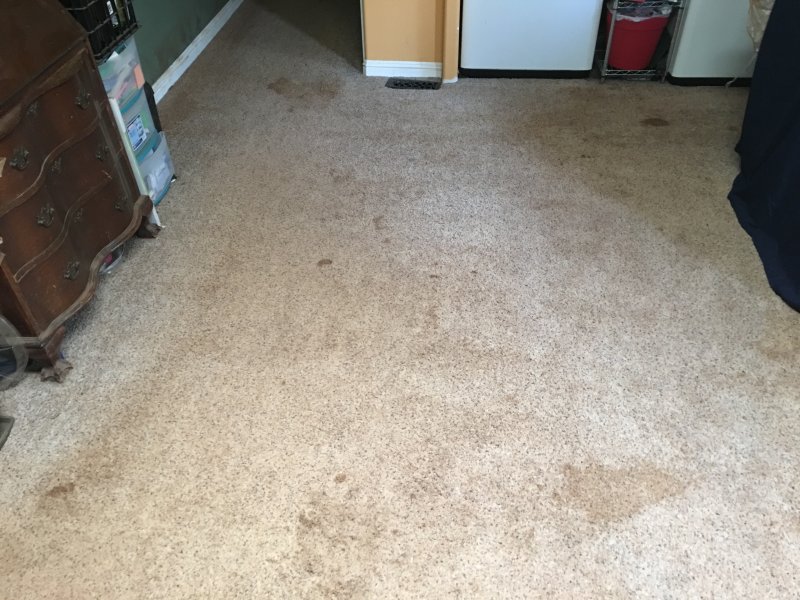

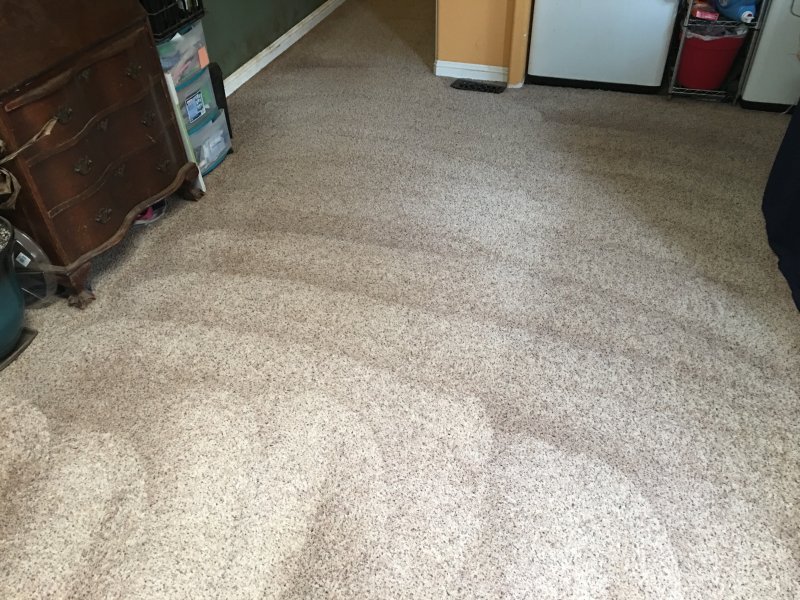

@Mark Saiger your sauce worked great on the red clay volcanic dirt of Northern California.

spray systems flood jets go a really long time before the hole wears larger, as compared to their fan products.

View attachment 68465 View attachment 68466 View attachment 68467
24,038

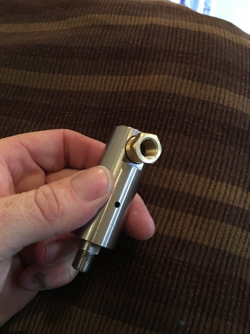

Ok. This is why my next big purchase will be a Mytee ECO-17 Orbital. I guess John LaBarbera saw my swivel leakage video and he sent me a new prototype swivel they are testing out. Thanks! It is truly appreciated and never expected.
