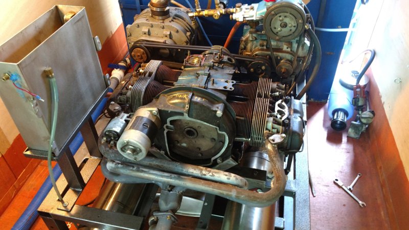

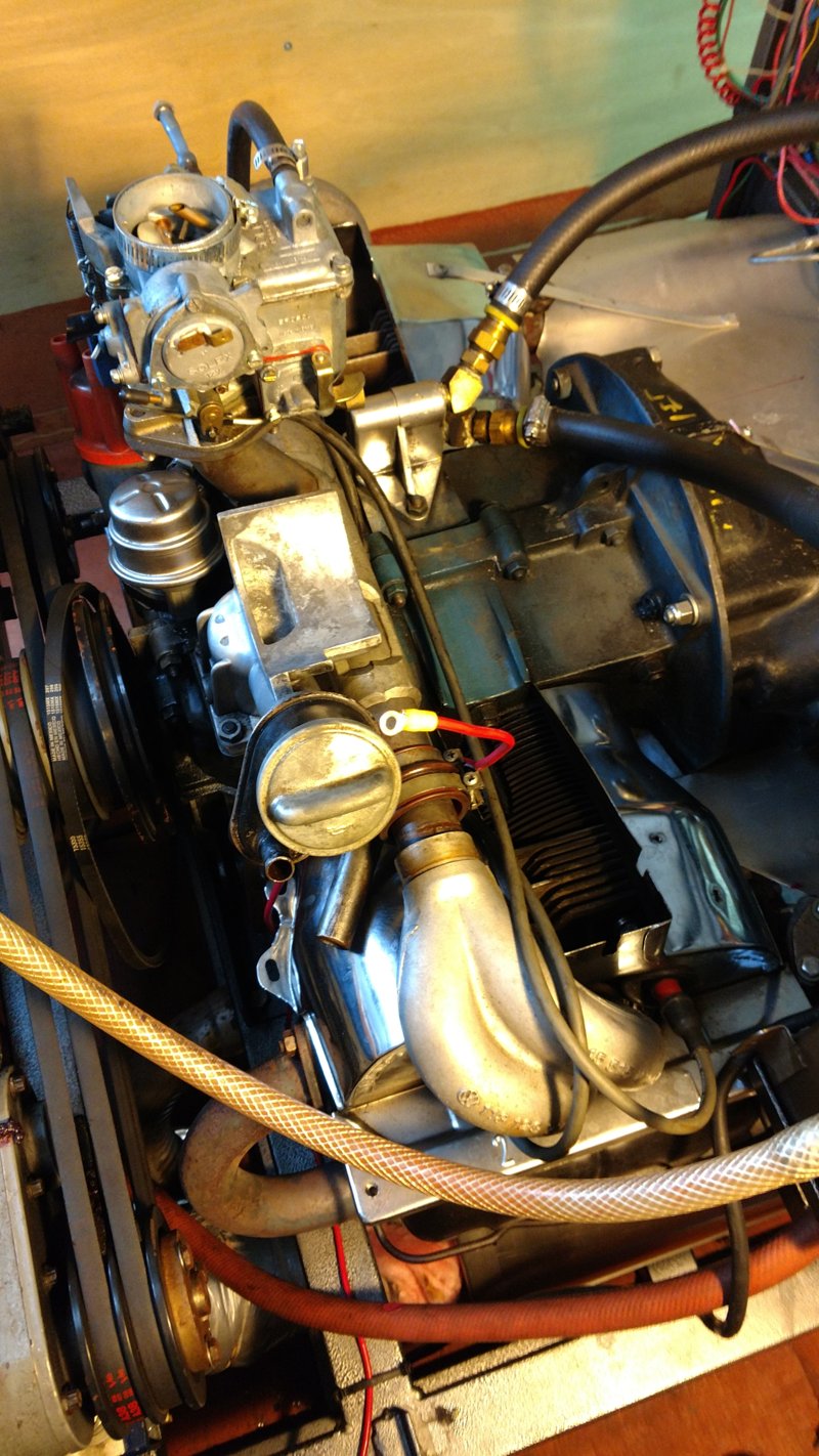

Well I got the old one out, new one in, forgot to take pics, I ran into a little hiccup I want to beef up the rear engine mount so I couldn't go get bolts today. The other way worked but I couldn't service oil pump with out removing the whole mount, so just a quick redesign. The cool thing is my whole front panel comes off with two bolts and two wires + n - to power all my gauges so I should be able to get it back together on a few evenings.

What I really want is two blower silencers like what Judson uses they are very compact short and round. It looks as though the blower ex inters into the center of them and exits out side??? I think Mike D used one on his steam punk TM. I could basically screw them right into the exit ports of my two blowers then gut my two Ss silencers and coil them for blower heat.

I also think I am going to get rid of all the header system, it is more for a performance car, if I can do this it will get rid of all the hot exhaust tubing that you see in one of the pics, it really creates a lot of heat and that is where the fresh air is coming into the fan, should cool it WAY down. Now that I have my Tig welder it should be a little easier to do

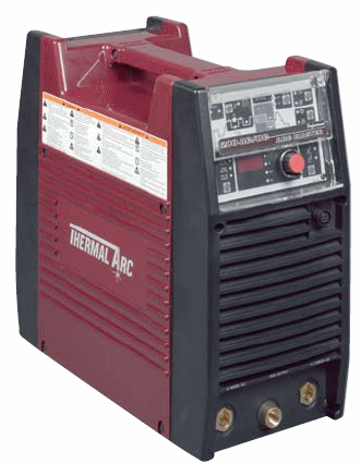

What kind of tig welder did you get? I recently got the itch to do it again so I picked up a thermal arc 161
Scott,
I actually bought a Eastwood Tig 200, It is not a huge tig welder, but I love it....I have never had one before, I did a bit of web research and watched a ton of videos amd most were really really happy with it. It can do aluminum also, It just runs on 110 so it is maxes out on 1/4 but I figured if I neded more than that I would just have to have the guys at Torr do it for me.
I have never welded so easily it take a little to get used to but the welds on finer parts is so FLIPPING awesome. For guys looking at there first machine I give it two thumbs up.
Super easy to set up, small, and under a 1000.00 bucks.....I bought this so I could get the wands done just so I could go to Mikeys Fest in Nashville, along with a Smitty Mill and Lathe combo.....two weeks before MF in Nash just to get these wands ready to go I think we spent @ $5500.00 total on tools to allow me to keep my promise to show up for Mikey and his fest....
BEST thing I have done in a long time. I know these are not for the hardcore guys but they helped me get what I needed to get them done...they both do awesome and super happy with both and more than enought to get the little things done I needed to get done.
