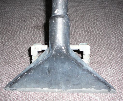

Jimmy;
Here you go:
It's a year old. Angle too sharp @ the edges for good airflow.
Where do you want to start the bidding at ???
Center Jet fixed, pretty much straight down.
At least our stainless wands don't have all the paint falling off.
Larry

What a poorly maintained wand obviously used by some HACK employee or doofus CC er down in TEXass.
I don't see any stainless steel glides on there Larry!
