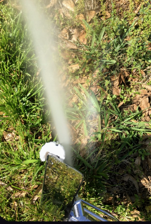

On another note concerning Matt's wand, the triangle shape, with its hidden/ surrounded jets is extremely handy for getting underneath all sorts of furniture and obstacles.
The old Bently almost pulled it off, but the jets were too far back, and soaked things.
117,256
