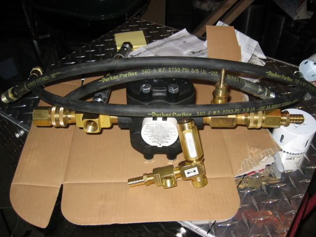

sorry a little bad lighting
l]http://www.youtube.com/watch?v=D2UNx01GmKsl]
amp draw only 9.6 per leg with all components running get equal power
nothing but the best hose and connects all custom
pump will do 500 psi at 2.2 gallons a minute
no pump teck porti pump
B
Bjorn
cfms 230+ lift 11 hg
with booster 330+ cfms
total amp draw is only 9.6 per leg
500 psi @ 2.2 gallons per minute

"So you have to run two power cords, then a 3rd if you want a booster to make it at least feel like a POS number 3 blowered Prochem Blazer. Then to top it off you need to burn a little Giant heater.?????"
Please tell me the advantage. There is a reason things like that do not sell well. I guess bleu line is knocking them dead ?
I have used this machine for over two years with only 15 minutes of down time. Maybe if bleu line could make something this reliable you would still have a job?
most hose runs that anyone cleans are around 100 to 150 feet booster is not needed but comes in handy I have run 300 feet with booster. I use the booster two or thee times a month ( big deal )
Takes no more time to set up than any-other truck mount
here is the big deal is the amp draw of my unit so you don't have the problem of blowing breakers this amp load is full with pump running flat out and is high as it gets.
Is this a SUPER SUCKER with one million cfms no it cleans carpet efficiently and cost effectively with savings in fuel over other gas only powered truck mounts.

OK bleu line was a bitter pill
this is not for every body neither is any-other machine it has advantages and draw backs nothing is perfect
what we have done is got over the total amp draw problem that most electric units have
this takes no more time to set up than a gas truck mount

90% of the jobs I do are 100 - 150 feet. How long can you run the cords? If you plugged one in on an outside plug, the other would go inside I assume?
How much propane do you go through with the heater?
B
Bjorn
propane use depends on how hot you like it I use a little giant #3 and on a busy week I might use up around 20 dollars worth
not too often I have to run more than 75 feet each of cord use #10 gauge cords roll up just like high pressure line on a reel
